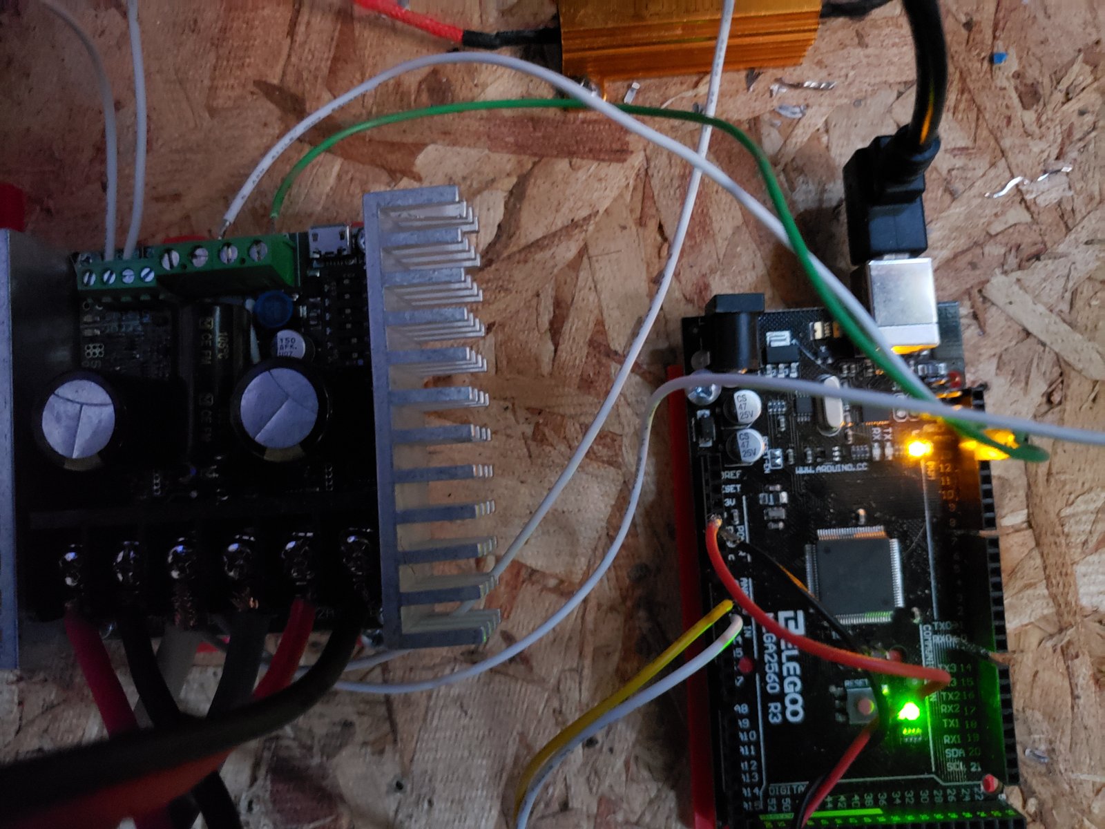

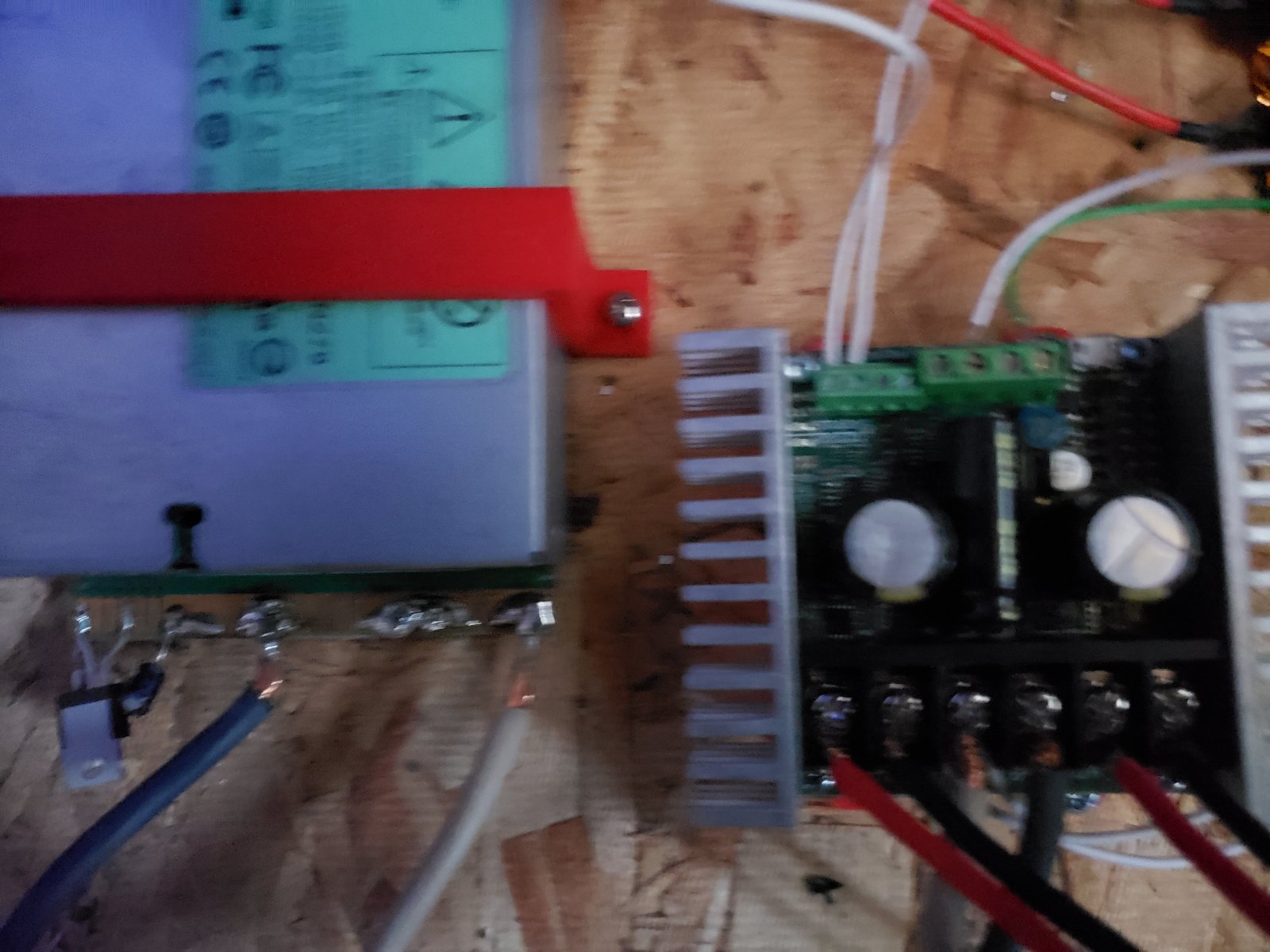

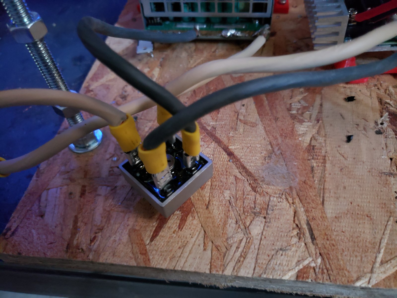

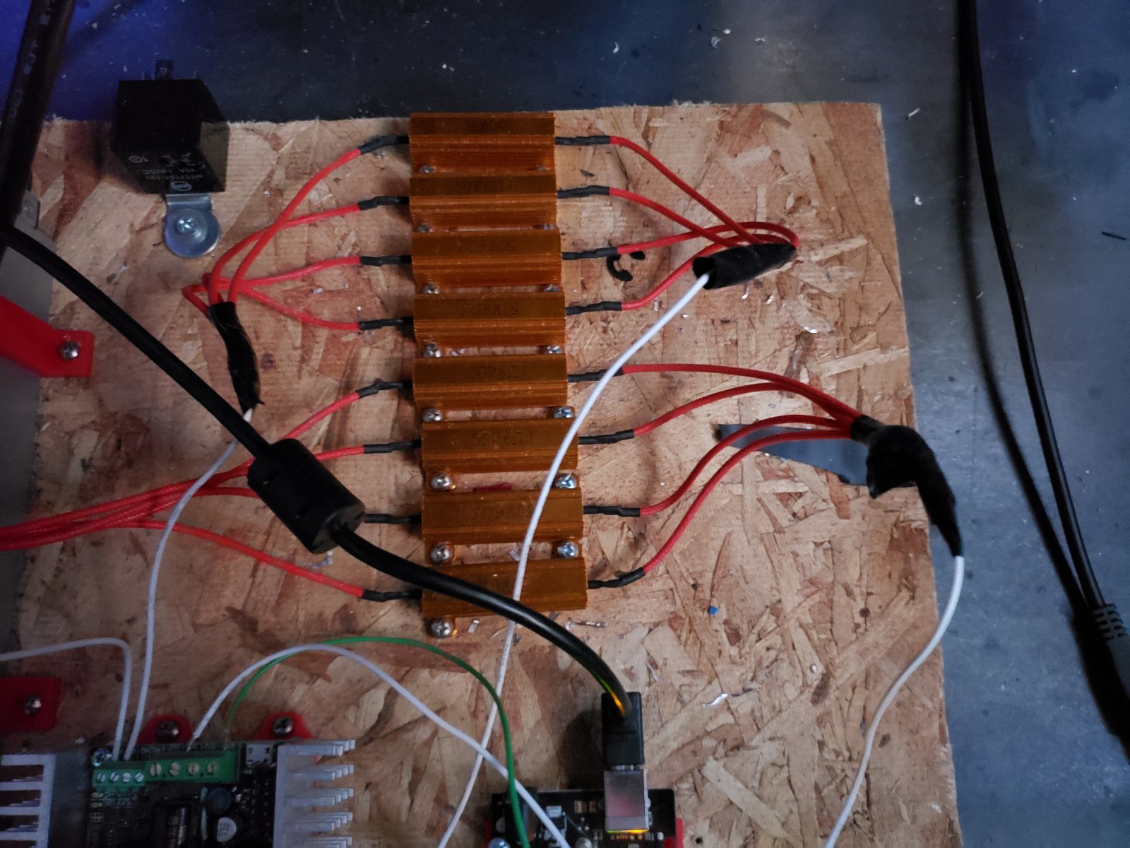

    I have attached some pictures of my electrical setup if anyone cares to look. Wiring is a mess because I was changing arduinos and checking wiring.
    I am starting to think there is a problem with my bridge rectifier/resistor combination. The resistors stay ice cold, the rectifier gets medium warm.

    The rectifier and resistor have nothing directly to do with each other. The rectifier gets warm because you are running current thru it so just like a wire it can and will heat up with enough current. The resistors may be cold because you have the voltage clamp value in Describe set on automatic. Try setting it to a value just above your power supply voltage and see if they start warming. If they still don't you may not be generating much back current.

    Edit: This didnt fix the issue, but it did get better. In frustration i rewired everything and ditched the rectifier/diode. It is now working 100 percent. I think i may have had a bad connection.
    You Sir are my savior. I set the voltage to 14, and just ran 25 or 30 solid minutes of hard racing. Used to be lucky to get 8 to 10. Resistors still run cold, and the rectifier is only luke warm but its working. Thank all of you for all of the help.
    Edit to add: I dont know if its really a rectifier, its more of a diode preventing electrical backflow to the PSU. Not much of an electrician, im more of a builder.
