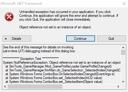

    Hey guys,
    turned on sim today and keep getting a net framework error. Was last using sim last night with zero issues at all and have never had this issue before, anyone know the cause?
    System.NullReferenceException: Object reference not set to an instance of an object.
    at SimTools_GameManager.Mod_GameProfileLoader.GameProfileChanged()
    at SimTools_GameManager.frmMain.cb_GameSelection_SelectedIndexChanged(Object sender, EventArgs e)
    at System.Windows.Forms.ComboBox.OnSelectedIndexChanged(EventArgs e)
    at System.Windows.Forms.ComboBox.set_SelectedIndex(Int32 value)
    at System.Windows.Forms.ComboBox.set_SelectedItem(Object value)
    at SimTools_GameManager.frmMain.tmr_IsGameRunning_Tick(Object sender, EventArgs e)
    at System.Windows.Forms.Timer.OnTick(EventArgs e)
    at System.Windows.Forms.Timer.TimerNativeWindow.WndProc(Message& m)

    ok to answer my own problem I fixed it. Somehow the default profile for project cars got corrupted or something so went to my users directory and deleted the profile, then started up game manager and selected pcars and it made a new one
