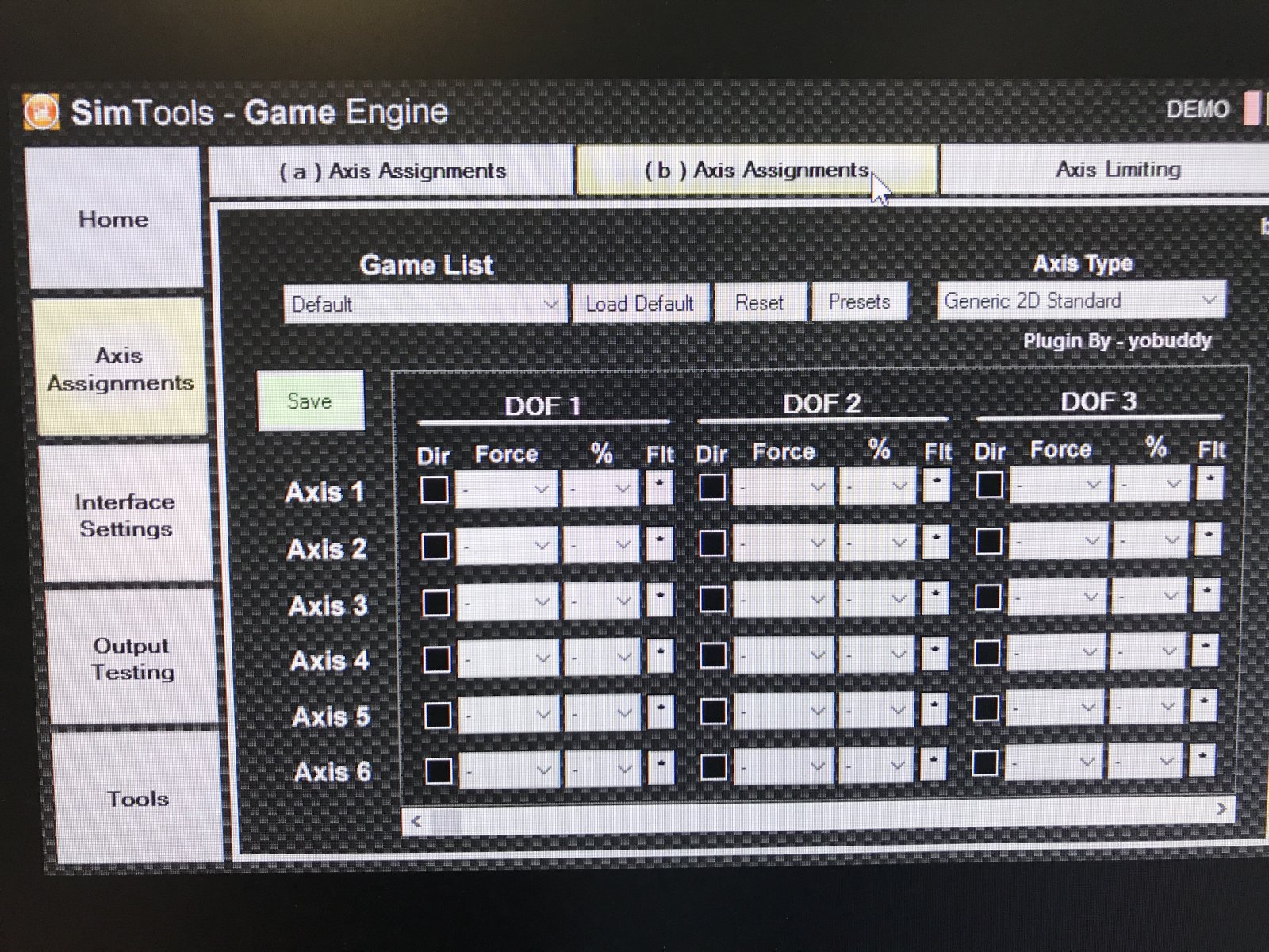

    While i wait for my hardware and MM to arrive, I am working on the scale RC version of a 2DOF from @eaorobbie I believe. I am having trouble making the servo's move in game and I am struggling to fill the empty voids of understanding in my head. I am finding it a little difficult as I havent done this before and the screenshots from different pages are of older software and differ a little.
    Problem - servo's do not respond in game or via SimTools testing
    Factors:
    • I am using an Arduino, two RC servos and Live For Speed.
    • I am trying to follow these two threads
    • I have loaded the Arduino with the RCModelSimToolsMode.ino - no errors
    • I am not sure where or how to install the RC Model Test_InterfaceConfig.cfg file as the description in eaorobbie's page don't match
    • I get no response from servos when using the Output Testing > Axis Testing APART FROM when turning on Axis Testing, one of the servos centers and the other does nothing.
    • Using the quick start link above, I can prove the game and simtools are talking as when i use the "Virtual Axis" page, I am getting feedback from LFS.
    • When launching the game, again, one of the servos centers but doesn't move after that.
    NOTE - I am using an Arduino Nano for testing but it has the same chipset as the Arduino UNO so dont see that being the issue.
    Please be kind.
    21,293
    149,427Coins
    +10,945 / 54 / -2
    The difference from SimTools 1.3 to SimTools 2.0 in setup is that instead of axis defined like this <Axis1> it is now like this to designate grouping for a or b: <Axis1a>

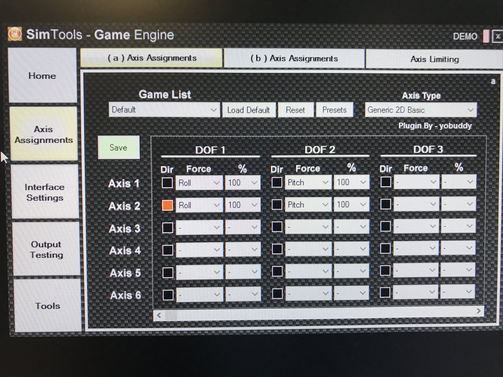

    And in follow on from that, when i move the sliders for the axis tester, my servo's are only moving in a range of about 15 digits (for example -50 to -65). Is this what should be expected or should i see movement from closer to 1 to 100?
    21,293
    149,427Coins
    +10,945 / 54 / -2
    Try an Output Rate of 10.
    The movement when using Output Testing that you describe seems odd, perhaps post a video showing it and all settings.

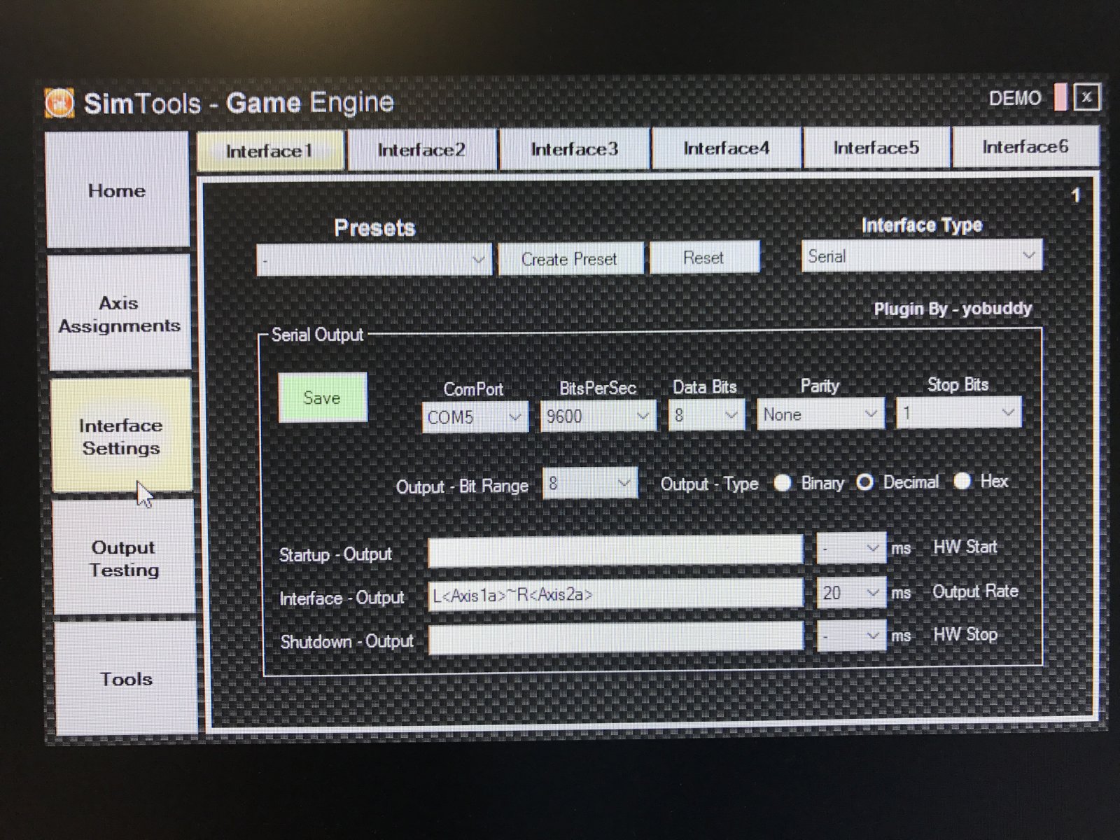

    in interface settings you need to choose decimal in output-type
    and interface output should be A<Axis1a>~ B<Axis2a>

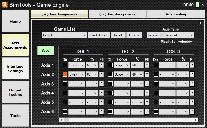

    This help thread helped me out a bit thanks to @insanegr
    Here are my settings and what is happening. Its the same servo that is fluctuating so Im wondering if its the servo that is the problem but I dont have another one to test with.
    Also @insanegr, the shudder and response from your model video on rFactor is incredible!!!

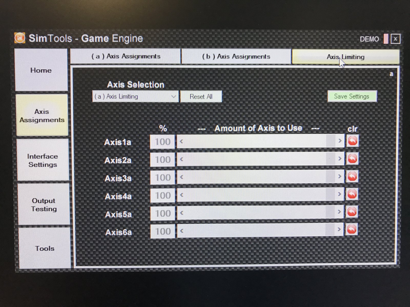

    The total axis allocation for all axis combined should be around 100%, not 100% for each axis, try is at 50% and see if that helps.

    @James Robbie you need a space between both axis in interface-output A<Axis1a>~ B<Axis2a>
    and 10ms for output-rate. give it a try and i believe you will have proper motion. if not swap servos to see if it still happens to the same side or servo.

    So... I have finally had SUCCESS!!! With what you have said here @insanegr, it got my mind thinking and my fingers tinkering. I tried swaping servo's, problem stayed on same side of seat/opposite servo. Changed the cables between the arduino and the servo cables, problem still present. Adjusted the output format from "L<Axis1a>~ R<Axis2a>" to "R<Axis1a>~ L<Axis2a>", problem swapped sides which got me thinking so -
    Format with problem: "L<Axis1a>~ R<Axis2a>"
    WORKING FORMAT: "~ L<Axis1a>~ R<Axis2a>"
    I needed the "~ " at the start

    @James Robbie i see i have made a mistake in the copy paste for the settings:oops:. sorry about that. picture was right in the previous post although.
    try this R<Axis1a>~ L<Axis2a>~
