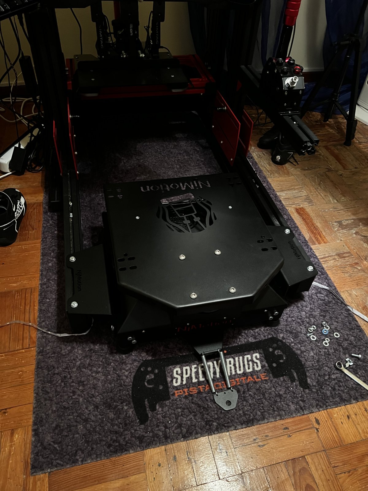

    If it is sold as a 2DOF then it is a 2DOF, but you can always post a picture of the rig to be sure.
  5. Tiago Dias
    Tiago Dias New Member
    Jan 14, 2023
    11
    89Coins
    It's this one, Nj motioncompact-r
    21,030
    147,878Coins
    +10,880 / 54 / -2
    Yes that looks to be 2DOF, so you just need: [A<Axis1a>][B<Axis2a>]

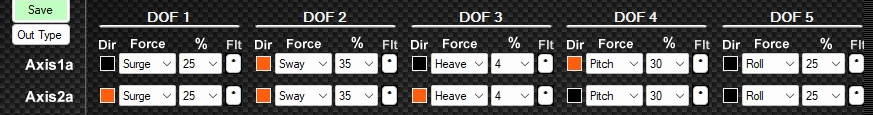

    something confusing, because the manufacturer sent me these configs, I'll have to talk to him
    21,030
    147,878Coins
    +10,880 / 54 / -2
    Specifically what did the manufacture send you for all settings?

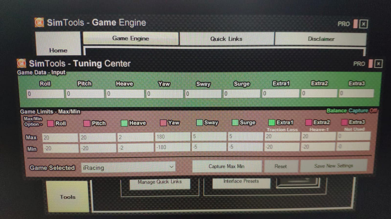

    exactly this screen that I left in the last post and the following video that I leave there to configure in the new simtools program, and from what I saw in a review of a very well known streamer dan suzuki he has the same motion as me and I followed his settings but will it be that is he wrong too?
    21,030
    147,878Coins
    +10,880 / 54 / -2
    OK, the video shows SimTools v3 Beta with manufacturer repo, which is different from SimTools v2, particularly with respect to plugins being incompatible.
    The SimTools v3 Beta thread is here, which includes the SimTools v3 download link plus other information, including feedback from public testing: https://www.xsimulator.net/community/threads/simtools-v3-public-beta.17329/
    Did the manufacturer not give you a SimTools v3 link and information about their manufacturer plugin repo, which may be different from the general SimTools v3 repo?

    Hi, I have the same motion system as Tiago. The config files included with it only had sway and surge.
    I´d like to know if expecting to configure surge/sway and pitch/roll all in a 2dof motion is asking too much for only 2 axes. I guess it should be somehow done by limiting each force´s priority well.
    I´m asking because I tried it following the simtool manual and the configure min/max tutorial and failed.
  13. noorbeast
    21,030
    147,878Coins
    +10,880 / 54 / -2
    It is normal practice with a 2DOF to configure surge, sway, roll, pitch and heave. Surge and heave are simulated, but SimTools mixes them on the fly and it does a pretty good job with those simulated axis.
    The Tuning Tips in the FAQs should be helpful: https://www.xsimulator.net/community/faq/steps-to-create-a-motion-profile.228/
    You can also post pictures of all of your settings so member's can then offer suggestions.

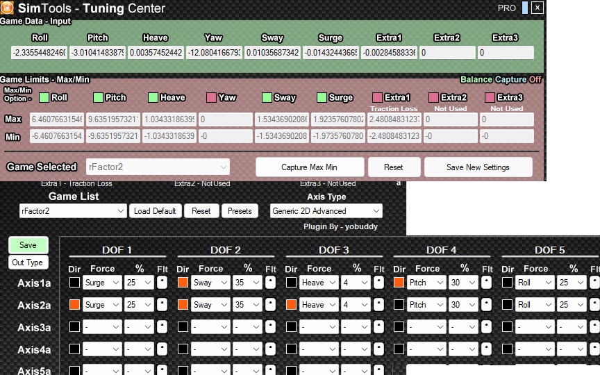

    Thanks for the reply @noorbeast , glad to know it´s only because of my own incompetence and that a decent motion experience can be achieved with only 2 axis.
    These are the settings I´m having after (I think) following the steps to configure SimTools:
  15. noorbeast
    21,030
    147,878Coins
    +10,880 / 54 / -2
    So how does it feel with these settings?

    With openwheelers I only miss a little bit of more sway, but with tintops the overall sensation is that it's too static, if it makes any sense. I thought it was caused because of 'clipping' maybe?
  17. noorbeast
    21,030
    147,878Coins
    +10,880 / 54 / -2
    As per the FAQ motion profile setting tips you should initially refine the motion profile on a mid range car, then when you have it really nailed down make variations for specific cars\tracks in Game Manager profiles.
    What are you current axis allocations?

    My axis are these:
    I used to capture the max/min from a BMW M2 which I´d think as a mid range car. Would it make sense to have different max/min profiles for each car or at least type of car? Apart from the game manager editor profile where I give each force a different adjust.
    I experience a very different motion from one car to another. I´m not talking about the differences each car naturally has, but some cars just move like crazy as if heave was too sensitive to the road surface, making the overall motion little sense.
    Edit: If it makes any difference I´m using rFactor 2.
  19. noorbeast
    21,030
    147,878Coins
    +10,880 / 54 / -2
    To quote myself from the FAQ tuning tips: https://www.xsimulator.net/community/faq/steps-to-create-a-motion-profile.228/
    When you are satisfied with the generic motion profile you created then you can refine it even further by creating specific car/track profiles in the Profile Editor, located in the SimTools Game Manager. Copy the Default Profile in Profile Editor under the Editor tab, name the copy by the Car/Track then use the sliders in the Editor to further tweak the settings.
    You can change the Main Level % for different Game Manager profiles, this applies smoothing to All of the data coming from the game. (its how it adjusts the strength if you will). When this value is at 100 %, it uses no smoothing at all, and you are riding the direct data supplied from the game. As you lower the Main Level % value you are applying smoothing to all inputs from the game plugin: https://www.xsimulator.net/community/threads/simtools-v2-3-is-out.12483/#post-163173

    Thanks for the tips. I already have the output at 90%, but I think that was the issue. When I lowered it to 80 it started to make sense again. From there i´ll fine tune as you recommended me.
    There is hope for my motion, thanks a lot for your help :thumbs
