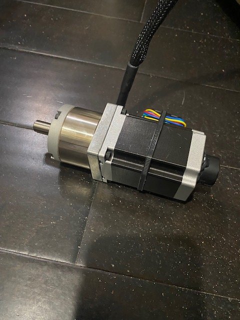

    I'll take a look at this further this weekend. on a different note, looking at the motors for this they look nothing like the SCN type stepper. the encoder on the back is round and there is a gearbox on the front. i'm wondering if these might be a different Motor for the Gbelt instead and maybe that's my problem. Have you heard of SimXperience only using SCN or is there a possibility for a then to have used a different motor?
    20,914
    147,200Coins
    +10,858 / 54 / -2
    Can you please post pictures.

    here is a picture of the stepper
