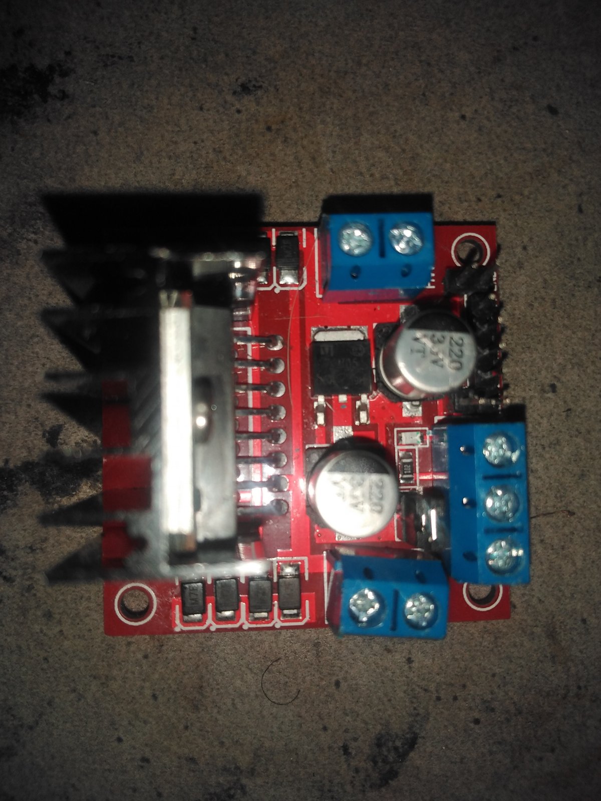

    Hey could somebody please help
    I'm struggling to wire my dual H board) 2dof)
    With pot and uno R3 arduino.
    Is there maybe Sim tools arduino code specifically for attached board.
    And also a wiring diagram please
    Thanks in advance.

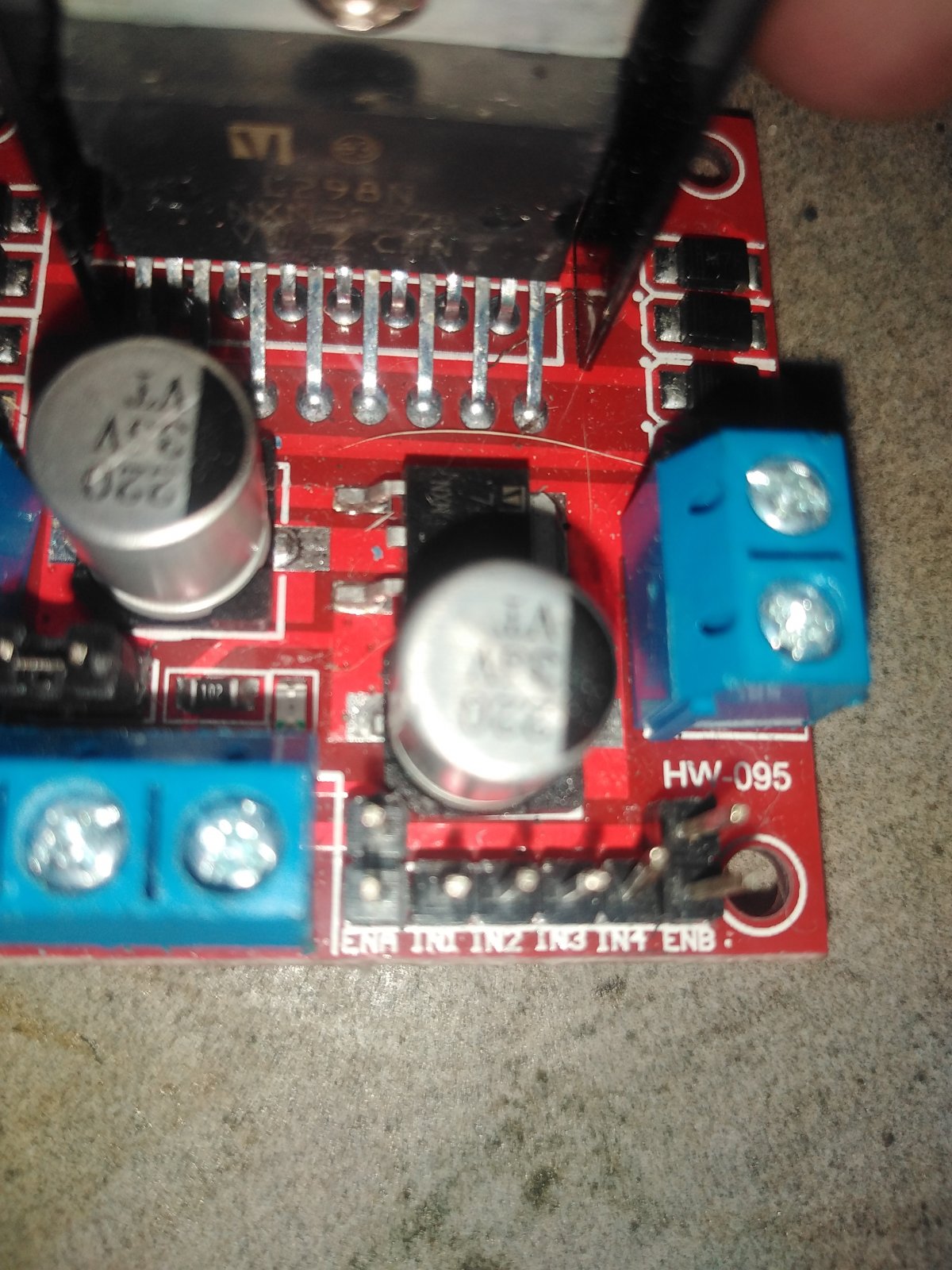

    Hey Lesley, I don’t recognize that board but maybe others do. It always helps if you include model/part numbers/manufacture (if known), etc.

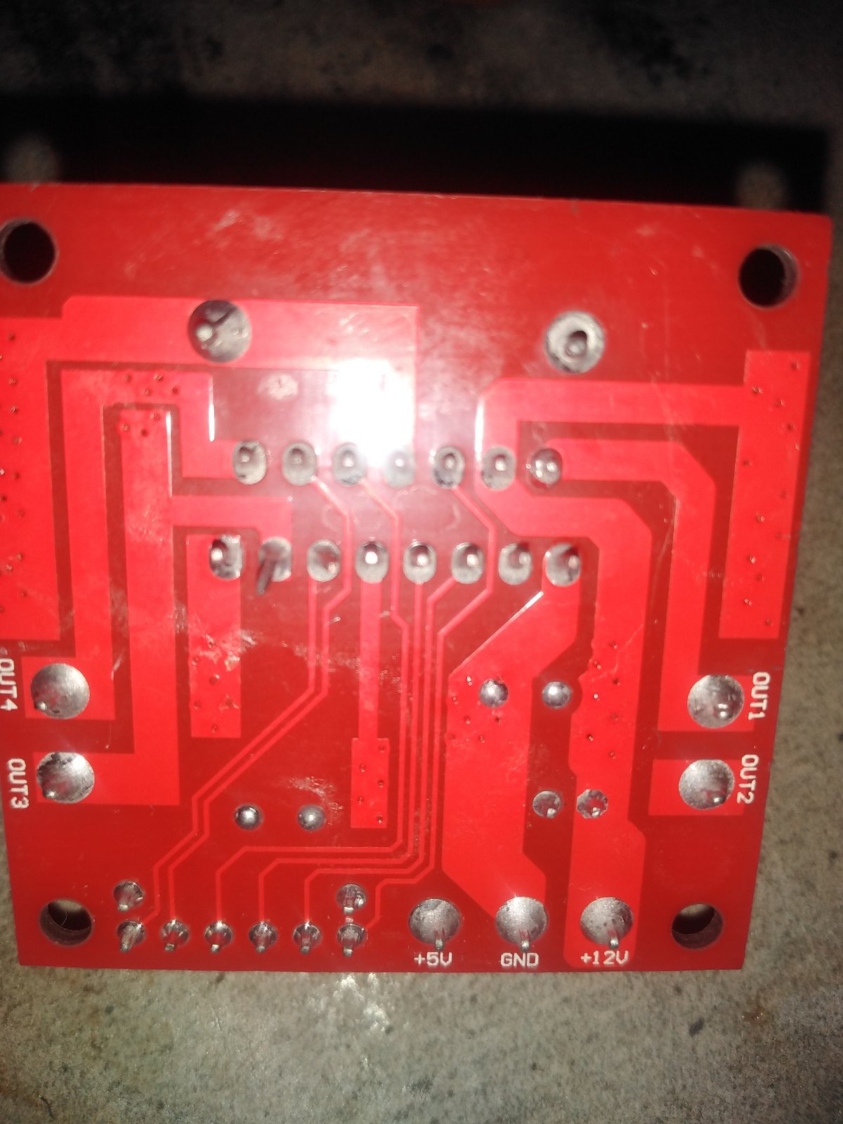

    The “out” terminals look like they go to your motors. The 5v, 12v, and gnd are pretty straightforward, too. But the digital signals are more of a puzzle. You may need to get the h-bridge component part numbers and manufacturer data sheet, and trace connections on your board, to sort the digital lines if there isn’t a datasheet for the whole circuit board.

    L298N Module Pin Configuration:
    Pin Name - Description
    IN1 & IN2 - Motor A input pins. Used to control the spinning direction of Motor A
    IN3 & IN4 - Motor B input pins. Used to control the spinning direction of Motor B
    ENA - Enables PWM signal for Motor A
    ENB - Enables PWM signal for Motor B
    OUT1 & OUT2 - Output pins of Motor A
    OUT3 & OUT4 - Output pins of Motor B
    12V - 12V input from DC power Source
    5V - Supplies power for the switching logic circuitry inside L298N IC
    GND - Ground pin
    Something like that?
    Maybe somebody can create a wiring diagram?
    I can send feedback on how it feels on a 2dof sim rig.

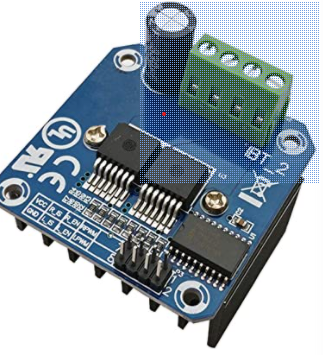

    Ami, the IBT-2 have given me good results, I recommend them
