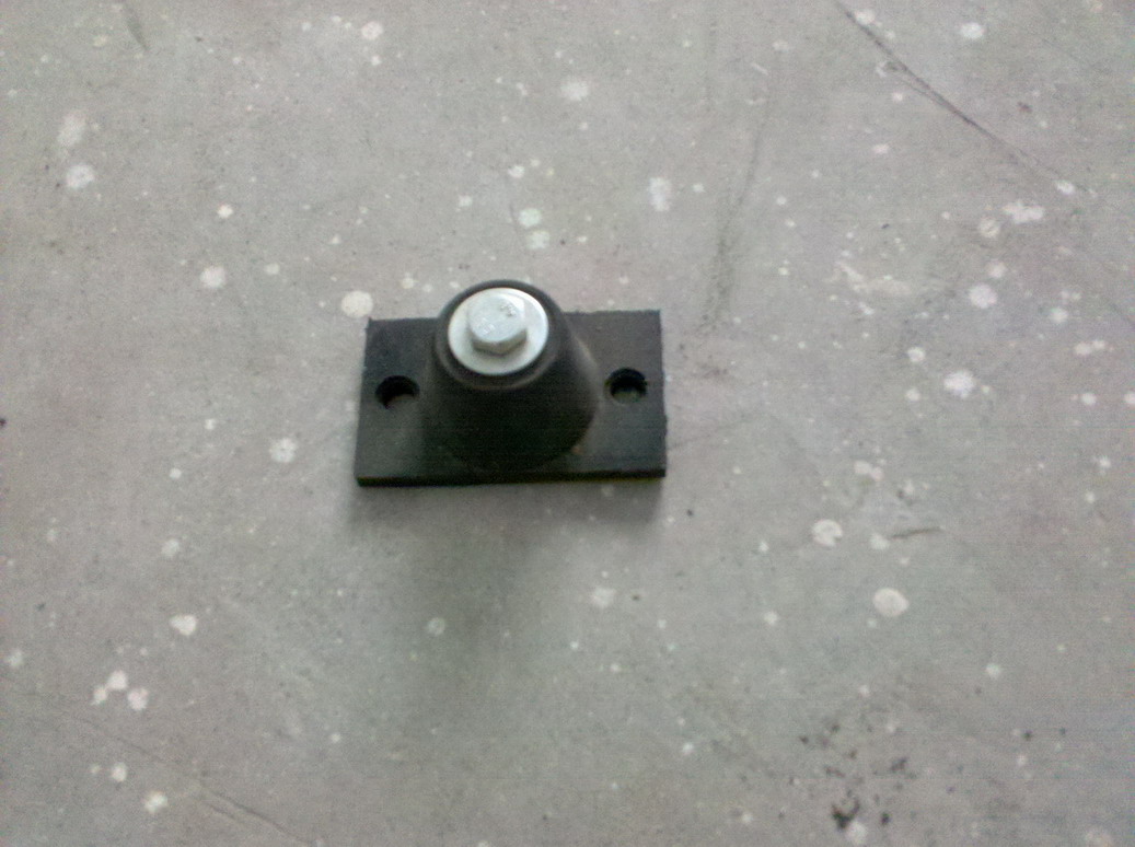

    i have buy something:

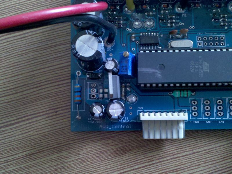

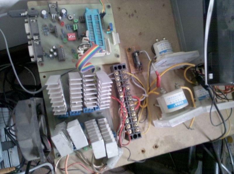

    Tronic's AMC motor motion-controller is very great job.His project give me more help.
    Make it need more passion and very careful.But the PCB what i made is not stably.many time,it almost blow me up.
    Luckly,i meet a friend who work in elctronic company several month ago.I told him my project ,and ask him for help.
    He promise will redesign the PCB base on Tronic's.
    He will sent me the PCB the end of March if he is not busy. :clap: So when i take the pcb , i will take photo to here immediately.

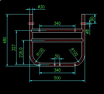

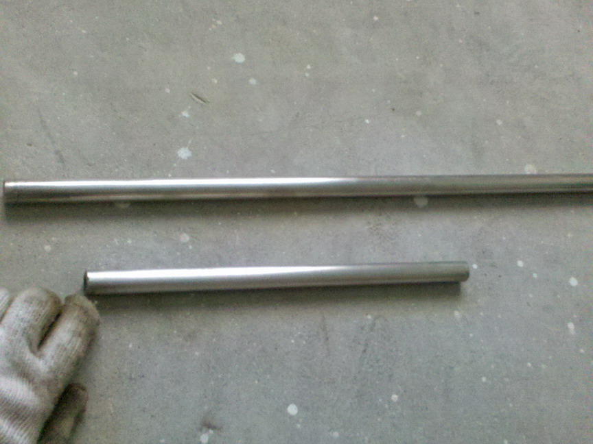

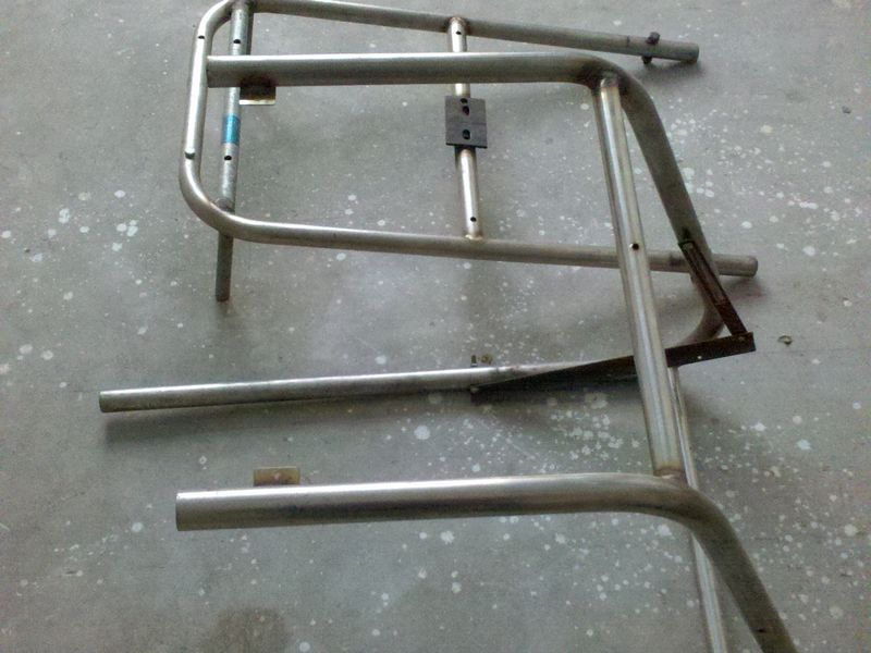

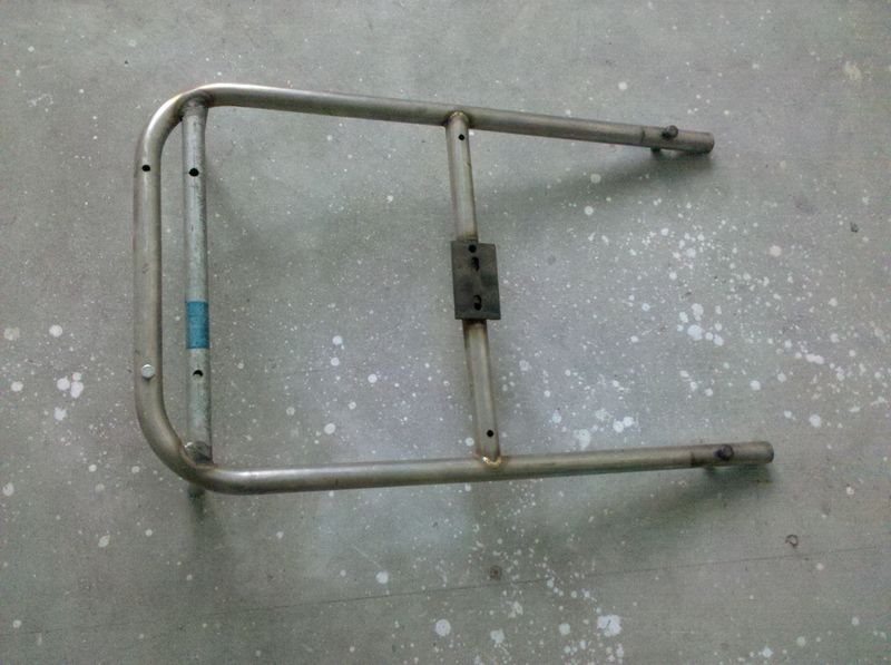

    The frame is easier than the PCB. :D This is my first frame i do.Look's not good, but i gain more experience,and mark some most important size.

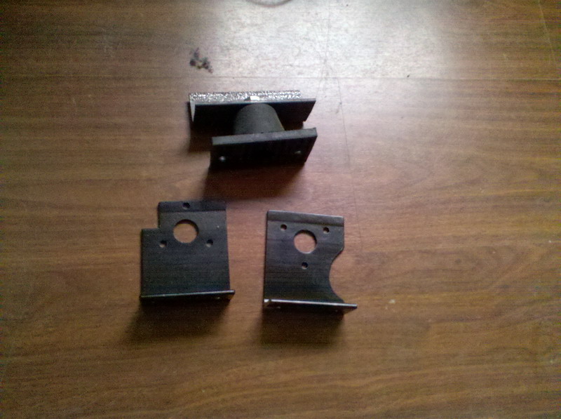

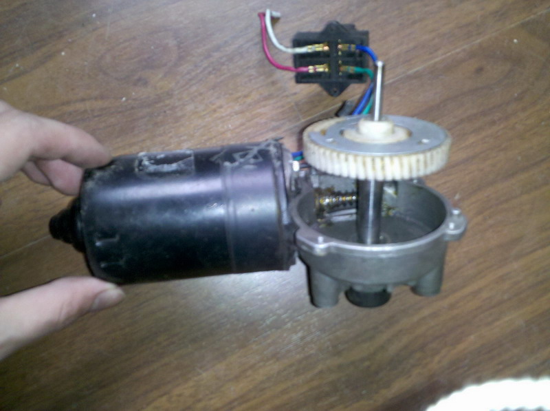

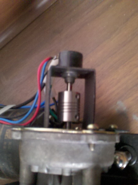

    I found the wipemoto ,and make the wipe axes a hole ,then it can drive the potentiometer .

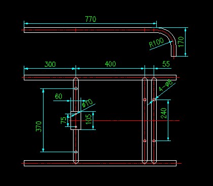

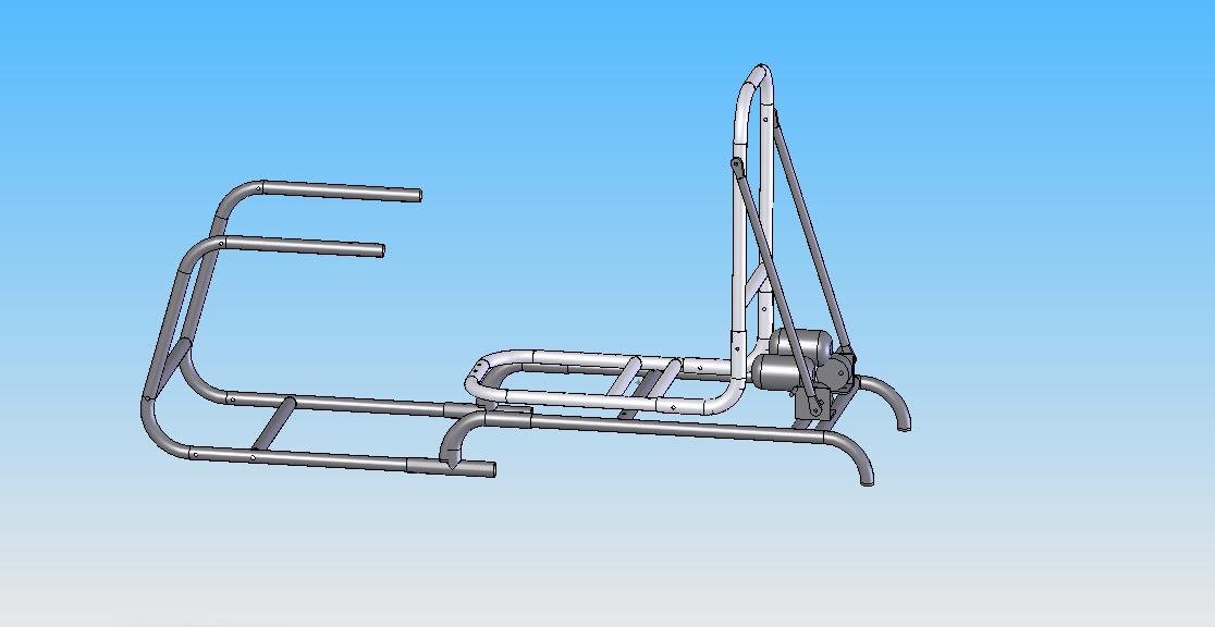

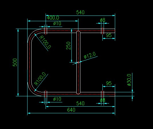

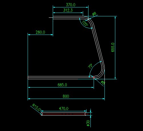

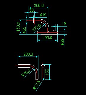

    today,here is the frame design size. Maybe some mistake,if u can finger out.thanks.

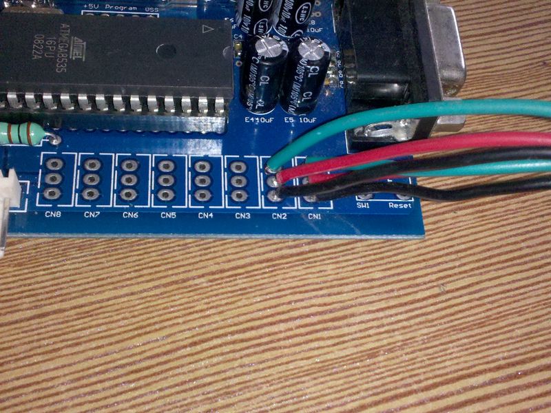

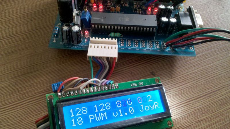

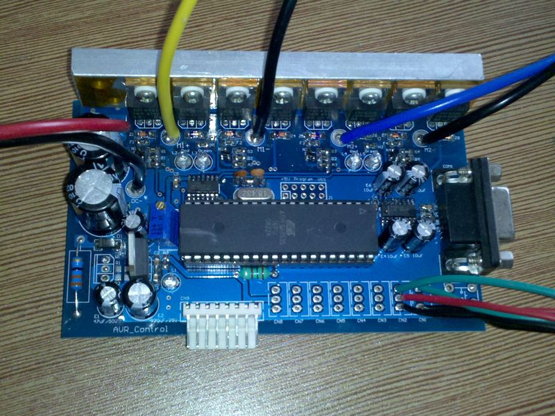

    Amazing job.My friend has redesign the PCB and finish jointing.I want to say more words but can't show feeling in english. U can understand me??:))
    i should buy one LED,and soldoring it ,then i can test the PCB. Make some display on this.:)

    WOW!!! That board looks good!!!

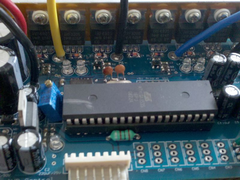

    That is very nice! I hope those MOSFET drains are isolated! Otherwise please make a video of the fireworks! :D

    8) thanks for your advise.I have test the board , the power is connected and the MOSFET are working normally.
    next i will test it with wipermotos.It will make some video if working normal. -_-|

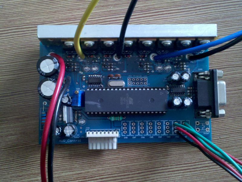

    really cool PCB!!!!! Is there anychance to see pcb layout?:)
    Is it dual layer?

    sorry,i am not have the layout.it's redesign by my friend.But i can ask him for the layout if he will.
    This is dual layer.
