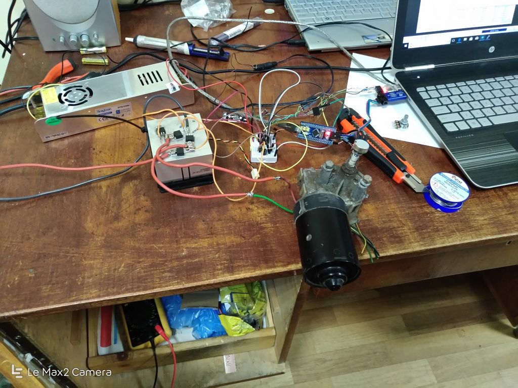

    1. Arduino IDE and STM32 based position contrler
    2. Motors DC from car wipers
    3. Encoder
    3.1 rotary and lineal encode type (two signals for one axis)
    3.2 rotary and lineal based on variable resistor(one signal for one axis)
    4 current controll logyc
    4.1 Porpotional (current=kp*(targetposion-curentposition))
    4.2 PID current control
    5. Mechanical consrtruction is discussed

    DC Motor Driver an angular Fed back Regulation P(current=kp*(targetposion-curentposition)
    -Problem: Very Hight Curent in revese monent, "kp" is 0.03 and curent is to smal without mehanical load.
