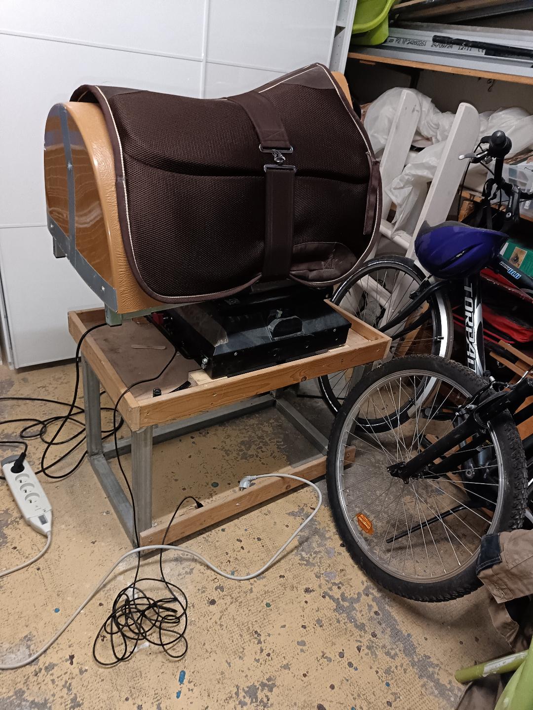

    2DOF, AC motor, Arduino
    I' ve been working on it for several years ( part time)
    I have built one, based on a 2 dof platform at the moment, planning to scale it to 4 dof and perhaps 6 dof.
    The main thing I' ve been working on is software because using accelerometer data is tricky, you have to clean the data a lot to get something good, it's time consuming .....
    So the solution I've found is programming walk , trot and canter on my computer and send data to my platform,
    of course a game designer could include this telemetry in a 3D game, should be perfect :)

  7. accelero
    accelero Member
    Jun 30, 2015
    63
    france
    287Coins
    +12 / 0 / -0
    here it is .
    One attempt was to use data from accelerometer on horse girth. VideoRideCreator is a nice stuff to do so. Playing the stuff in videoRidePayer is fun !
    But as I said, most of movements recorded by accelerometer seem to be irrelevant on a simulator, too noisy, So
    cleaning the data is a lot of work:Fourier transform and so on .......
