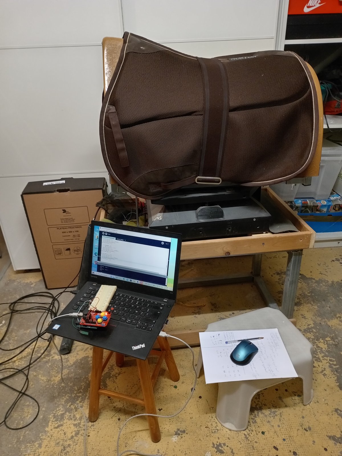

    Overall Project Goal: Create a Horse Riding Simulator
    Detailed Project goal: I want to try to create a Horse Riding Simulator (incl. VR Environment) which simulates the basic movements of the horse (three gaits) and can be controlled by the rider itself but also by the instructor. It contains therefore sensors for leg and rein pressure and a control interface for the instructor.
    My personal goal regarding this challenging project: Just start the learning journey, learn new things, do something useful. As of now I don't expect that I reach the project goal.

    Currently I am investigating if the stewart platform concept is the right approach to simulate the horseback movement. I am trying to understand the mechanism of the platform and therefore looking for a virtual simulation as it is shown in this video 'Stewart platform design and prototype' on YT (can't post the link). Excel based simulation.
    Does anyone know where I can get such file or (free) access to a ready simulation software?

    I don't think the dynamics of a horse are complicated, and two axes should be able to simulate them well.
  6. apple
    apple New Member
    Oct 15, 2025
    8
    58Coins
    Arduino, 6DOF
    Are you a rider?;) Actually the part where the saddles lies on (thorax vertrebrae) is not that flexible. it does rotation, bend, heave, forward, backward, shift. but the tricky part is the impulsion which comes from the four legs when touching/leaving ground. in every gait it is different. trot is the easiest one because it is a symmetrical two-beat rhythm. walk is four beat and therefore rather complex.

    Have you considered options like pneumatic motion options: https://www.xsimulator.net/community/faq/gseat.20/category

    No, not yet. The only thing I know about pneumatic that it is more expensive than linear actuator (when I am right or do i mix it up with hydraulic?). But I will investigate on that. Thanks for the input.
    21,787
    152,535Coins
    +11,085 / 56 / -2
    Pneumatics with bladders and RC servos is very cheap. An upside is that they can simulate a sustained force that may suit some of what you described, but likely augmenting an actuator driven rig.
    While I am not a rider I have been on a horse and the motion is part in how a saddle moves, plus the physical contact through the legs against the horse, which is where bladders may be of use.
    The other part that may also be worth considering is wind simulation: https://www.xsimulator.net/community/faq/fans-wind-simulation.67/

    Thank you. I investigated on that solution and it seems to be a suitable approach: softness, power to keep something in position, cheap, not very precise
    I definitely will keep this in mind.

    No barrel racing, no jumping ;)
    It looks so good! Getting something like this would make it a lot easier. I am currently trying to visualize the type of movements (degree, distance, speed) which i need to simulate. I hope this will help to figure out if such a system would be suitable.
    do you know how the general steering concepts works? i don't think i will connect to a driving simulator software.
    in my prototype i use arduino ide. i am planning to do the vr environment with unity.
