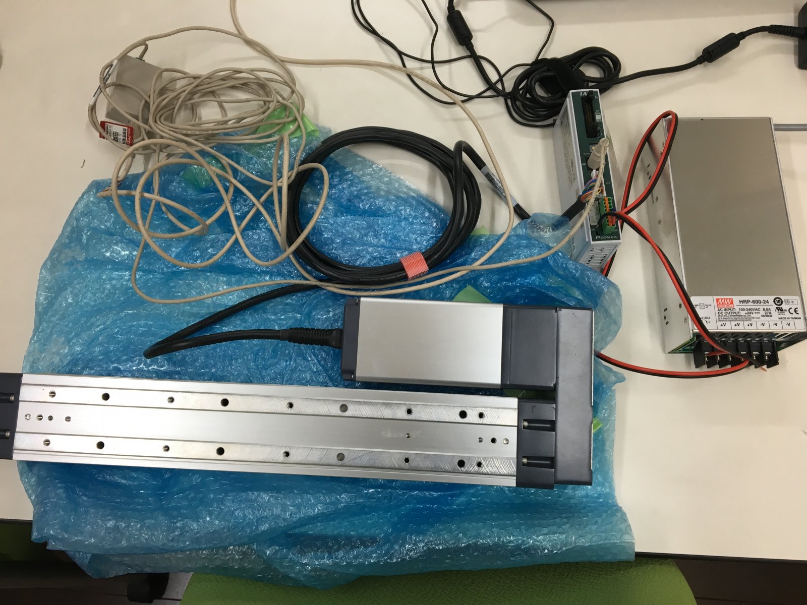

    Hello everyone.
    Here, SCN's actuators are often used, but I want to use IAI's actuators, and I am currently testing the operation by borrowing one demonstrator from IAI.
    Although it seems that there is no problem with the connection with the PC, it seems that it does not move at all in output test with SIM TOOL.
    Both SCN and SER connections do not work well for output type.
    Is it necessary to create a plug-in for ROBO Cylinder or a setting method?
    Could you tell me who is familiar with SIM TOOL?

    What do you do to make the actuator move now?
    How do you communicate with it?

    Hi yobuddy.
    I am thinking about RS - 485 serial communication by the same connection method as basic, SCN.
    However, it seems that it can not operate according to the SCN setting, and I am considering whether it can operate with SER connection.
    I do not understand how to enter Interface - Output field on SER connection.
    Does the IAI staff work if you write the IAI MODBUS code in the Interface - Output item? It seems to be thought.

    It is a report.
    An answer from a IAI staff.
    I'll answer the contents you asked.
    <<Question 1>>
    When I'd like to use an actuator, how should it be done?
    Do they have API and a screwdriver?
    Would they have an example?
    <<Answer 1>>
    It's necessary to control an actuator by Modbus communication to move.
    Our controller (PCON) is equivalent to a driver.
    An excerpt on an instruction manual is attached as an example of movement method.
    <<Question 2>>
    1) how can it start from a PC?
    2) how are the rate and the rate established?
    3) how should it be done to direct to move to point xx?
    4) does shut down turn that off?
    <<Answer 2>>
    1) when turning on the power to a controller, it starts.
    2) it can be established by rewriting of a speed designation register (9904:VCMD). Please check the attached documents for details.
    3) setting goes out by rewriting of a target location designation register (9900:pCMD).
    4) when reaching the target location, movement is suspended.
    It's possible to control our controller by Modbus communication.
    The one of the way to designate the target point of view and the rate as attached documents optionally and make them move
    A page is excerpted.
    Because the capacity is too heavy if it's the instruction manual whole.
    Download more than our HP, please.
    When I think from the information I received.
    It may be the one by which diamond Dick was developing software.
    It's for teaching work to the end by us.
    Software corresponding to a PC has been developed.
    It's probably, but it's something a PC control library will be right now.
    I think it isn't possible to offer it to you.
    The way to control in the Modbus communication elucidated formally.
    I'm thinking it's safe.
