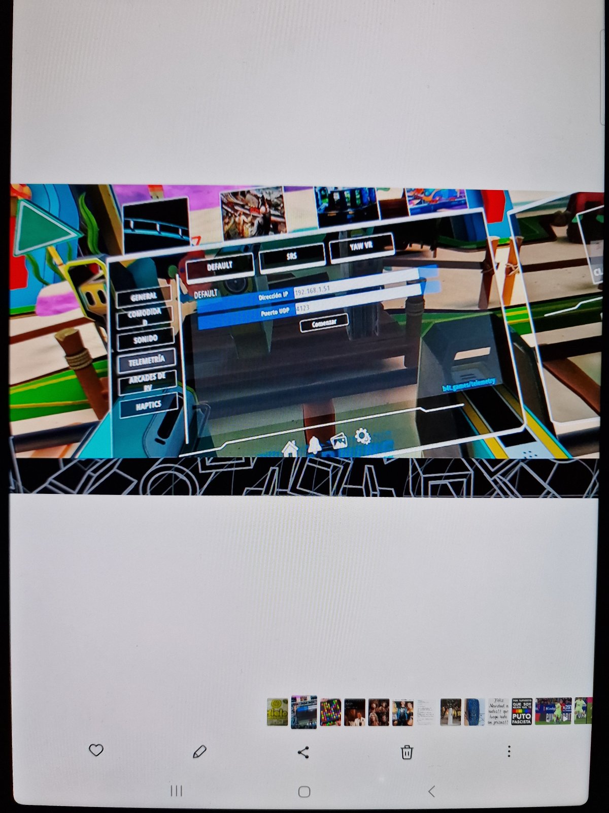

    Hello everyone,
    I currently have a PS5 + PSVR 2, and I'm wondering if it's possible to use simtools to simulate the motion of Epic Roller Coasters on a motion platform. I know that Epic Roller Coasters communicates via UDP. Has anyone received telemetry data from Epic Roller Coasters in the context of PS5 + PSVR 2? Looking forward to your sharing or suggestions!!!
  2. Danielbruine
    Danielbruine New Member
    Jun 18, 2024
    6Coins
    I hope this helps you, I opened udp port 4123 on the PC where I have simtools installed and in the PS5 game go to options, telemetry I put the IP4 address of the PC (192.168.1.35 in my case) with that it started working. To know the IP of the PC, open terminal and write ipconfig.

    Thanks a ton for the tip! I’m going to try that right away—fingers crossed it works. Your help is super appreciated!;)
