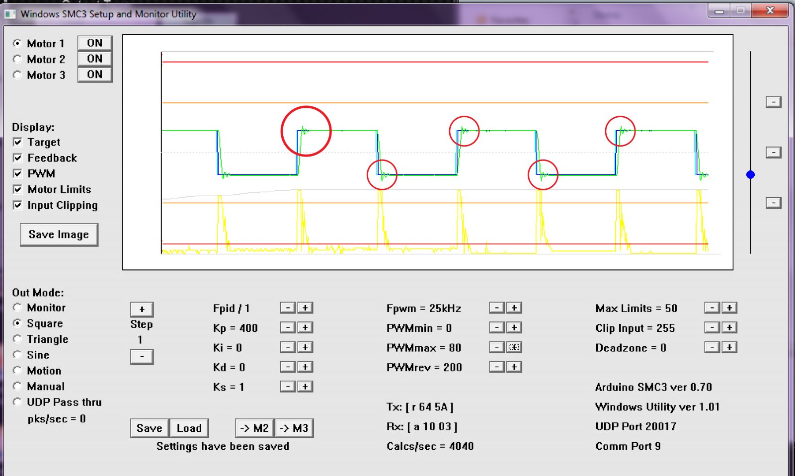

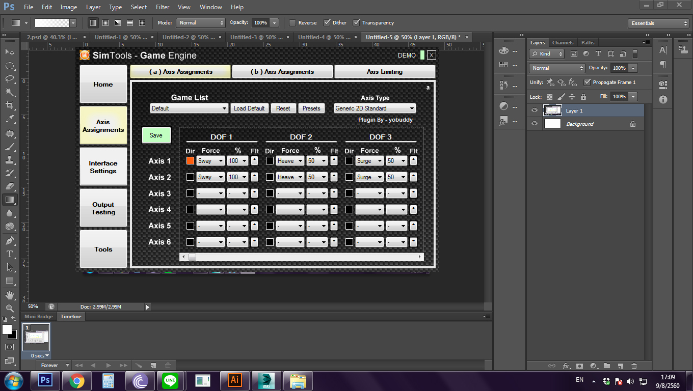

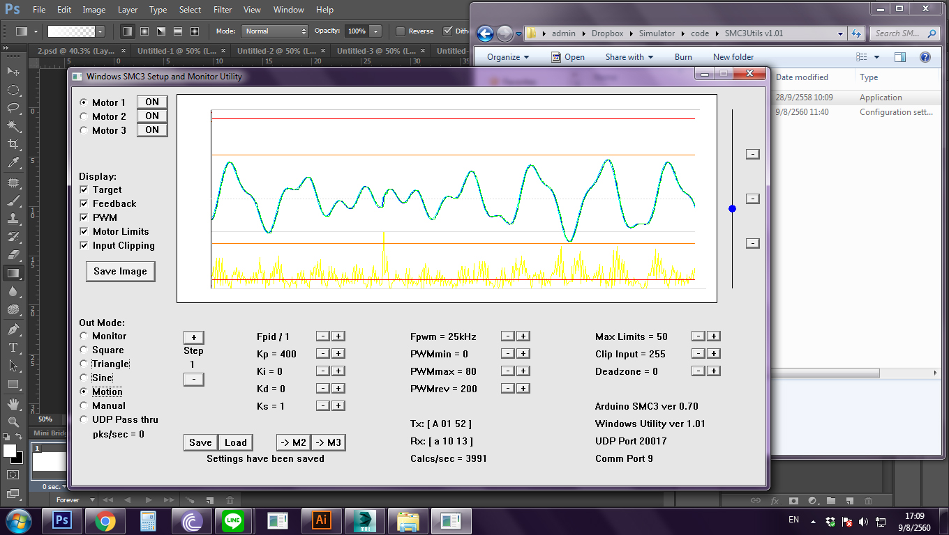

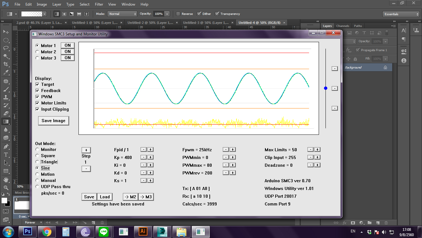

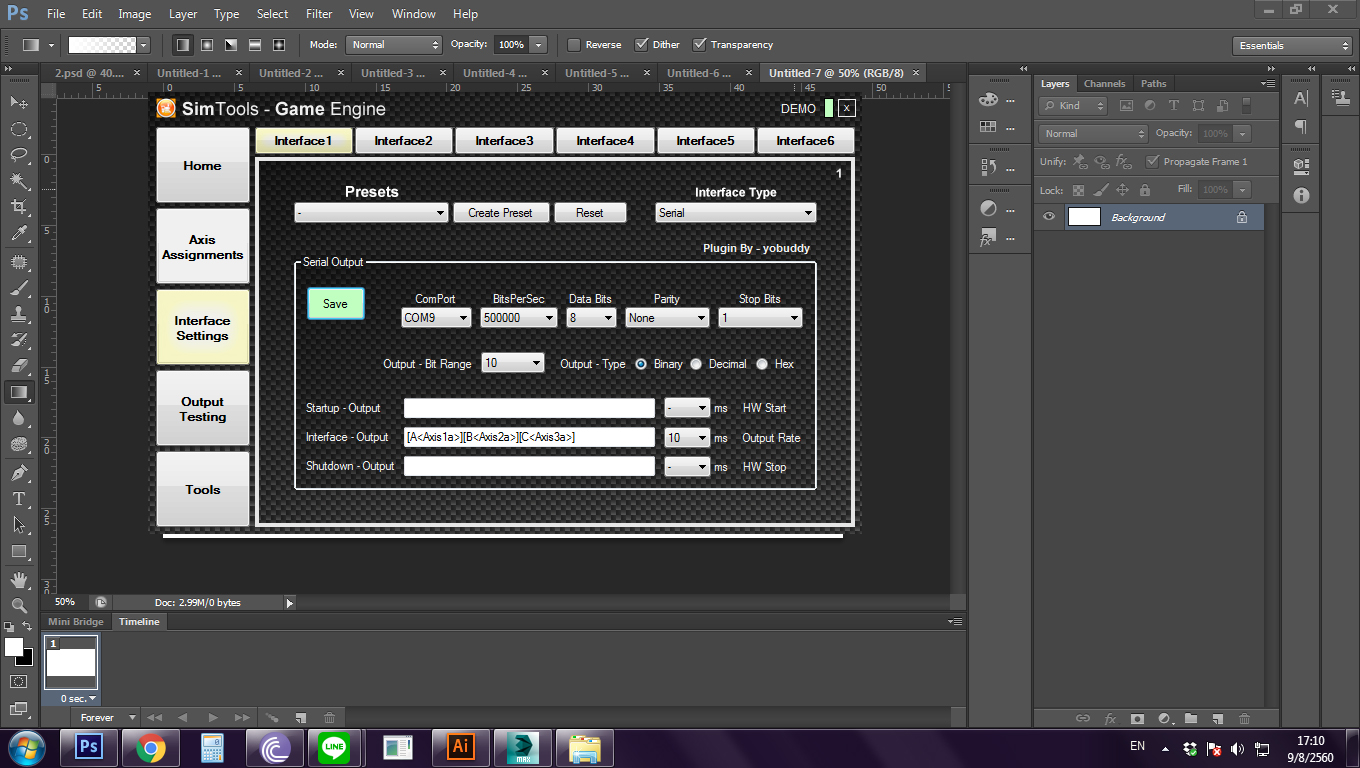

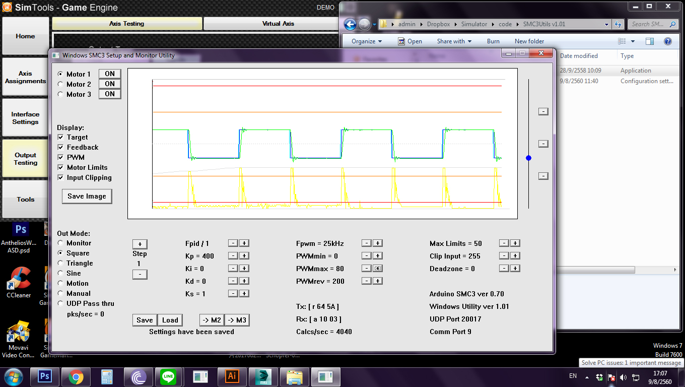

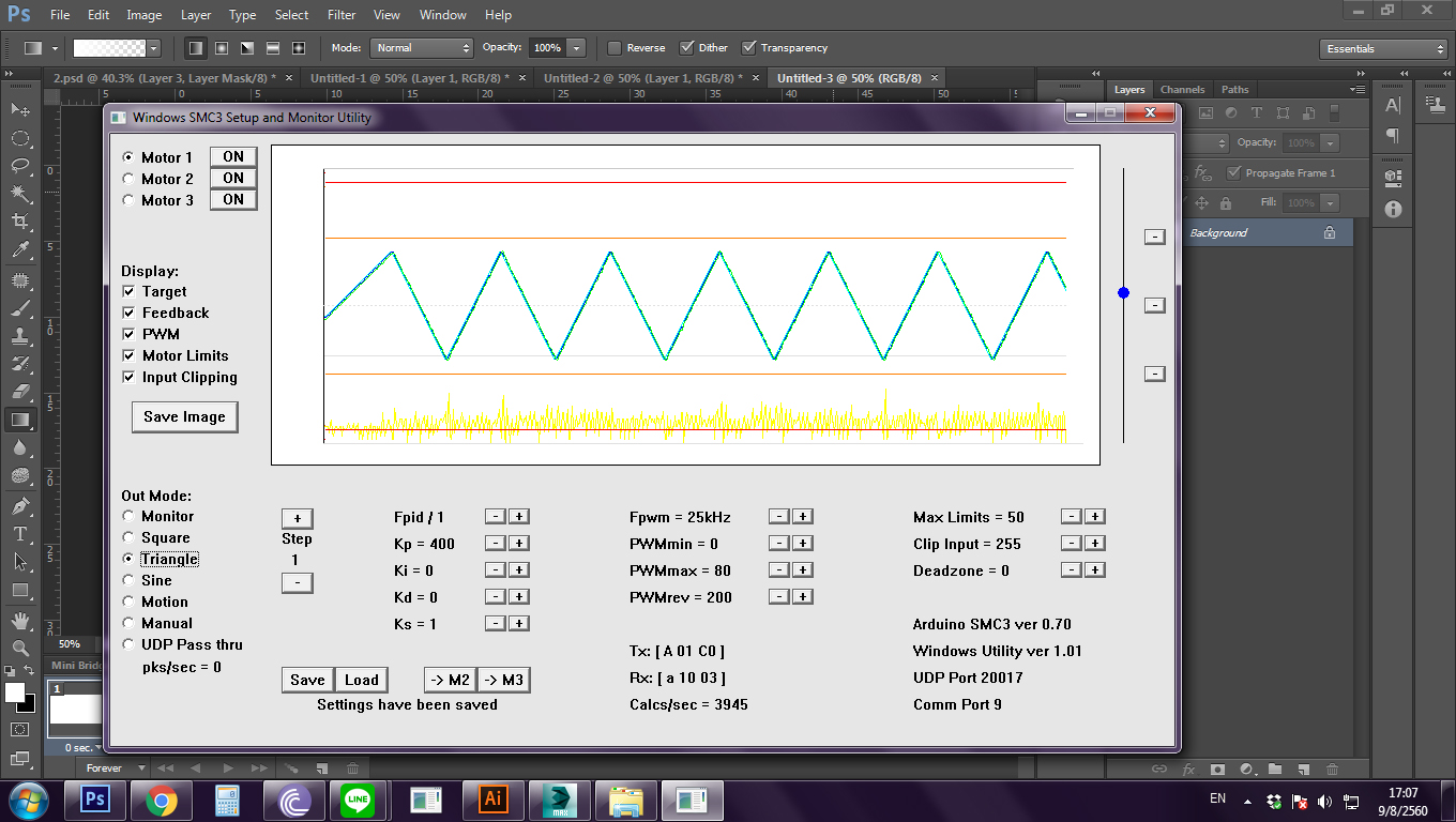

    1.When I start output testing in simtools the position is change 45 degree from middle.
    2. axis test 0-3% move fast 4%-55% is slow and then 56% it switch backward and forward

    do not different. I think it may have been caused by a potentiometer

    2DOF, 3DOF, DC motor, Arduino
    now position is in the middle. but it still jerk.
    I uncertain about motor or potentiometer.
    PS. I use wiring + - to motor in mini servo 9g. I will try on wiper motor soon.:)
    it't jerk when pwmmax >50 in SMC3
    it's varied by pwmmax.

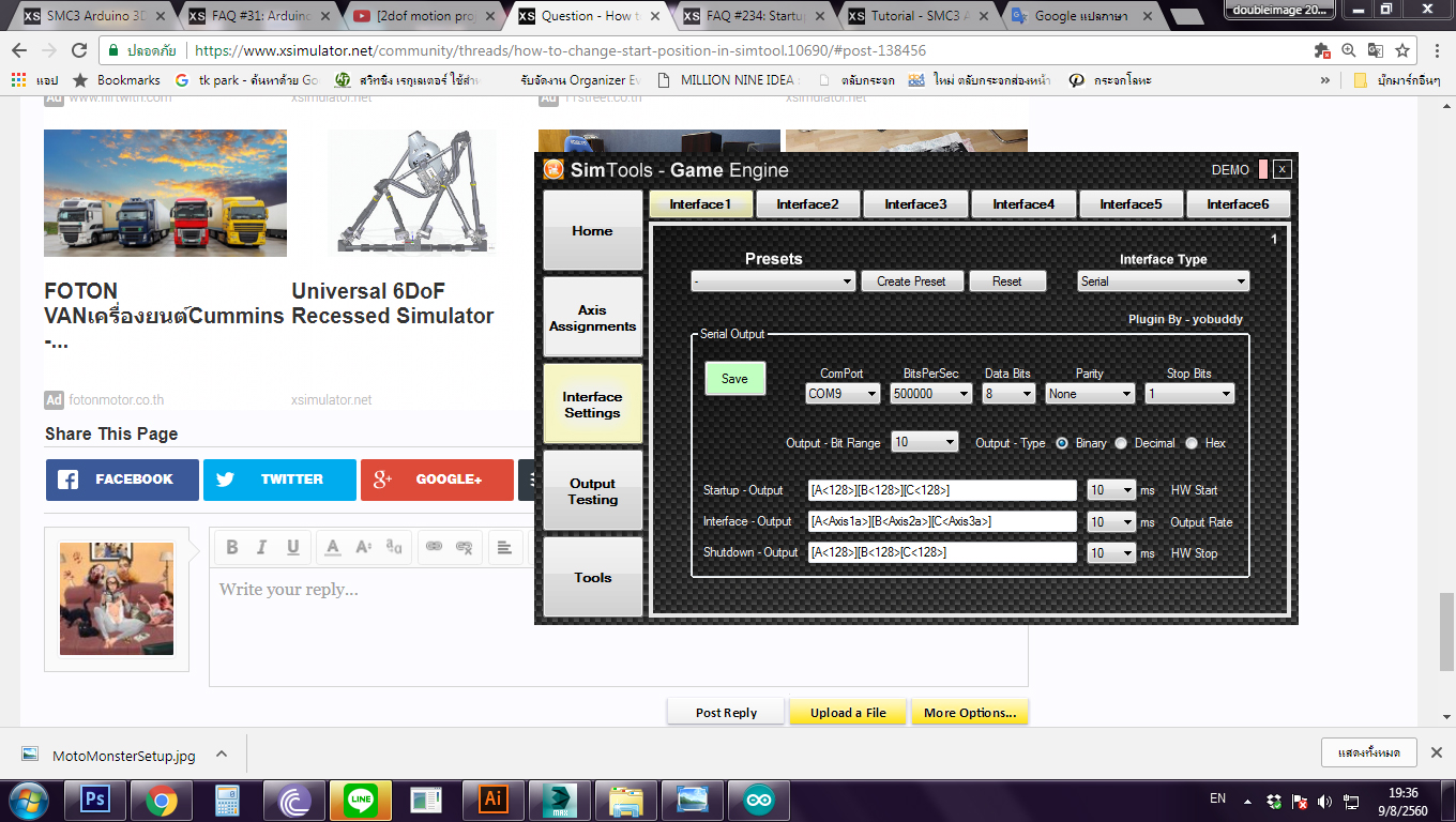

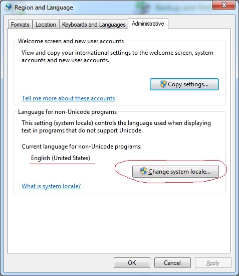

    Please try this and see if it fixes your problem buddy,

    I find a problem.It should be wiring potentiometer is not fit.

    Thanks!! It help for jitter and wrong starting position in SimTool. I was trying to fix this problem long time.
