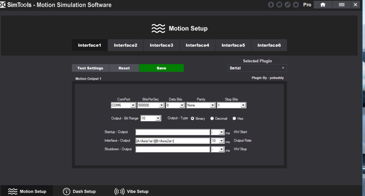

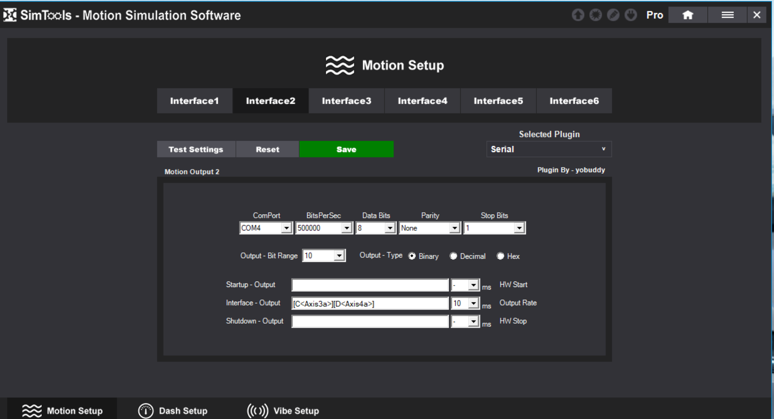

    hi guys
    recently changed my 3dof rig to a 4dof adding surge, running 2 arduinos driving 2 motors each.
    everything is working in smc3 as ive got 2 versions on a seperate com port..
    cant seem to get the simtools setup working, ive set up 2 serial ports configured to correct ports.
    my normal motors work ok but the new system doesnt work on test or when sim tools running..
    any ideas ? thanks in advance
    rico
  12. Rico Mortis
    Rico Mortis New Member Gold Contributor
    Jul 7, 2022
    29
    84Coins
    +8 / 0 / -0
    photos of serial port settings
  13. noorbeast
    21,723
    152,051Coins
    +11,063 / 56 / -2
    Is the Default profile in Axis Assignments also configured and if so does Output Testing work as expected?
