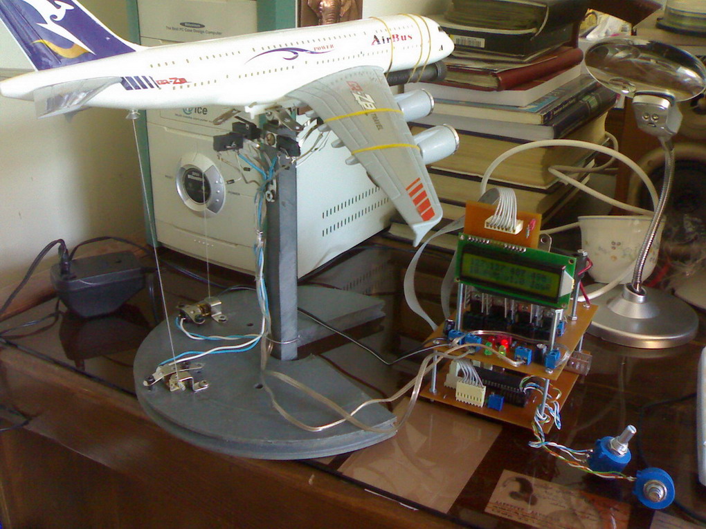

    well freinds
    ihave done all the steps to make my own motion flight simulatoin
    making Thanos AMC 1.5, H bridge, programming,connections,X-sim featurs
    running motors,making platfrom and others...which all of them work very well...
    but finally i am not actually satisfy with the accuracy
    how can i improve the precision, for example when i roll
    7 degrees bank to the left my seat on the motion sim also turn 7
    to the left not more and not less?
    should i have to add more devices or any sensors or somthings...
    thank you
    regards
    HOOSHANG

    Hello, for assistance you will need to provide more info and preferably pictures and videos of your sim.
    Also, what games are you playing?
    What motors do you have on the sim?
    You mention a sim angle of 7 deg, do you have a device on the sim to tell you the angle?
    Cheers, David.

    hello David
    thank you for reply
    here is a picture of my sim
    and i can also send you a video if needed
    -the game iam playing is MS FSX
    -i dont have any device on the sim project to say the angle,
    so what do you recommend for that and how does it
    work with the Thanos AMC 1.5 & H bridge?
    - the motors are two simple 6 volt DC gearbox motors
    sorry for english,hope u got
    regards
    Hooshang

    u need IMU for that job.

    hello Kelantan
    thank you for responce
    then how does it work with AMC 1.5?
    thank you
