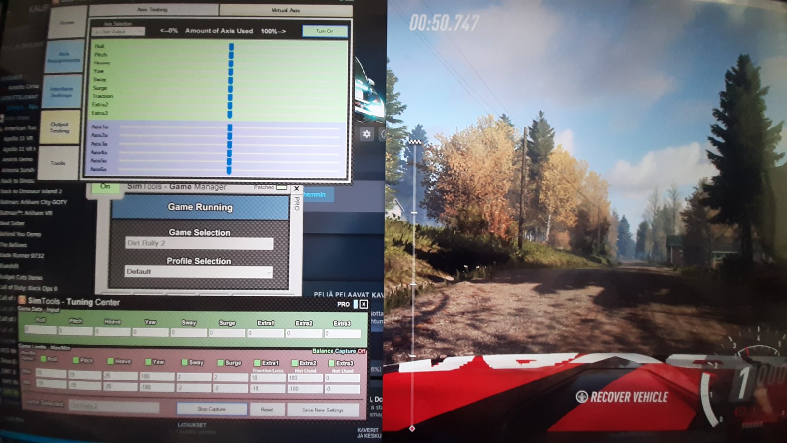

    Please post a picture of your axis assignments and a picture of the Tuning Center while DR2 is running.
  8. Ipponen
    Ipponen New Member
    May 13, 2020
    10
    - 97Coins
    21,058
    148,046Coins
    +10,885 / 54 / -2
    No data is getting through to the TC.
    Try temporarily disabling your firewall and anti-virus, to check if either are messing with communications.

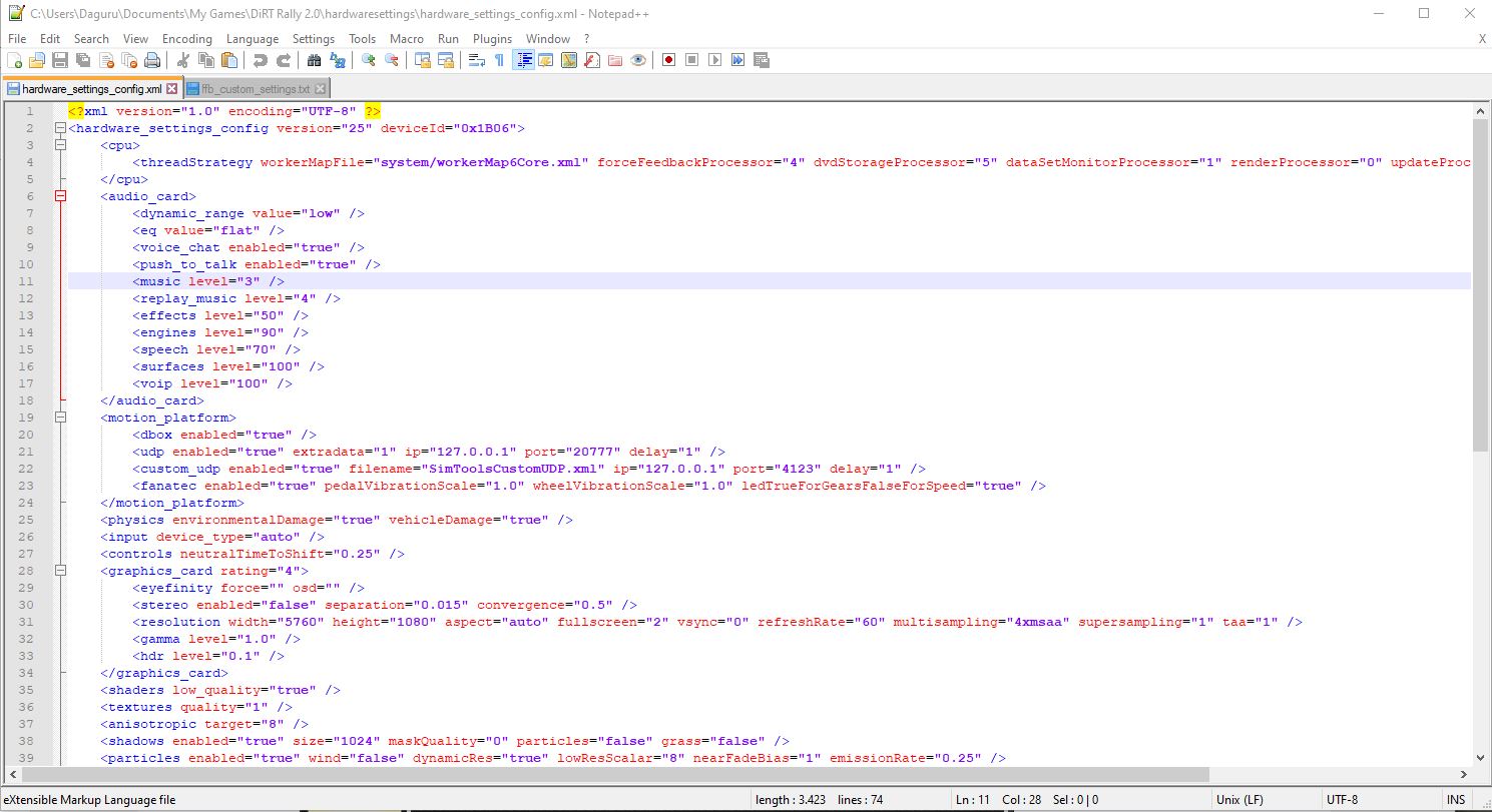

    Check in your
    hardware_settings_config.xml or
    hardware_settings_config_vr.xml if you are using VR,
    found below
    C:\Users\*your username*\Documents\My Games\DiRT Rally 2.0\hardwaresettings
    and make sure that it has this line in there
    <custom_udp enabled="true" filename="SimToolsCustomUDP.xml" ip="127.0.0.1" port="4123" delay="1" />
    example
    <motion_platform>
    <dbox enabled="true" />
    <udp enabled="true" extradata="1" ip="127.0.0.1" port="20777" delay="1" />

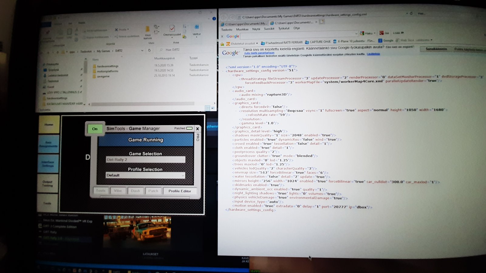

  13. Ipponen
    Ipponen New Member
    May 13, 2020
    10
    - 97Coins
    Such were found, whether something needed to be done and how it should be done, if necessary.
    Note. I am not a computer expert.

    Replace the line that starts with <custom_udp enabled with the one below
    do it in the VR one as well if you use VR,
    you will need to edit it with notepad or even better notepad++
    let me know if this works :thumbs

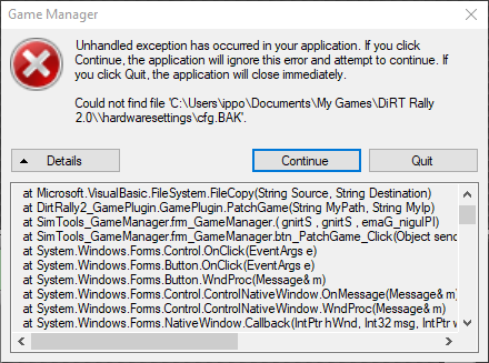

    I put the xml file, hopefully right. I tried it didn't work. I ran the race, did not work. I tried to remove the patch but couldn't get it removed manually. I put the patch again, I ran the race, it didn't work.
    Starts going finger to mouth what does that make you work. Are these so hard to get to work.

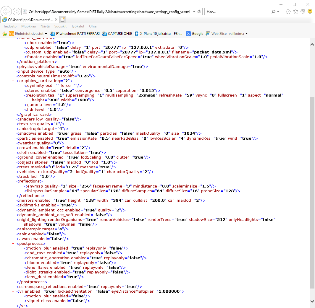

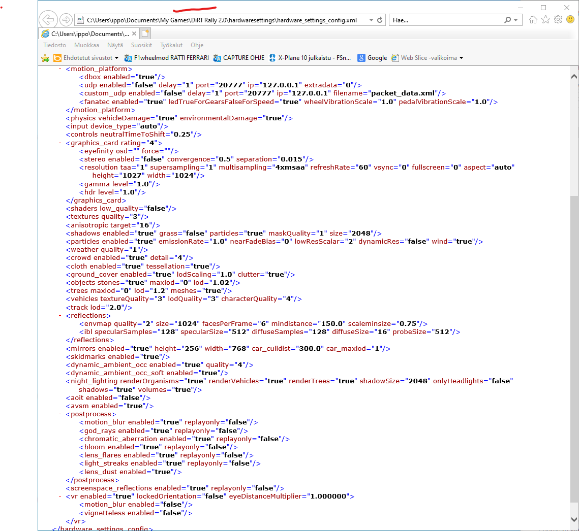

    sorry i just noticed it looks like this line above the one you changed needs changing to this
    if you can send me the 2 files i will test on my rig make changes and send back :thumbs

  18. Ipponen
    Ipponen New Member
    May 13, 2020
    10
    - 97Coins
    When I put in the new patch, then I can't get in touch between the game engine and the game manager. Previously there was a connection. I put the hardware you sent, but did not connect. There will only be an attachment.
