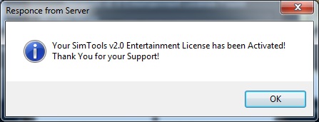

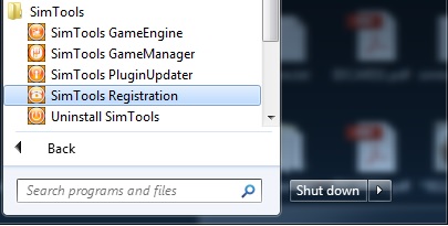

    Here is a step by step on how to register SimTools v2.
    1) Launch “SimTools Registration”.

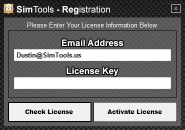

    2) Enter the email address you purchased your license with into the “Email Address” text box.

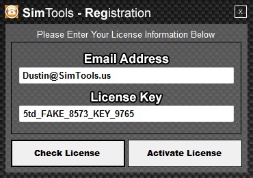

    3) Enter the license you received into the “License Key” text box.
    4) Click “Activate License”.
    That’s it, enjoy SimTools v2! :thumbs
