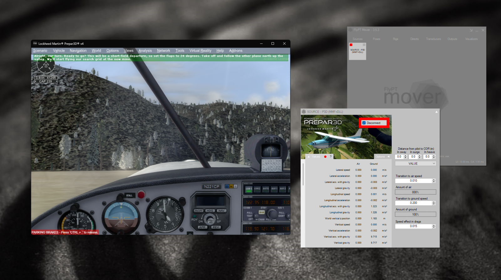

    To get data from P3D, I tried to configure the FlyPT_P3D_DLL.dll file in the FlyPT "Files for sources" folder.
    However, after exhaustedly tried every combination of dll.xml and SimConnect SDK, I eventually got an " Error loading dll" message in the Content errors.txt log file.
    Is there any instruction or clue on how to install and configure FlyPT_P3D_DLL.dll? And which version of P3D and SimConnect it supports?
    Thanks so much @pmvcda !

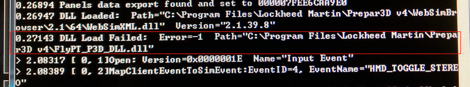

    Unfortunately, it didn't work on my computer. ;-(
    VC++ Redist 32bit installed.
    P3D SDK installed.
    I got the diagnostic log prompt from P3D:
    And I'm pretty sure the dll.xml setting is correct. Because I tried copy and rename another add-on DLL file, then rename it as 'FlyPT_P3D_DLL.dll', then I got that DLL file loaded successfully.
    Must be some DLL compatibility issue. What's your P3Dv4 tiny version ? And what's your Visual Studio compiler configuration ?
    My last solution is to develop an P3D add-on on my own, which compatible with your MMF protocol. Could you please tell me the MMF file name and layout definition? Thanks!

    I'm using this version of P3D: Prepar3D_v4_Academic_4.5.14.34698
    With the SDK we have on the P3D site also: Prepar3D_v4_SDK_Setup_4.5.14.34698

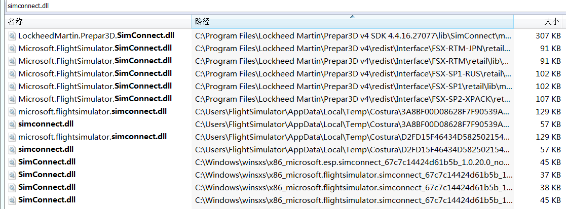

    If you have other plugins, can you check if there's a simconnect dll inside the p3d folder?
    My dll might be trying to use that one since it's the first one found and if there's a problem there it might be because of different versions of the dll (simconnect).
    I installed everything yesterday to test (and to develop for Mover 3.7 and 4.0) and it works well.
    I will check the mmf and post here. I'm at work right now.

    No, I don't have any simconnect.dll inside the p3d folder.
    By search whole disk using keyword "simconnect.dll", I got
    Pretty sure thoes are ALL files named "simconnect.dll"

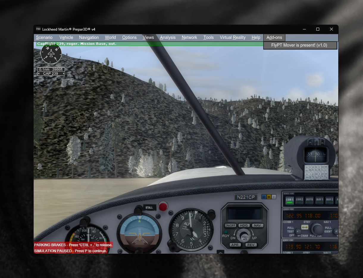

    I have made some progress by myself.
    By installing VC++ Redist 64bit,not 32bit, now I can load the 'FlyPT_P3D_DLL.dll' successfully (No error anymore in the log)
    That makes me confused. The FlyPT_P3D_DLL.dll in the FlyPT 3.5.3 “Sources files” folder is a x64 machine (you may confirm this fact by dumpbin.exe /HEADERS FlyPT_P3D_DLL.dll), it can only successfully load when vcruntime140_1.dll file presented, which is a part of VC++ Redist 64bit.
    However, when runnig the sim (NOT ON THE MAIN MENU) , I don't have the add-ons menu (last item in the right of the sdk menu). As a result, my FlyPT can open(Connect) MMF, but can't get realtime data correctly.
    I suspect that's the old simconnect.dll issue. We have a lot of simconnect versions avaliable and which one matches with your dll?
    And mabe find a better practice to load simconnect.dll, rather than just use the one inside the p3d folder ;-)

    Problem solved! ...........in a surprising way....
    My Prepar3D minor version was 4.4.16, your DLL do NOT support it !
    I instead installed P3D v4.5.14, and immediately got everything work !
    And, only VC++ Redist 64bit is essential.
    P3D SDK, not necessary.
    legacy simconnects (all of them), not necessary
    latest recompiled dll , not necessary
    And no need put dll in the P3D folder or edit dll.xml. Just put dll in the %USERPROFILE%\Documents\Prepar3D v4 Add-ons\FlyPT, and create an add-on.xml
