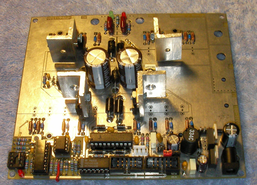

    So here is the latest teaser.
    This is an initial run of the HPMhb-150A with 12VDC batt input running a wiper motor. The thermal and current overload features are not yet active (they will require firmware for the ATtiny mcu), but the optocouplers to separate logic from power circuits are fully implemented. This test was a preliminary one where only 1 MOSFET per quadrant is used. The full compliment will be 4 per quadrant for a total of 16. Rated at 75A each, that would be a max continuous of 300A with proper heat sinking and fan (already fully designed). The heatsinks on this test are just basic ones. It is conservatively rated at 150A, and that is the limit of the current sensor used.
    I just tested with dual-batteries at 24V, and the input can be up to 48V nominal, allowing for the slight over voltage of fully charged batteries.
    You can see it in operation here...
    http://s529.photobucket.com/albums/dd33 ... yrun02.flv

    I know some people have mentioned them around here before, but is this board much better than the OSMC board ? ( or are they completely different products )
    thanks
    T
  5. tronicgr
    tronicgr
    The OSMC motor controller is similar but it miss a lot of features that HPMhb-150A has...
    Let me name few:
    -Optocouplers to isolate completely the logic from the power part,
    -Single PWM input (speed) with two digital direction controls, to be fully compatible with AMC motion controller, and ability to daisy-chain two HPMhb-150A boards through the same control cable.
    -Watchdog microcontroller that monitors current and temperature level to automatically shut down the h-bridge in case of emergency, saving the mosfets.
    -Possibility for I2C communication between AMC and the watchdog microcontroller to set the current and temperature level limits.
    Thanos

    First off, let me give credit where credit is due.
    The OSMC board design is the basis from which I began the design of the HPMhb-150A. That H-bridge is a tremendous development of simplicity and size to output capability. It has consistently proven itself in robotics.
    But, after burning through numerous MOSFET trying to drive high powered motors with the excellent DSMhb, it became obvious that not only a more powerful H-bridge was needed, such as the OSMC project, but one that had generous and multiple protection features built in!
    So began the HPMhb-150A and Thanos' generous help with the design mission. Thanos has just stated the main differences, but there are a few more such as...
    -thermal and current overload components built in
    -slightly larger size to allow for much larger heatsinking
    -better connection facility using bolts/lugs for higher current capacity
    -onboard main fuse protection
    -additional 5V supply (besides 12V) dedicated to the power section
    -much thorough power supply filtering for 5V, 12V, and Batt V inputs
    -more flexibility using jumpers in how the power supplies are distributed
    -very large planes for the power supplies and motor drive lines (no need for trace buildup with solder).
    -included more TVS (Transient Surge Suppresion) components
    -motor drive LEDs which can be remotely mounted to enclosure facia
    I wish to thank all those who participated in the design of the OSMC, for without them, this project might not have developed quite so fast and efficiently (i.e. less mistakes).
    But there is more work to be done to finish the project, with thorough testing before release.

    288Coins
    Nice work.
    I want ask, why it could handle only 48 V ? Is it because type of transistors ? I ask because many servos (from old cnc) have higher voltage.
  10. R-eng
    R-eng Member
    Aug 4, 2008
    141
    San Diego, CA, USA
    28Coins
    The design criteria and the need to convert the voltage from the battery(ies) 12-60VDC to12VDC with a wide range and dependable DC-DC converter (so the HIP driver can be used), predicated the limitation to 48V nominal. The component selection fulfills the additional headroom needed to handle the slightly higher voltages present in freshly charged batteries when 4 are used in series, without bumping up to the ragged edge!
    Seriously, how many need to have more than 48V nominal??? If that is the case, then you need to look into industrial solutions and their higher $$$.
    And aren't old CNC servos industrial items?
    P.S. another distinction from the OSMC is that it could only handle 50V max, limiting your batteries to a safe 36V nominal, based on the design/recommended BOM.

  18. tronicgr
    tronicgr
    We decided to use a really small microcontroller (ATtiny45) for the watchdog function as this gives us the opportunity to program ourselves the limits of each sensor, and the windows in which will be active. Hell, we also can add shutdown delay timer in case of overheating in slow rate indicating that the extra heat is no real problem but a temporary load (like the extra bumping motion you get when you get off the track for a while).
    And the best part with using microcontroller is that you can declare these limits with real numbers defined in Ampere or degrees of Celsius. Nothing simpler than that for the average simmer, that don't know how to calibrate the old style comparators with multimeter and advanced math equations...

    Thanos, I agree that it would be very nice and I would prefer the microcontroller as well for a fully programable and adjustable control system. All I'm saying is that it could do so much more with a bit of programming once the communication is working.
    Using a comparator wouldn't be any much harder in my opinion, the only difference is that the temp and current limits would be set by 2 calibrated pots on the controller. There would be given min and max values on the pots and they would adjust proportionally in between, fairly straight forward. A delay is also possible, in fact a thermal delay is already there if you put the sensor further away from the fets. It would definetly be cheaper, less complicated and just as effective until the Attiny is working completely. I will go this way and let you guys know and decide what is easier and better to implement.
  20. R-eng
    R-eng Member
    Aug 4, 2008
    141
    San Diego, CA, USA
    28Coins
    The ATtiny is a functional part of the HPMhb-150A pcb already. The entire circuitry has been designed for awhile now and there is no anticipation for any changes, other than very small value changes for some of the passive parts so all functions operate at max efficiency.
    The current and thermal limits, as well as thermal recovery is set by defined values, which are clearly preferred to some arbitrary position on a pot. If I want the current to shut off at 57A or 103A or whatever, up to 150A, then that is what I get. No guessing, no approximations, no ambiguity. Same with the temp, who's delay is then set by a thermal drop from the set point, not some ill defined time delay. All this is easily and precisely set by the user, for their own simulator demands and limits, individually for each motor. That is precision and efficiency of protection. This was the design criteria for the HPMhb-150A. It is very simple and inexpensive.
    BTW, knowing and setting the temp precisely at the point of desire, the MOSFET, is the preferred way here. And not using it in some variable delay scheme with distance manipulation. How on earth would you determine and control all the thermal variables possible with even a small remote location?
    The method used is pretty inexpensive, is not complicated, and is extremely effective. Done!
