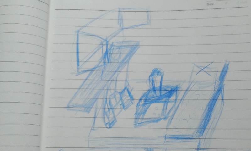

    Hello All. :)

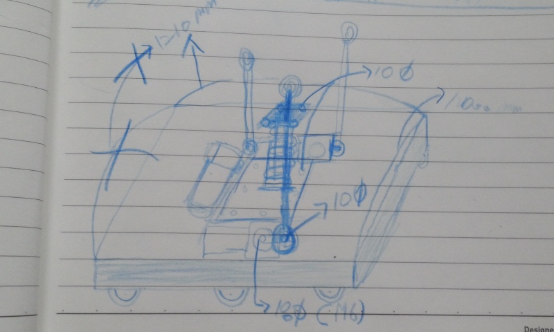

    I want to be make for the 3DOF for flight motion simulator.
    so, I tried sketch with pen in yesterday what I wanted. so I'll upload now it but there are still need a lot of explanation.
    I continue to update as picture and comments and I'd ask some questions.
    by the way, completed the purchase of lists, below...
    Motor Controller Board : Pololu Jrk 12v12 USB Motor Controller with Feedback x 3
    Motor : 12v 250W DC Motor + Worm Gear Head x 3(Motor Gear Ratios 60:1 and 50 RPM, Max 28A, Torque 28Nm)
    MEAN WELL Power Supply : 350W x 3(for 12v)
    Potentiometer : Bourns 6639s 5K x 3
    Birch plywood : 30T(1210 x 1000mm) x 2
    Joint : Joint with Spring x 1
    PS : Other minor ones were excluded for purchased of lists.

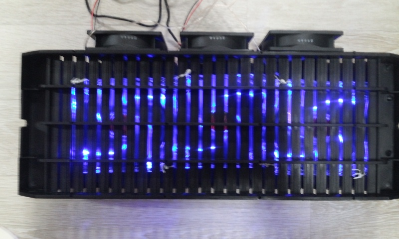

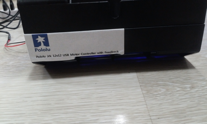

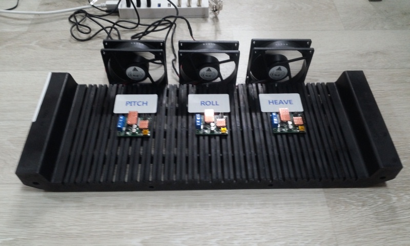

    Hello All. :)

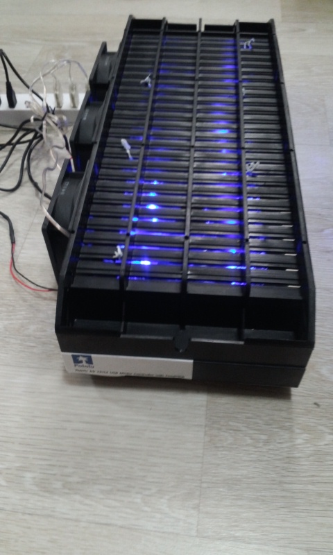

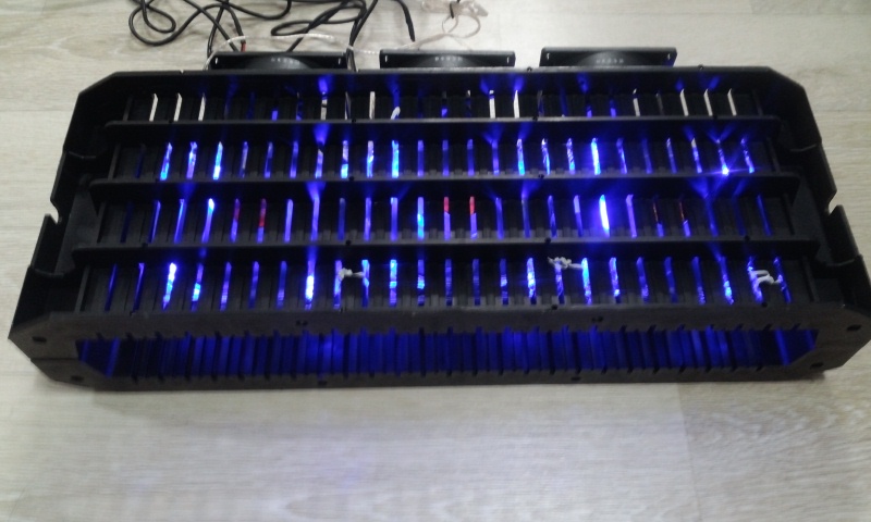

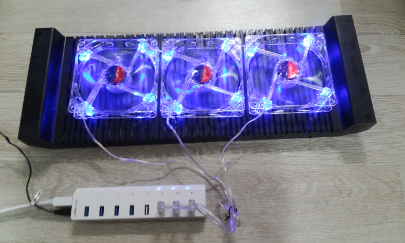

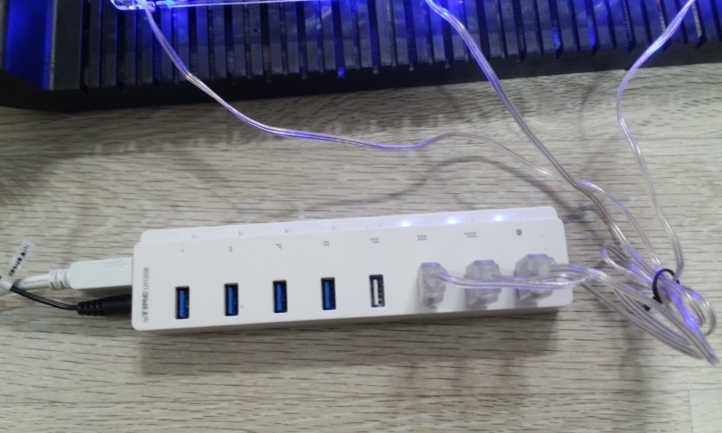

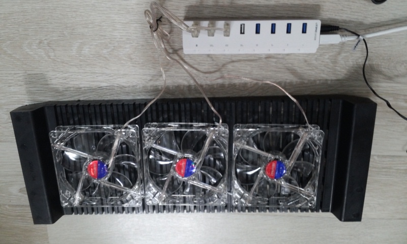

    The case has been completed, This evening.
    The Pololu Jrk 12v12 USB Motor Controller with Feedback and Potentiometer x 3, Lighting manufacturers staff gave to solder the The week before last week.
    because, I will ask him to it.
    I have to buy a soldering apparatus however, In some ways was worried. so...
    and I gave to him $30, but as to be exact to say , Korean currency 30,000 won.
    That black case is conductive PCB Rack.
    But I do not know what it is conductive and MPPO, that is ignorant of me. :oops:
    anyway, In the shop website, Description is conductive MPPO material safe from static electricity that protects the PCB.
    The cooler is black cooler 92mm, and 120mm blue LED is on transparency.
    Pololu motor controllers and the ditch in front of the logo with the Motor Controller name to those outside the case, I will printed use to by printing papers for labels.
    also, I found Pololu logo is https://plus.google.com/ pololu/photos?hl=ko :grin
    but that title is profile photo. :rolleyes:
    I'll keeping the update. :grin

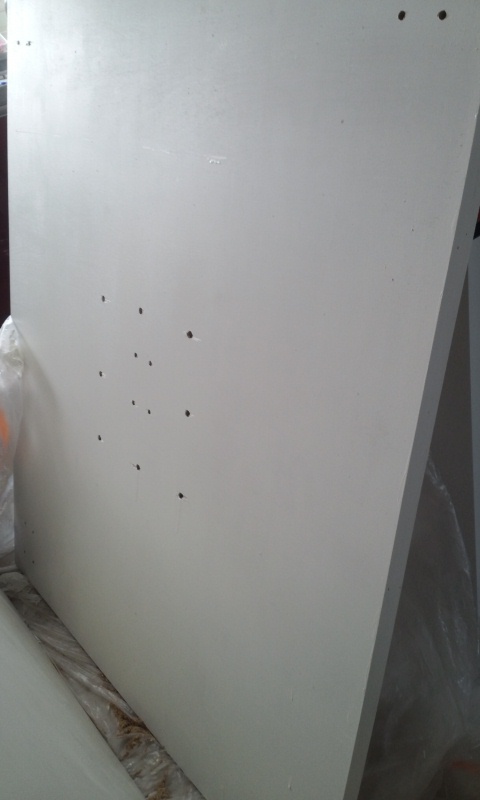

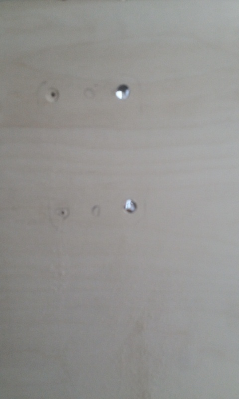

    I just drilled two holes 8mm. Birch plywood 30T...
    But It is very difficult... :eek:
    My drill is a rechargeable drill.
    I'm off today so, I working for my only motion simulator.
    I just want to have one workshop. :cool:
    because, I have to do this at home... :D

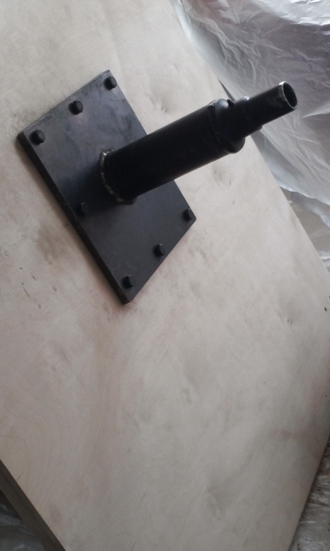

    I completed a standard 10mm drill hole in the birch plywood for lower part of the joint, today...
    I am looking forward to a day to be completed and Fly me to the with my only one 3DOF motion simulator. :rolleyes:

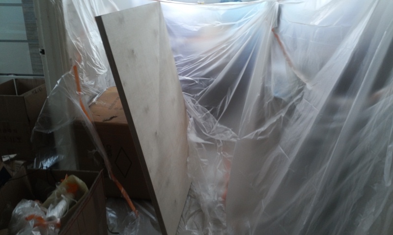

    Hello All. :)

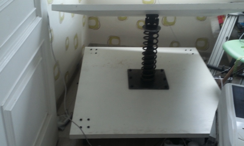

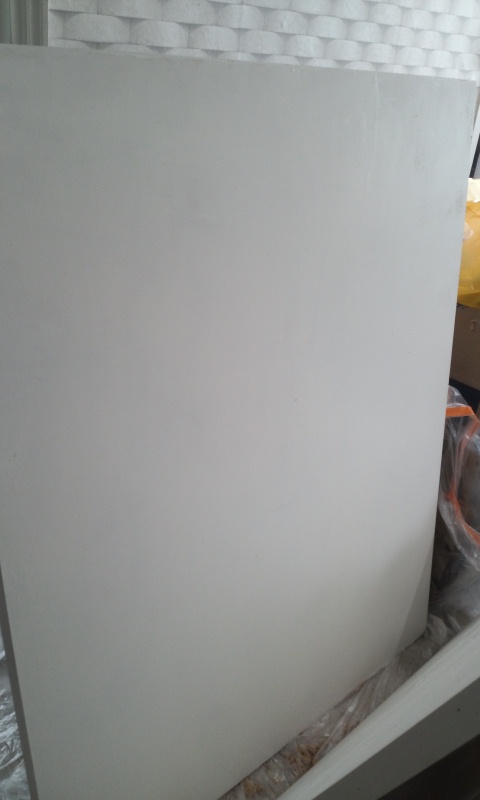

    Today was painted on the lower plate and upper plate.
    Currently it is drying.

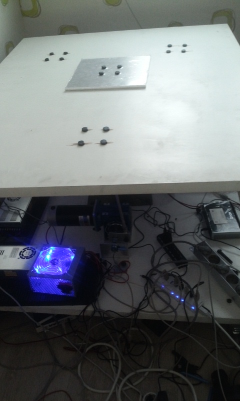

  8. hunijjang
    hunijjang She is my wife :) Gold Contributor
    Jan 30, 2015
    90
    Operator
    Seoul, Korea
    1,164Coins
    +17 / 0 / -0
    Hello All.
    lower and upper frames almost done... ;)

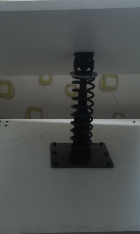

    21,149
    148,590Coins
    +10,907 / 54 / -2
    How did you work out the rate for the spring @hunijjang?

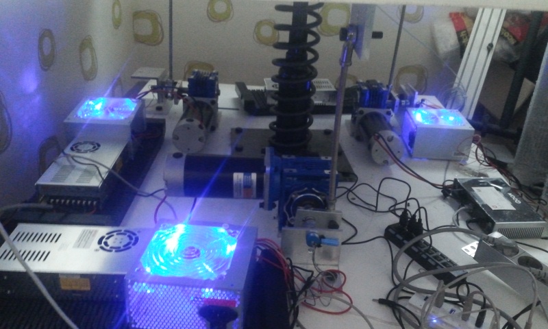

    Hello All. :)
    I have some good news and bad news for my this project.
    First, The bad news...
    The first was something moving the motor in the last evening then not be moved back what the motor to move.
    so, today, I did continues to test it.

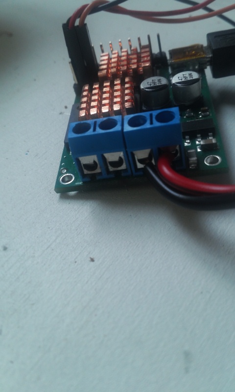

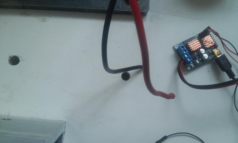

    and when I touched Motor output the wire for Adjustment of something...
    then The one board was blew up with the smoke. :(
    yes perhaps that is so crazy, because I had connected all wires(thats mean by also Motor Power Supply on)
    Second, The good news...
    Confirmed one potentiometer and the one motor is moving with Pololu Jrk 12v12 USB Motor Controller with Feedback. ;)
    @noorbeast Forgive me for being late my reply to you. :(
    maybe like this
    21,149
    148,590Coins
    +10,907 / 54 / -2
    It sounds like you created a short and the puff of smoke will likely be an expensive lesson in how important it is to take care with wiring and soldering :(

    I have one questions.
    My motor wires is thick then Jrk 12v12 board motor outputs A and B connector. How can easily connect the wires to the Jrk 12v12 board? :sos
  13. noorbeast
    21,149
    148,590Coins
    +10,907 / 54 / -2
    You have 3 choices. Join the motor wires to slightly small gauge wire that then goes to the JRKs. Solder the wires directly to the hole in the board without using a terminal block. Order larger gauge terminal blocks, you can get them on Ebay.

  16. hunijjang
    Jan 30, 2015
    90
    Operator
    Seoul, Korea
    1,164Coins
    +17 / 0 / -0
    Hello, All. :)
    I was mostly completed for testing. ;)
  17. noorbeast
    21,149
    148,590Coins
    +10,907 / 54 / -2
    Exciting times, well done :thumbs
    When you can please shoot and upload a video of your testing, I and others would really enjoy seeing your simulator in action.
    I can't see any fuses anywhere and given you have had one expensive accident you may want to consider adding some. Here is how you can work out what size fue you need: http://www.xsimulator.net/community/faq/what-fuse-do-you-need.111/
