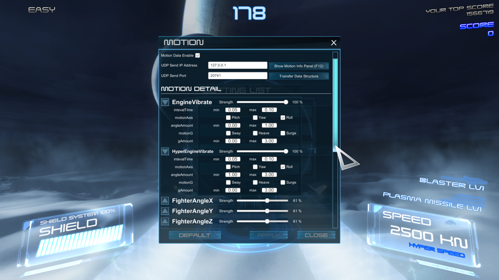

    ANY COMAND LINE to working? game engine, manager and dash recognizes the game but nothing happens on motion !!

    well, game engine, manager and dash it works. ( recognizes the game ).
    shows GAME IS CONECT.
    but no moves on platform.
    is it necessary to put any ip address, port forwarding open on modem, or in game? tks

    ok problem solved. plugin dont come with min max values. so i open tuning center, start caption min max and all its fine.
    IMPORTANT: in my case, all axis its inverted, so i need to change all too.
    for now, new problem appear :( wind starts at 100% and stoped only when i shutdown usb cable.

    great day rs.... winds solved. well, spaceship haves a hge velocity in this game. so, code
    on dash canot trepassing 100 ( speed ). just put line codes: MATH * 0.999, PAD 3 0 (ZERO ) AND ROUND 0 ( ZERO ). THIS WORKAROUND SOLVES THE PROBLEM

    Hi. paulopsx2
    I didn't know if I needed a minmax file to work with the simtool plugin.
    Because the settings are different for each device,
    I knew that the device setting was done by the user.
    Now the minmax file has been updated. Please check.
    And data-specific settings can be made in the game.
    I have posted a screenshot so please check.
