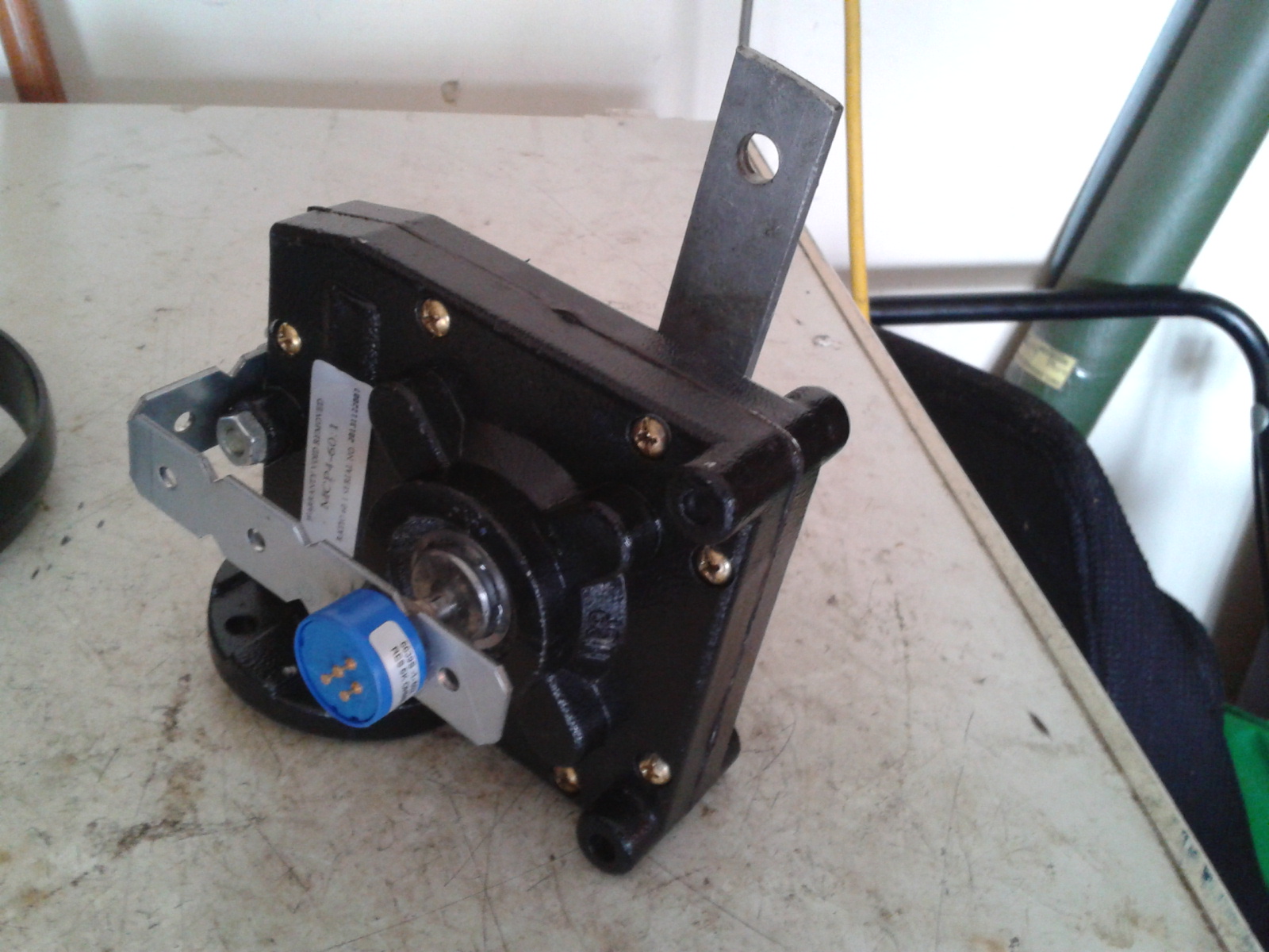

    Motors, http://www.motiondynamics.com.au/worm-drive-motor-12v-24v-200w-180-rpm-20nm-torque.html very strong, reliable and can be overdriven abut 2.5 to 3 times rated current with no problems, or look for ebay equivalent. With a 50mm ctc lever I think it moves at something like 500mm per second.
    Control boards http://www.pololu.com/product/1393/ , one per motor, 7 wires, one usb cable, no code to write.
    Feedback pots http://au.element14.com/bi-technolo...ll-0-2v-20v-to-10v-pin/dp/2319662?Ntt=2319662
    and put them into the back of the motor shaft like this

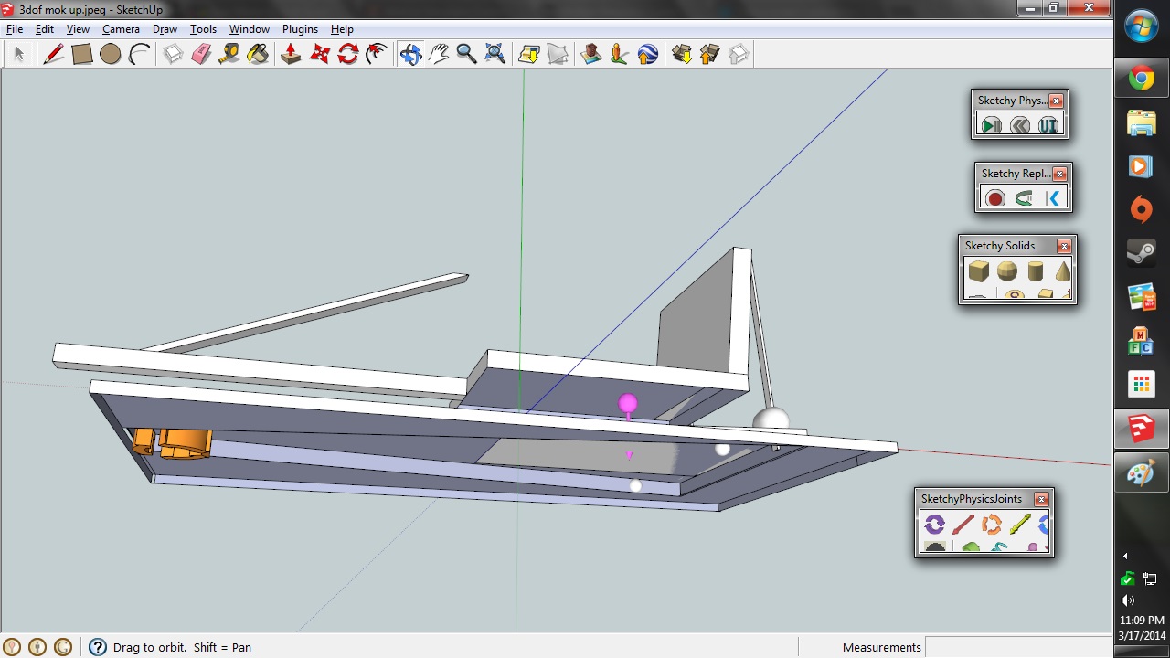

    i made a very quick mok-up using sketch up.
    but I dont know how to make it a jpeg

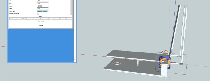

    I am just missing the sway motor

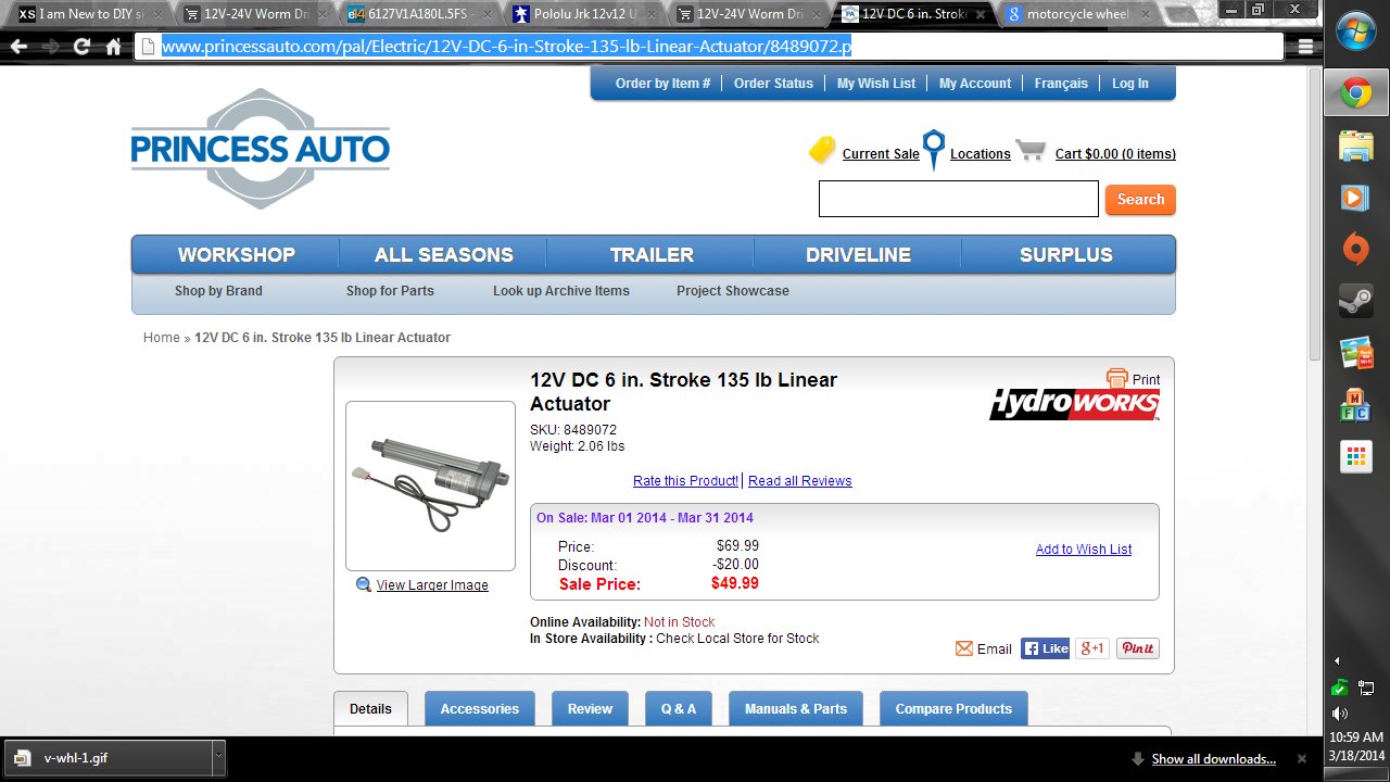

  11. Historiker
    2,159
    9,188Coins
    +2,160 / 19 / -1
    Hi James, that actuator moves painfully slow at 1 inch per three seconds. Acceptable movement varies heavily depending on whom you are listening to but generally faster is better.
