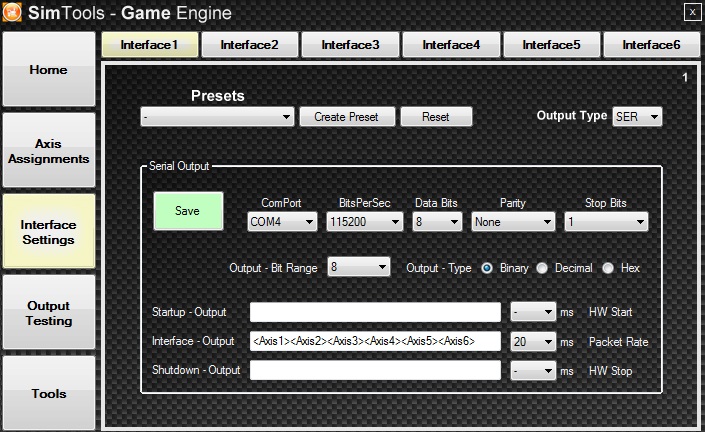

  5. MagicMike
    MagicMike New Member
    Jan 26, 2014
    24
    961Coins
    Sorry! :)

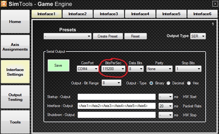

  6. prilad
    Apr 29, 2012
    380
    Dubna, Russia
    9,638Coins
    +512 / 1 / -0
    3DOF, DC motor, Arduino, 4DOF
    your COM port baud rates are different. 9600 in sketch and 115200 in SimTools.
  7. MagicMike
    Jan 26, 2014
    24
    961Coins

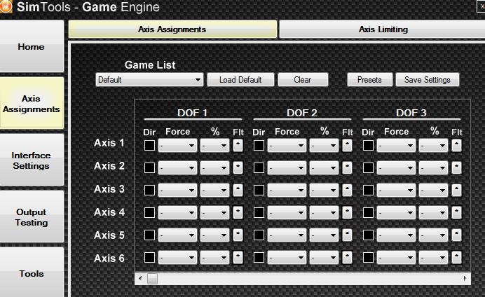

    Ok i have fix this error . Also this is another snapshot of Simtools

  10. prilad
    Apr 29, 2012
    380
    Dubna, Russia
    9,638Coins
    +512 / 1 / -0
    Try to change sketch like this (add "Serial.write(brightness);") and try to connect with Arduino by Serial Port Monitor in Arduino IDE
    You should receive correct data...
