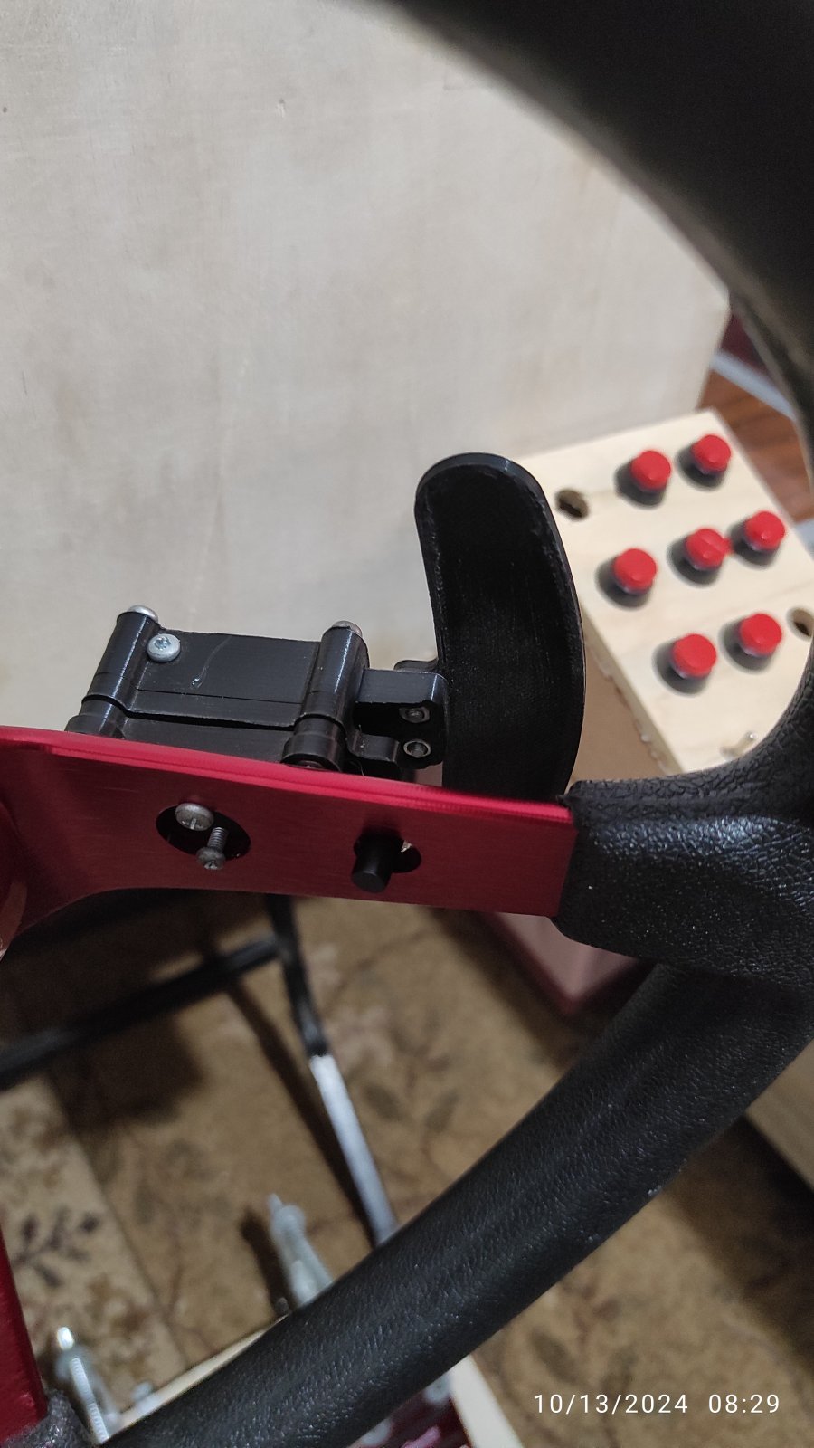

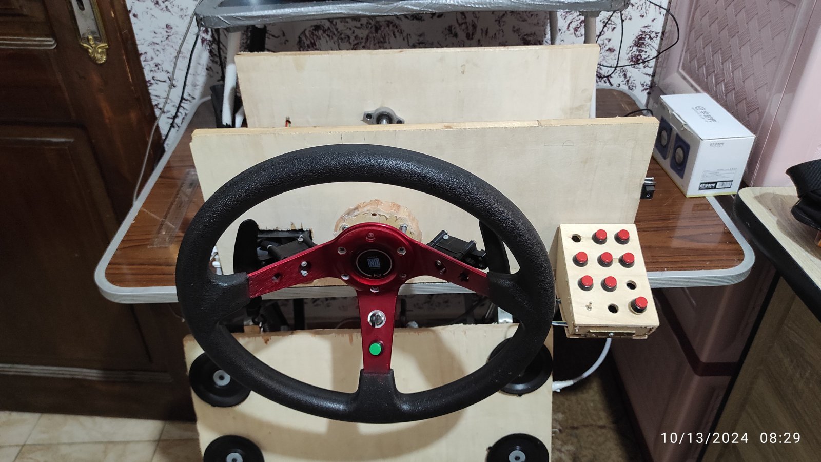

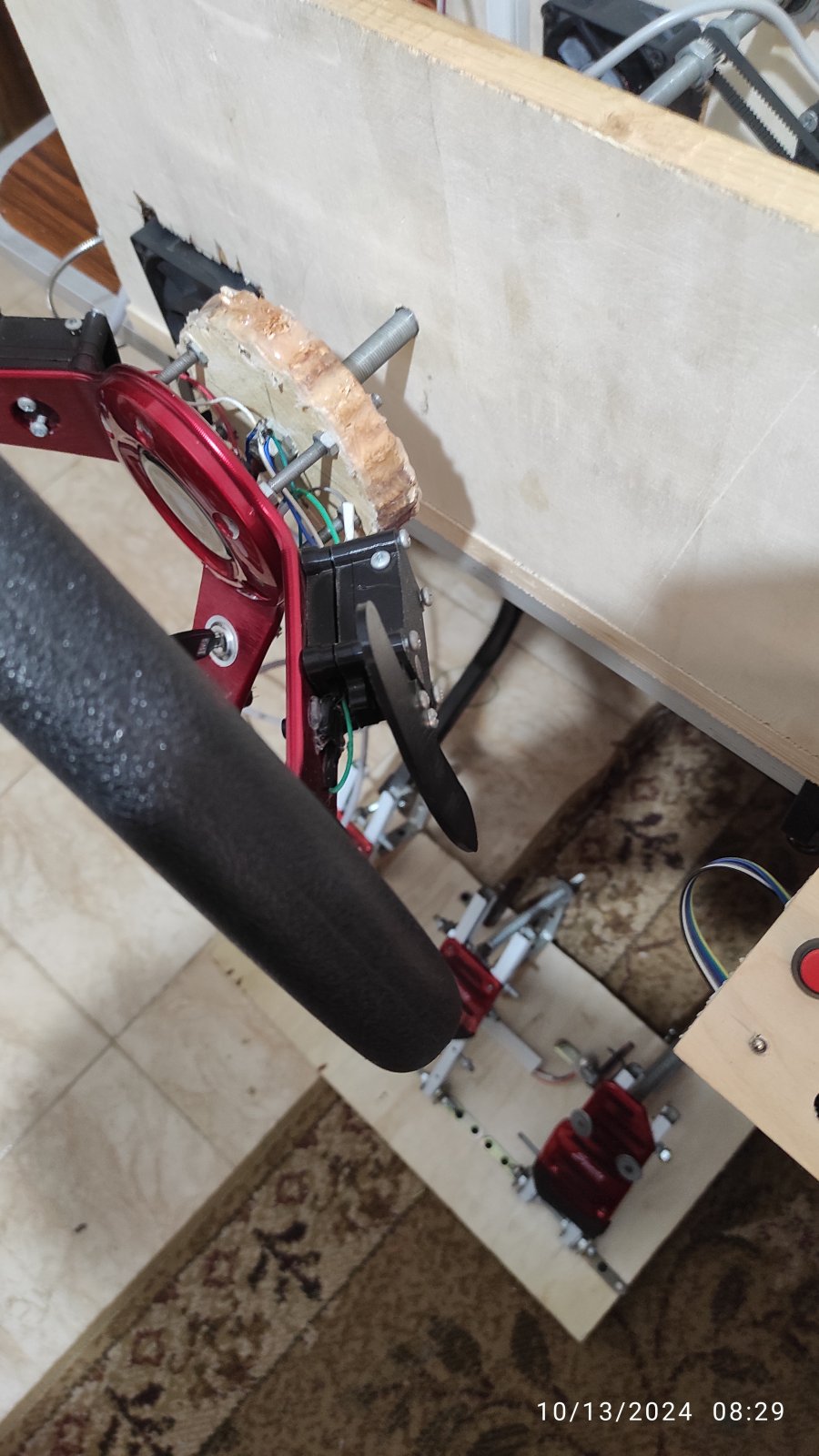

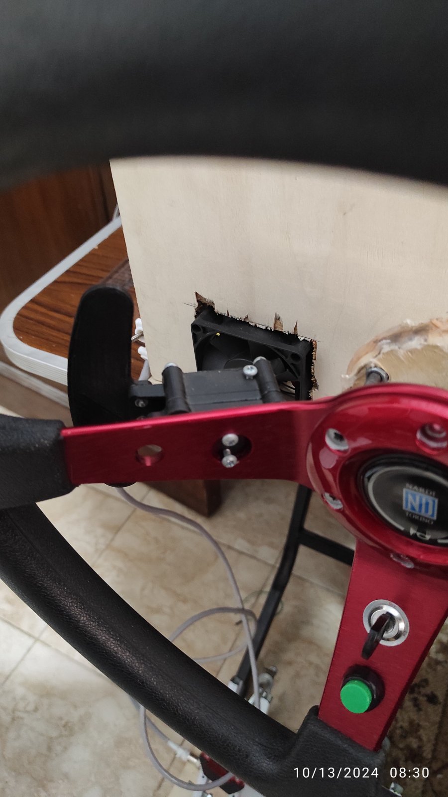

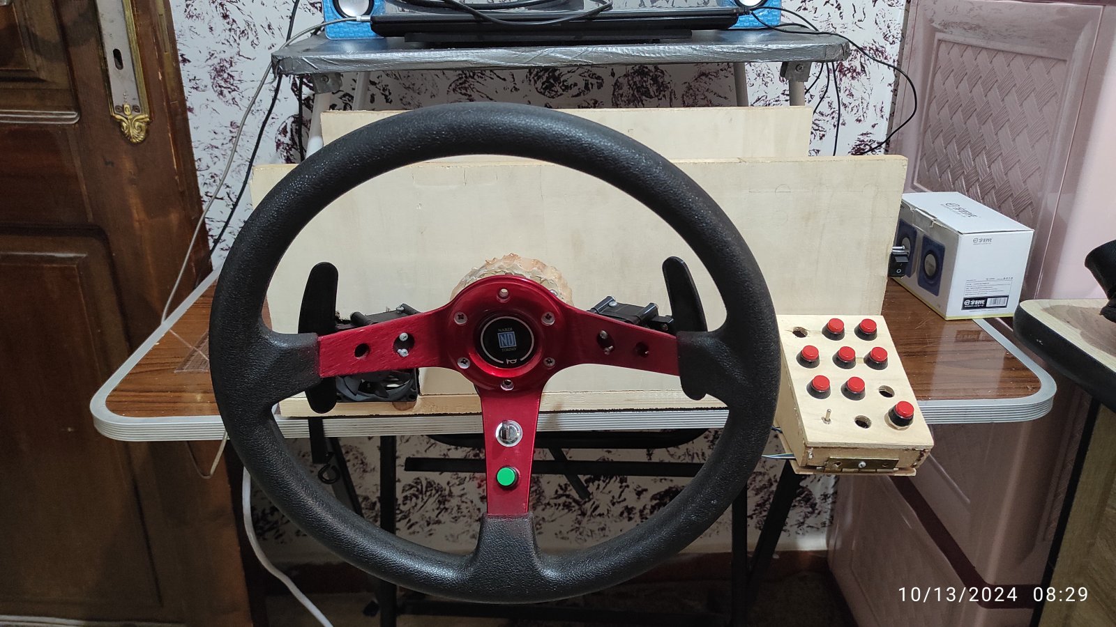

    Well, I built my own wheel base but the enclosure is made out of wood so it looks pretty bad so any ideas on what material should I use would be helpful and if you have photos I would appreciate uploading them IMG_20241013_082952.jpg IMG_20241013_082959.jpg IMG_20241013_082944.jpg IMG_20241013_083005.jpg IMG_20241013_082915.jpg IMG_20241013_082910.jpg

    It looks like the box could be slimmed down a bit vertically.
    If it works OK and you want a cheap aesthetic fix then enclose the wooden box and cover the box with heat shrink carbon fiber film.

    Thwere is adhesive film with any color and structure available. Wood, marble, metal... Google "d-c-fix" but there are many other brands.

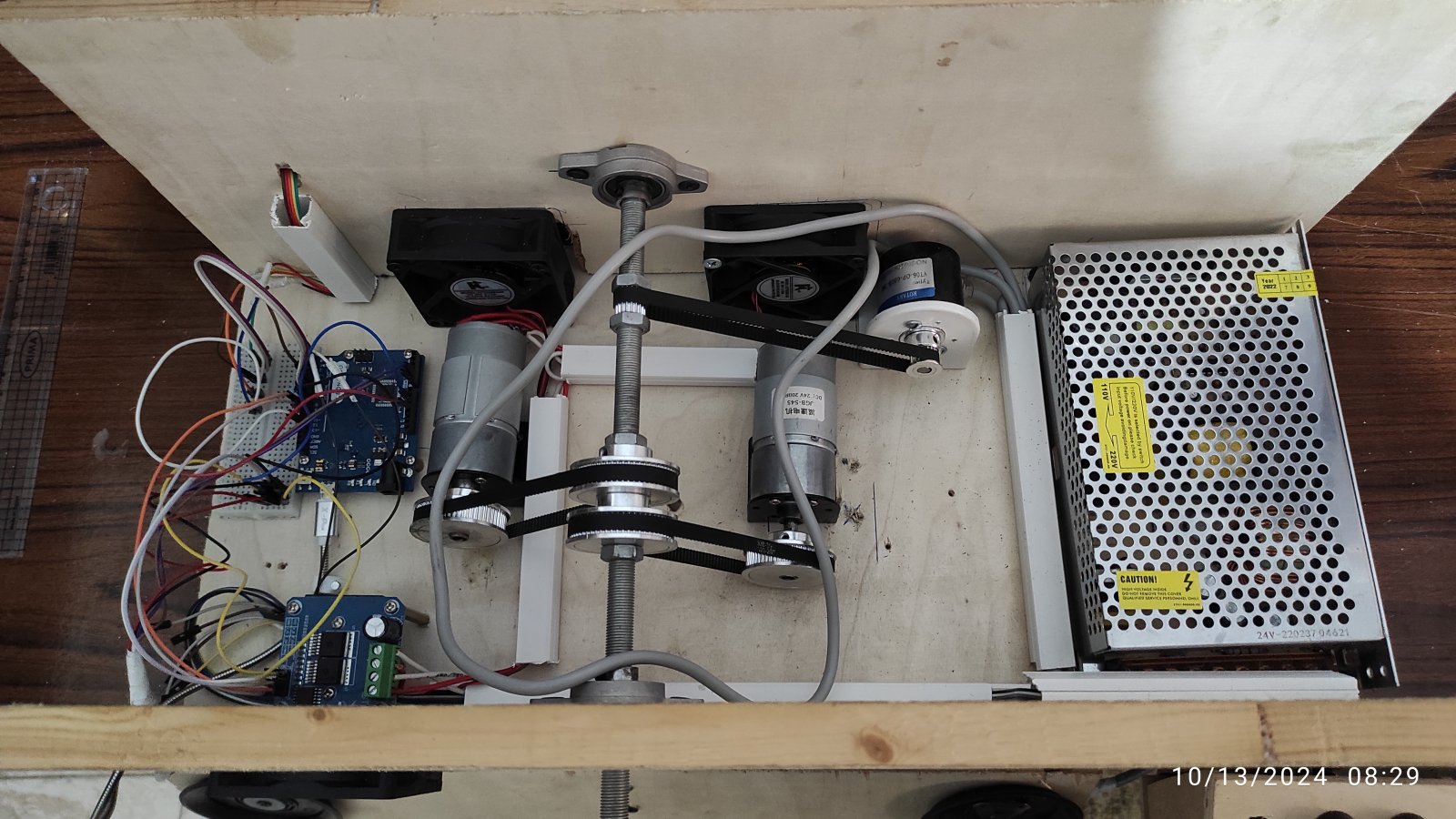

    BTW, why does everybody build FFB wheels with two motors? Because Logitec also uses two? But look at the gear ratio! The big toothwheel on the output shaft is around 20 times bigger than the tiny pinion on the motor shaft. That large gear ration contributes much more to the torque than the two motors.

    I used two because I couldn't find the motor I was looking for so I bought two other motors to have higher torque without losing the RPM

    If you run them in parallel on the same driver you actually don't get twice the torque because each motor runs only on half the current. Connecting them in series would double the torque.
    RPM is no issue. The motor can run multiple 1000RPM. Turning the wheel manually >100RPM is hard.

    They are already in series
    About the RPM the motor is only 100rpm so if I wanted to double the torque it would be 50 rpm only so that's why I used two motors

    Only 100RPM? Then the can in front of the motor (1/3 of the length) is a gearbox? Ok, I've overlooked that, sorry. Then your setup is nearly perfect.

    Hello there for the material instead of wood is acrylic panels stacked one over the other it's pretty strong that way.

    2. I usually just play for 1 or maybe 2 hours I don't face any heating problem but one time I was with my cousins so we played on it for about 6 hours straight at that point I used the fans it made the motors and the motor driver very cold
    3. EMC utility lite but planning on changing to ranenbg ( you can find it on gethub)
    The reason I find ranenbg's more you could say advanced like the moza software you can control everything but EMC there's only few things that you can control
    4.about the Nm I used two 24 kg.cm motors or 2.35Nm with 1:1 ratio so total of 48 kg.cm or 4.7 Nm ( planning on changing the whole motors in the future to make it DD )
