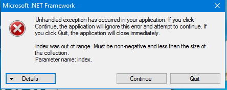

Bug i have an unhandled exception with simtools

  5. eaorobbie
    20,431Coins
    +1,684 / 23 / -2
    ? How did the error happen , what were you doing ?

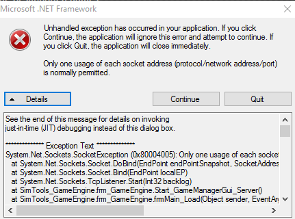

  6. yobuddy
    5,282
    49,199Coins
    +5,093 / 18 / -0
    The error says you using the same network socket twice.
    Can I please see your interface setup? (pic's would be great)
    Are you using a 2 PC setup where you maybe set the IP addresses?

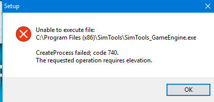

  10. yobuddy
    5,282
    49,199Coins
    +5,093 / 18 / -0
    Run game engine as an admin.

    i tryed unpatching and running as admin

  16. noorbeast
    21,030
    147,878Coins
    +10,880 / 54 / -2
    I think you need to start from scratch @marlon, it does sound like something is corrupted.
    Shutdown SimTools.
    Uninstall SimTools and say yes to removing old files.
    Check the SimTools folder has been deleted here, if it is still there then manually delete it: C:\Users\your_user_name\AppData\Local\
    Check the SimTools folder has been deleted here, if it is still there then manually delete it:C:\Program Files (x86)\
    Download a clean copy of SimTools from here: http://www.xsimulator.net/community/marketplace/categories/simtools.3/
    Reinstall SimTools.
    You will have to setup the Interface and Axis settings again for the SketchUp model you are using, see the pictures and instructions here: http://www.xsimulator.net/community/faq/how-to-animate-sketchup-3d-model-with-simtools.209/

    i think it my frame works boken
  18. marlon
    marlon Active Member
    Feb 27, 2016
    153
    1,058Coins
    +58 / 0 / -0
    it was my frameworks .net fixed it i used the clean up tool
