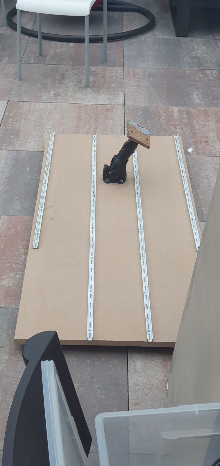

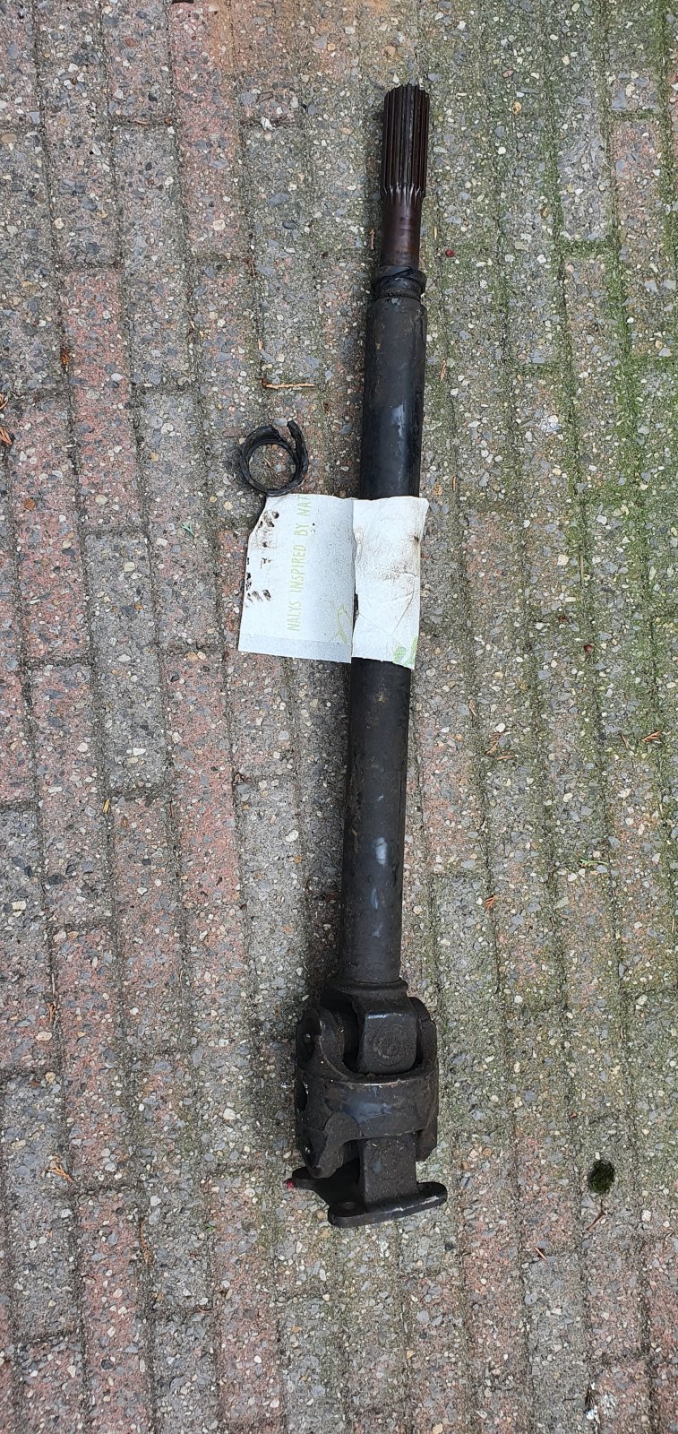

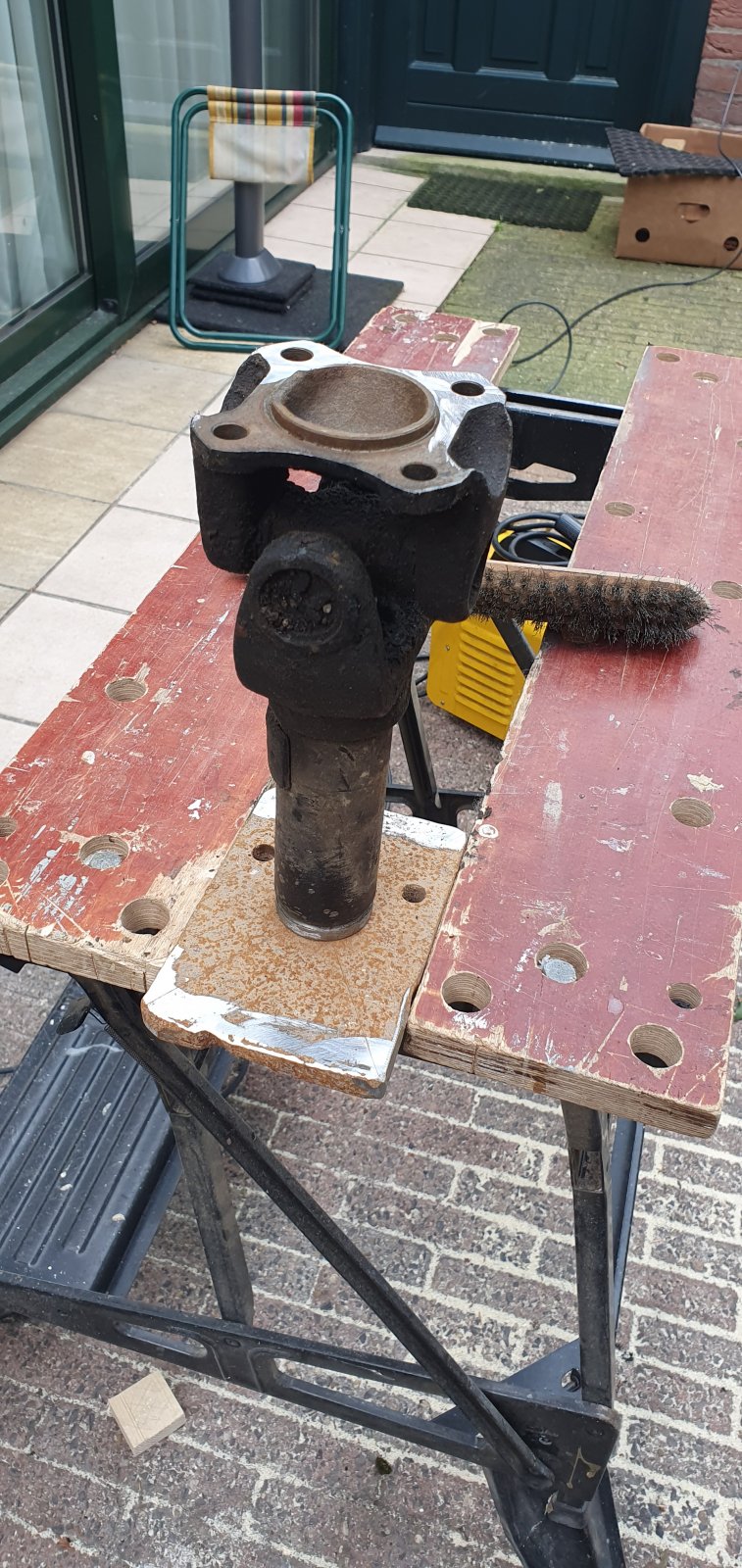

    for the center piece i used a cross section that was on top of a 4x4 axel from a jeep.
    with a bit of welding and help from my father i turned it into this :
    Then i first made a version to test how sturdy it was with mdf wood and some metal reinforcements :
    (it wasn`t ! the wood still bends when you sit on it with 95 kilo`s and thats even without the chair etc.)

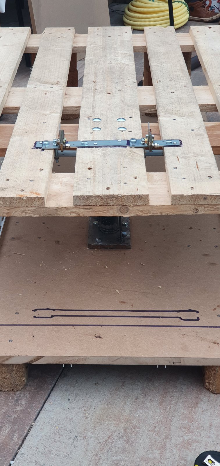

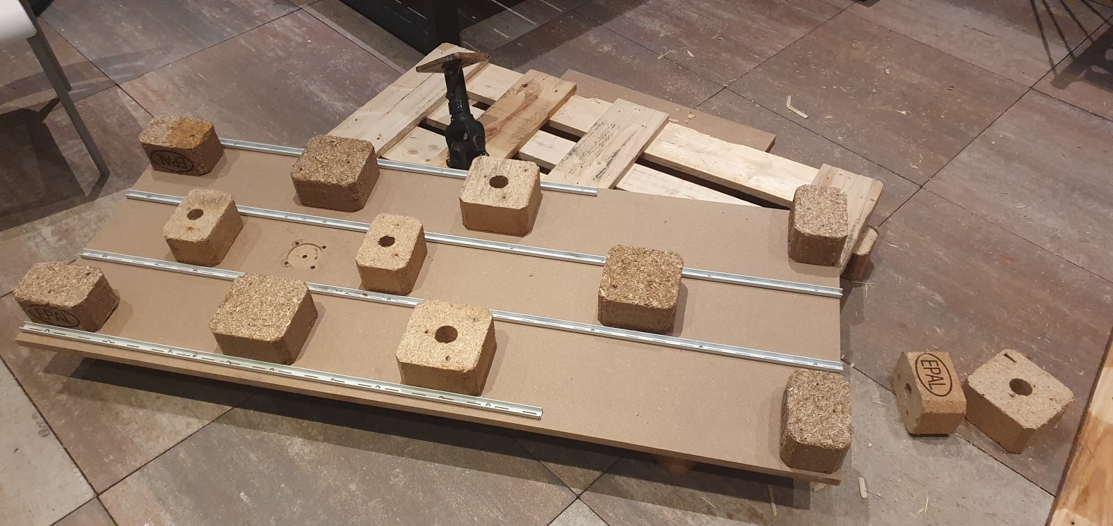

    i then got me some pallets from work, and salvaged the parts of it :
    added some planks on top also :

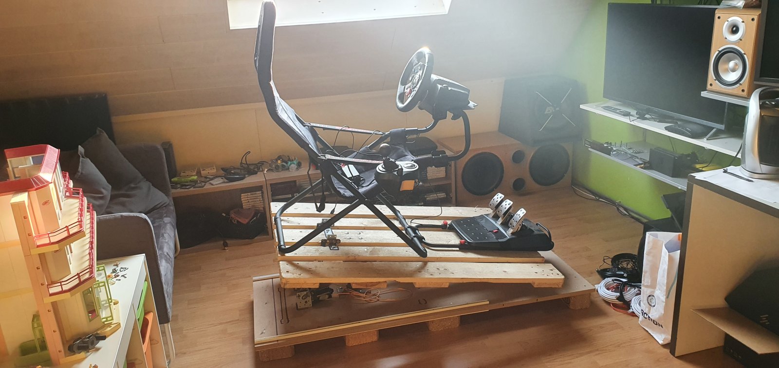

    And connected the mouting for the motor`s (im using 2 vw golf, bora wiper motors 12v 40watts each)
    of course the way it was mounted now it was WAY to heavy for the motors to carry or function proper.
    (was allot of fun for my daughter for the first test)
    i then removed the motor`s at the back and moved them as far as i could to the front.
    this resulted into the following.
    Problems that i had with my build :
    * the 180 degrees hall sensors where all out of stock, so i ordered 360 degrees versions
    - the range of the sensor was incorrect when mounted to the motors (i fixed this by changing the software for the arduino a bit and adding a scale factor to it)
    - the motors when mounted the second time where reversed but the software only allowed 1 reversed motor, i added the option to also reverse the other motor.
    the problem that i need to fix is the increase the power supply, because it`s only 8,3 amps and running into trouble when hitting the low ends of the motor.
    The adjusted file is a few posts below this one
