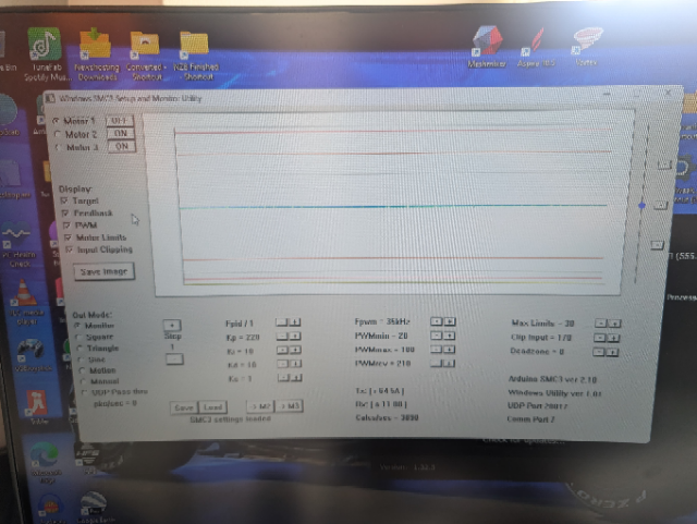

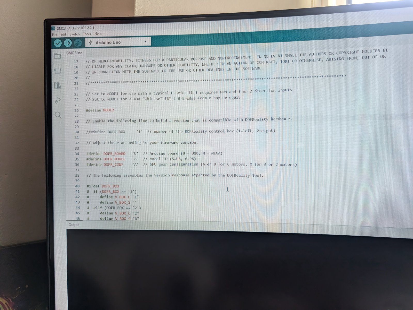

    Are you using SMC3 set to Mode 2, and if so can you please post pictures of all your settings.
    As an aside, some members have reported issues running the IBT2s at 24v and have more success lowering the voltage a little.

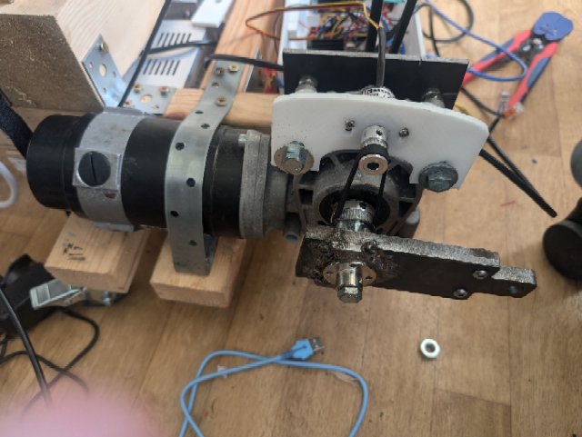

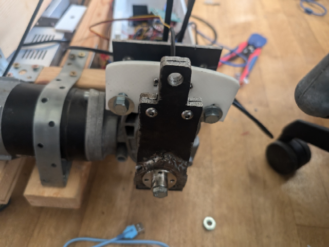

    Firstly remember I have had my rig running for over 6 months with no issues.
    I had a mechanical issue with the CV joint and had to modify the setup, however when I tried to get it going again it appeared dead.......

    I am running SM3 v1.0 and have set Mode 2

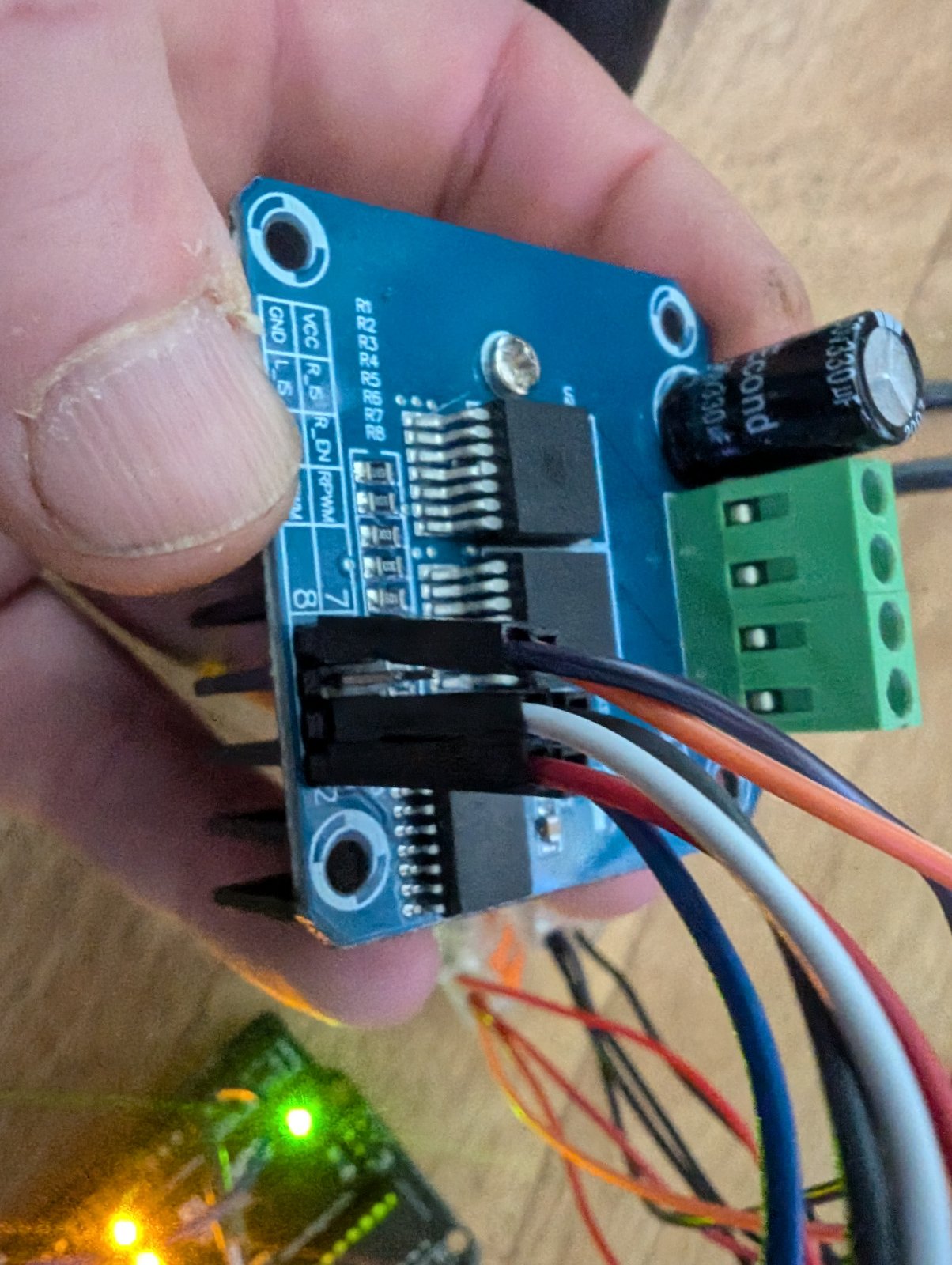

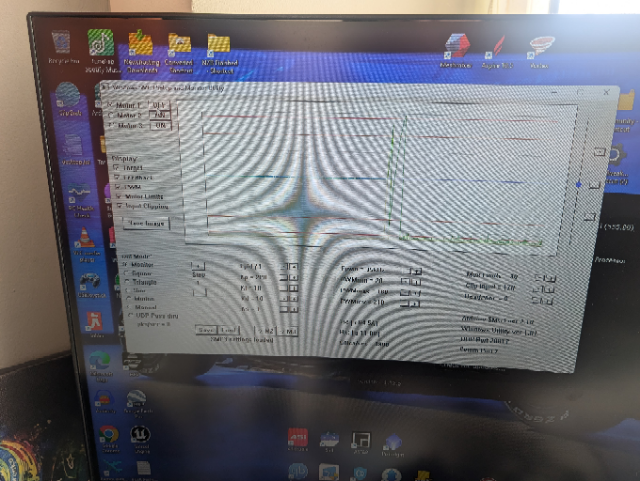

    Right, so found I had a dry solder, re soldered and motors up and running, however next problem, when powered on the motor just turns and hits it's limits, set the pot position, set the motor position but SM3 tool hasn't got full control.
    20,914
    147,200Coins
    +10,858 / 54 / -2
    I am having trouble reading those images, they are poor quality.
    Set Fpwm to 25.
    Initially set Clip Input and Max Limits to 200 until everything else is working as expected, then refine their settings.
    Worst case do the setup steps from scratch:
    Initial Setup
    8. Set Kp to about 400
    10. Do the above for each motor

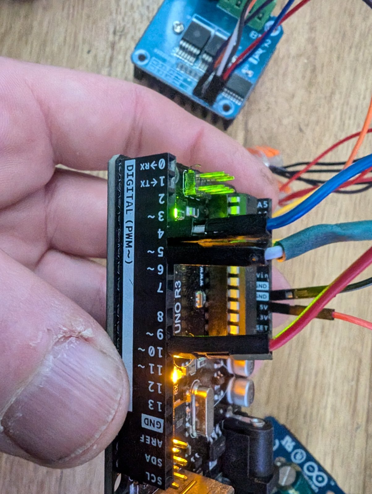

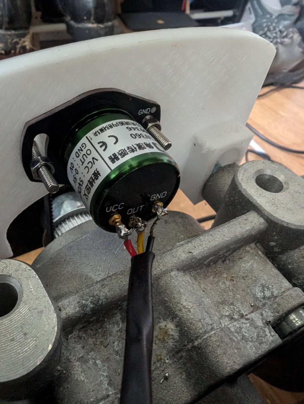

    Hi, please see YouTube video link, I have rewired, confirmed Comms, checked green line moves when turning Pot but as you will see no control just wants to spin, could the pots be duff?
  12. Richard Eaton
    Richard Eaton Member
    Oct 4, 2023
    88
    241Coins
    +11 / 1 / -0

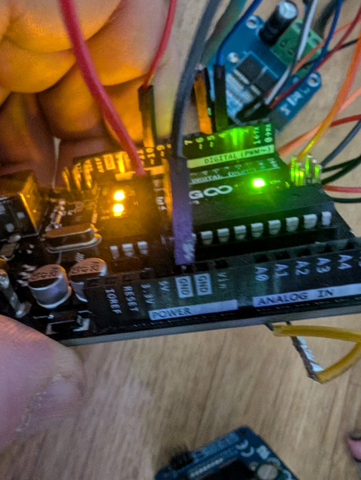

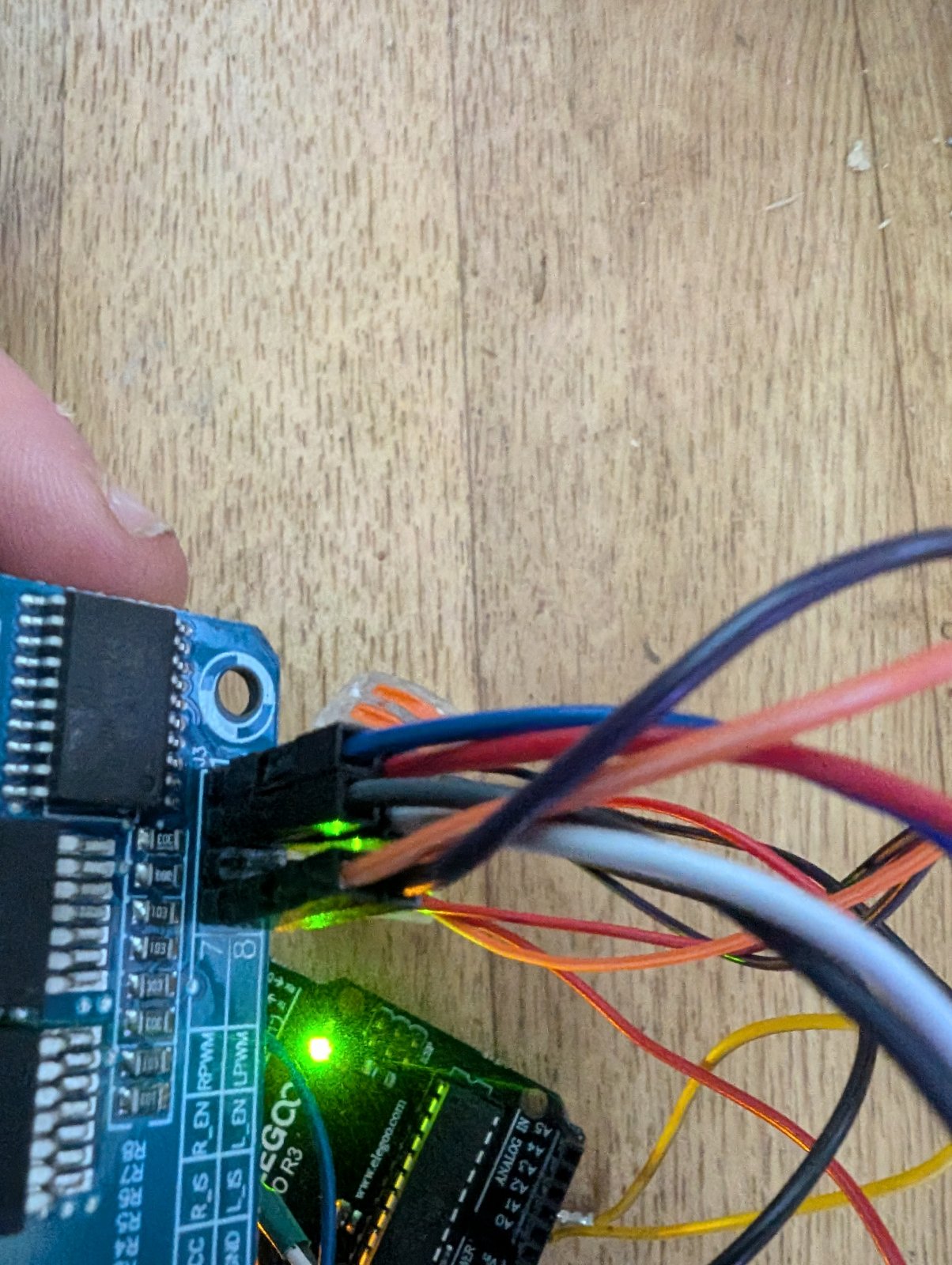

    I have now run out of ideas.
    New IBT-2
    New Uno R3
    Mode 2 {Also tried Mode 1 out of curiosity, same result)
    Turning the PID works, the green line moves
    If I remove the PID wire the motor just continuously rotates, which I believe is normal
    Set the PID to center
    Power on the motor, it tries to rotate still as if the PID wire wasn't attached, but hits cutoff limits and stops.
    Swapped over wiring so Motor 1 becomes Motor 2, same issue.
    Any ideas welcome.....I am stumped :-(

    What are your current settings and please post pictures.
    At what step in the official set up ptocedures fails?

    Disconnect the power to the motor pot and check the pot is centred when on.
  18. Richard Eaton
    Oct 4, 2023
    88
    241Coins
    +11 / 1 / -0

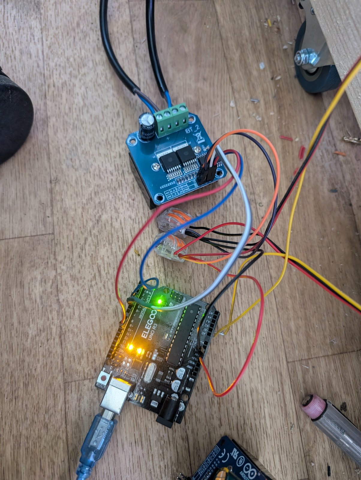

    Hi, so if I center the pot then close down SMC3 and disconnect the Uno, when the Uno is powered back on and SMC3 started the green line stays centered, the issue occurs when the IBT-2 is connected. Tried several IBT with same result.
  19. Richard Eaton
    Oct 4, 2023
    88
    241Coins
    +11 / 1 / -0
    Have setup both motors, and both are suffering the same issue, this seems to point to an issue with the Uno as that's the only part that's shared between both motors.

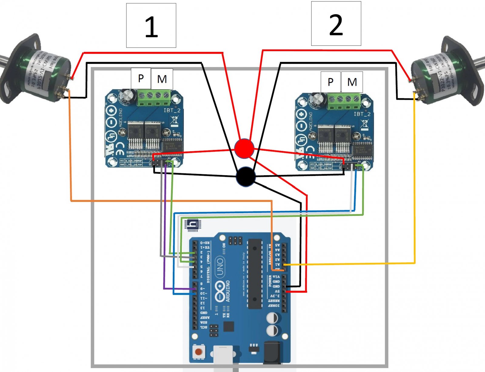

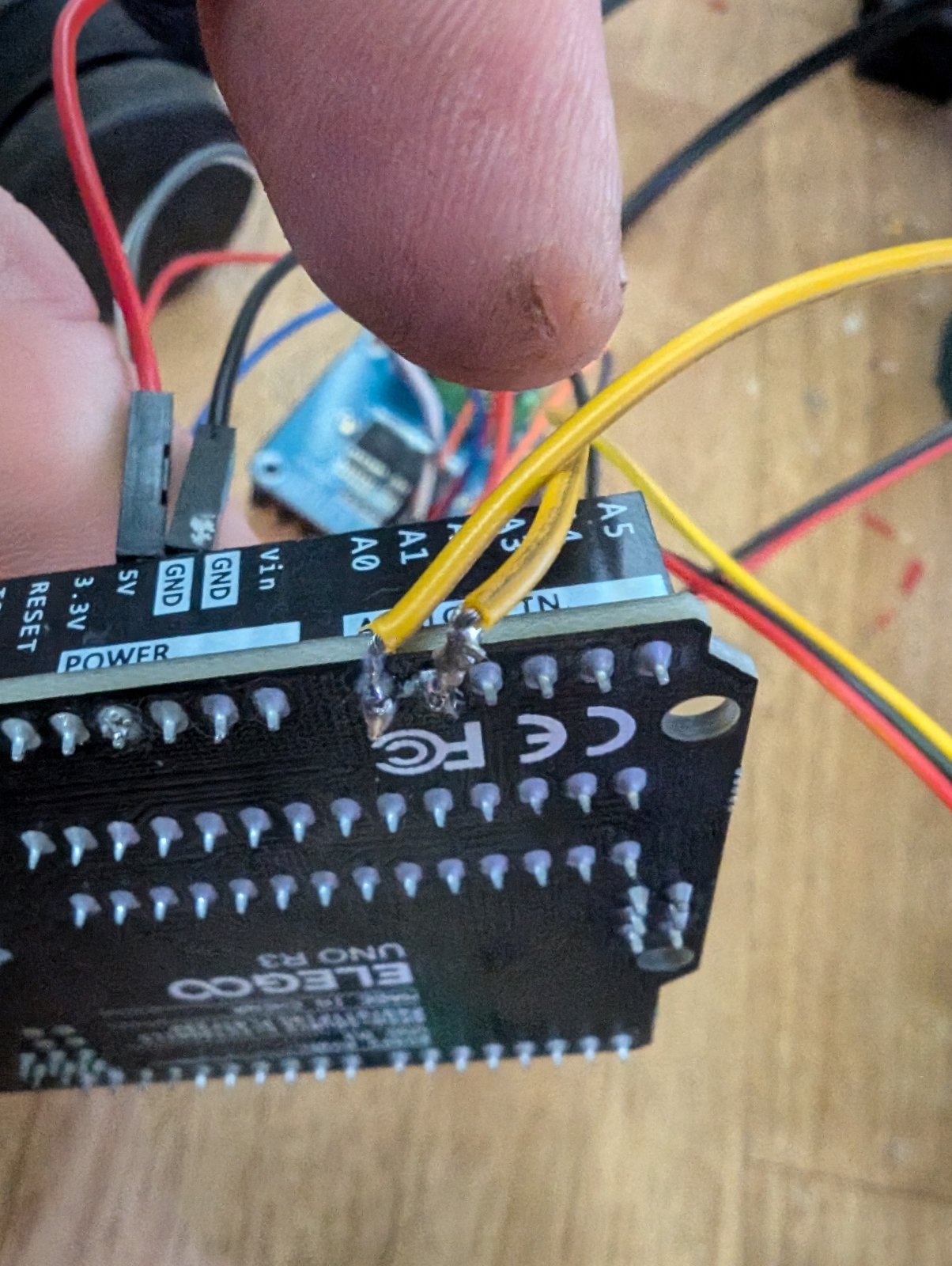

  20. Richard Eaton
    Oct 4, 2023
    88
    241Coins
    +11 / 1 / -0
    This is my own wiring diagram that was updated as I wired the uno/ibt.pot.
    Still doesn't work, as soon as the PWM wires are connected the IBT gets red hot instantly.
    New Uno, new pots, newish IBT, wondering if they are now cooked and I need new ones
