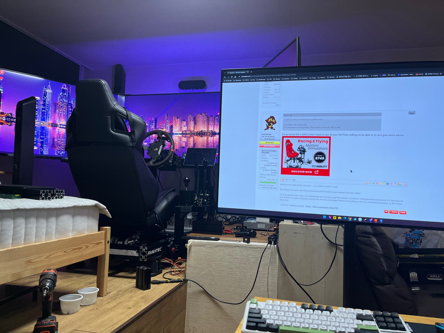

    First of all, I appreciate your interests and effort to solve my problem.
    I attached another video.
    As you can see I finished all setup.
    PC, Triple 50" monitors, Wheel, Pedal, everything except motion simulator.
    I can't enjoy sim racing because seat is detached from motion sim.
    I'm sure you are busy in real life but please help me.
    Thank you.

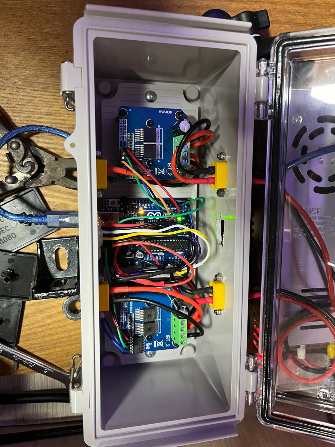

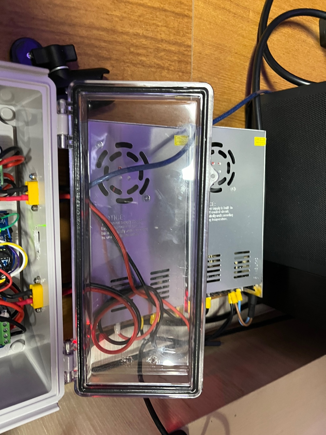

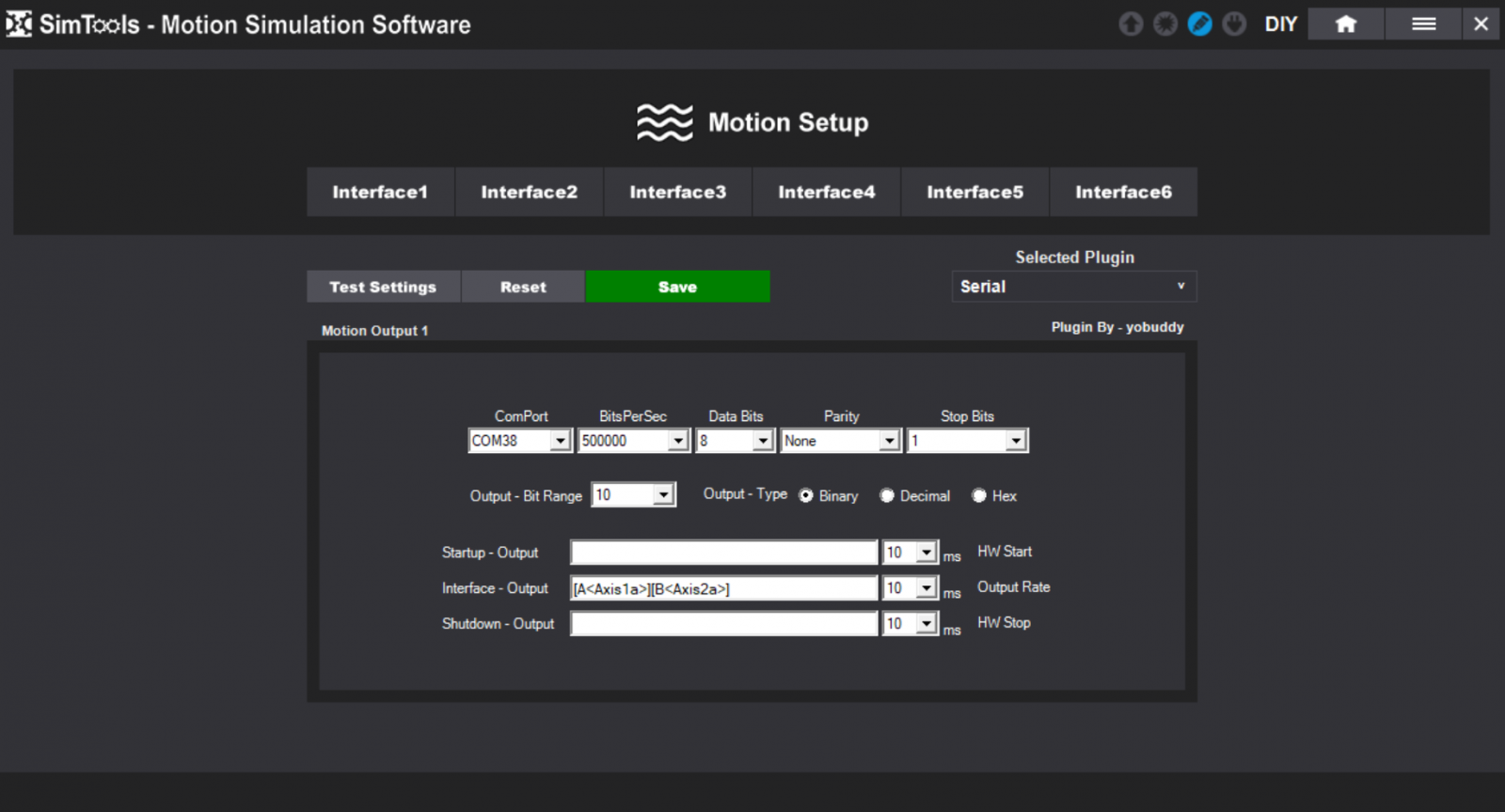

    I upload the pictures just in case.
  13. noorbeast
    21,030
    147,878Coins
    +10,879 / 54 / -2
    The pictures need to be of all of your settings, not the hardware.

    You can hear the error in the video, on SimTools startup (Beep, beep),
    My guess is interface cant start error in the error log.
    Is the smc3 utilities still running?
    But like Noorbeast said above, we need pics for your simtools settings to help.

    I uploaded the setting pic.

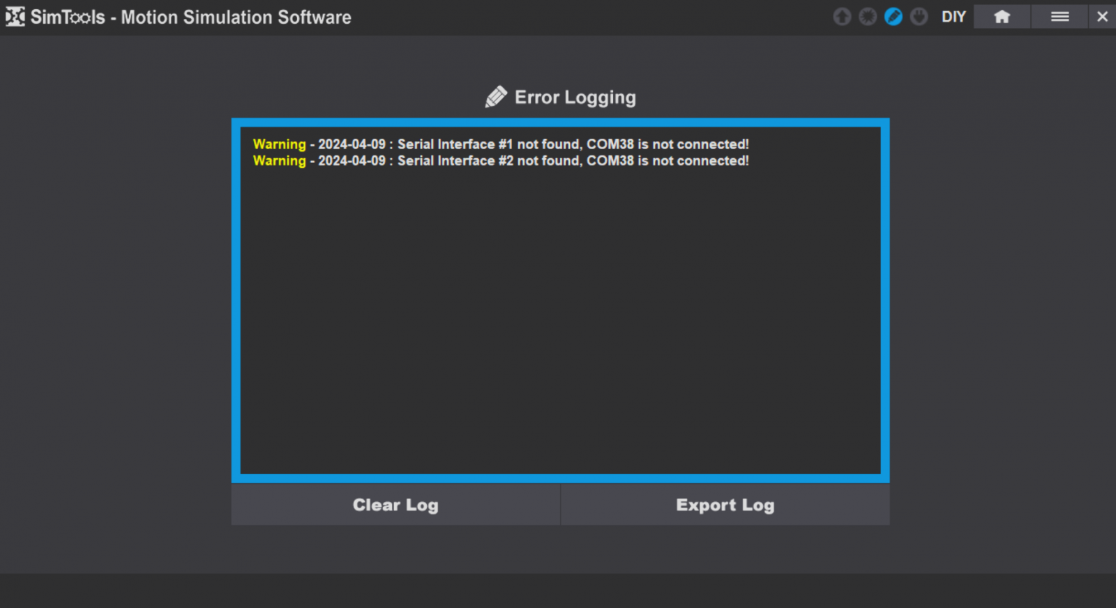

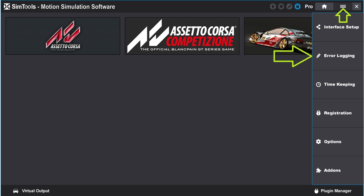

  18. noorbeast
    21,030
    147,878Coins
    +10,879 / 54 / -2
    As @yobuddy explained the audio sound is an error warning, likely an interface not initialising correctly.
    SimTools v3 has an error log, so please check it and post the full content of any errors:
  19. Brant
    Brant New Member
    Apr 3, 2024
    14
    Biz man
    S.Korea
    69Coins
    There's no error log except now I didn't turn on the motors.
  20. noorbeast
    21,030
    147,878Coins
    +10,879 / 54 / -2
    That looks like the com port is incorrect in your settings, double check in Device Manager.
