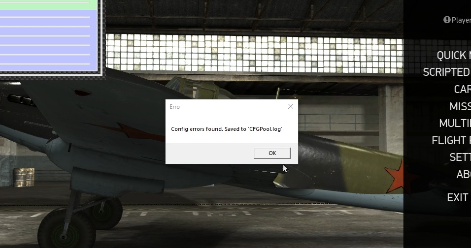

    Hi.
    My IL2 Battle of Stalingrad Blitz Edition Steam did not work.
    I did the patch. Game Running appears, but does not move any axis.
    Do I need to do anything in the game settings?

  11. Leandro Kemp
    Leandro Kemp Active Member Gold Contributor
    Oct 14, 2015
    161
    Brasil
    - 10Coins
    +33 / 0 / -0
    I've done all the profile settings and it still does not work.
    When I leave the game, an error message appears.

  12. value1
    Jan 9, 2011
    2,184
    Zug, Switzerland
    14,751Coins
    +3,322 / 11 / -1
    You might need to change a config file manually. I'll let you know when I'm back online.

  15. value1
    Jan 9, 2011
    2,184
    Zug, Switzerland
    14,751Coins
    +3,322 / 11 / -1
    There should be a file called startup.cfg in your installation directory.
    Add the lines
    Code:
    [KEY = motiondevice]
       addr = "127.0.0.1"
       decimation = 2
       enable = true
       port = 4321
    [END]

  17. Leandro Kemp
    Oct 14, 2015
    161
    Brasil
    - 10Coins
    +33 / 0 / -0
    It worked.
    Thank you.
