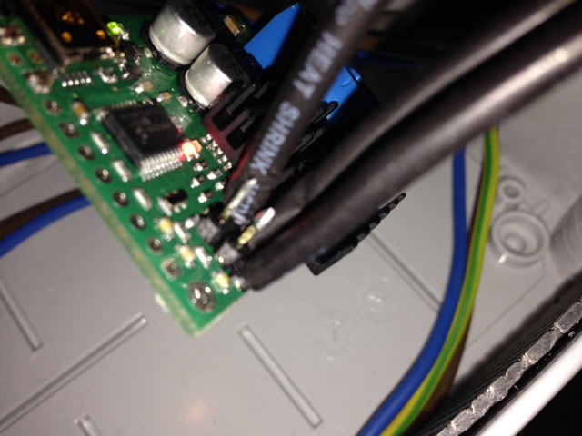

    can you take a photo or 2 of the boards to show us what you have done?
    I have some ideas, but would need to see the soldering job first in case there is something amiss

    @bsft , when you say boards, do you want pics of jrk's or my soldering on the power supplies?
  10. bsft
    JRKS

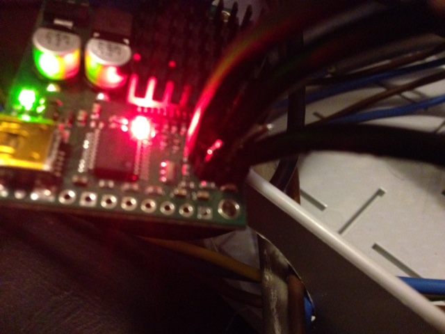

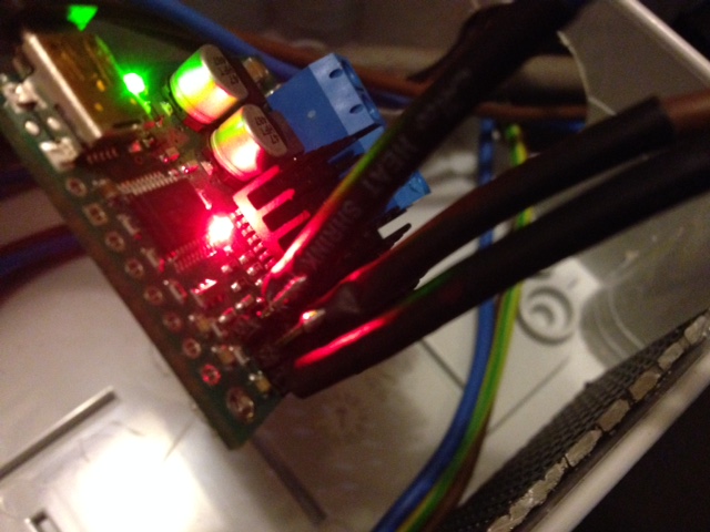

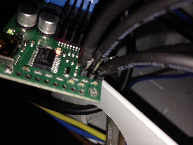

    IMG_0839.jpg @bsft, here is a pic of jrk. Will post one of the second
  12. Nicko321

  13. bsft
    Well I cannot see any obvious problems, so try using a car battery and test one JRK At a time
