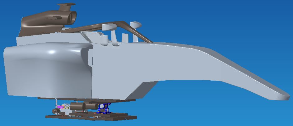

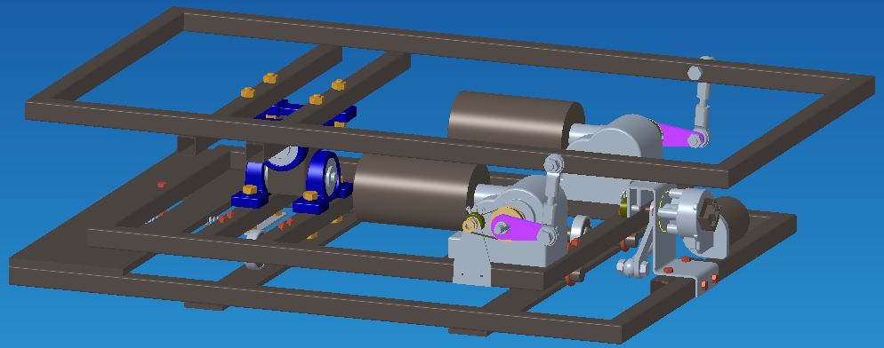

    Hi Guys,
    I just registered to become a member a few days ago. I got into sim racing 4 years ago, specifically with F1 sim racing. I'm always fascinated with the shape of Formula 1, it seems that it's out of this world. I enjoy building things on my own. I didn't want to spend too much money for the cockpit so I built my own cockpit, out of lumber and bought one of the cheapest steering wheel set from Thrustmaster. Later on, I got really hooked up with this F1 sim racing so I decided to buy me an inexpensive force feedback steering wheel. The rest is history. A few years later, I decided to build a look-a-like Formula 1 cockpit (my Avatar). Now, I want this cockpit to move with 2DOF and eventually I want to convert it to 3DOF. I watched several DIY You Tube videos how to build a motion sim and that's where I landed to this web site. I'm pretty decent designing and building things mechanically but I'm very poor when it comes to electrical/electronics and computer programming. I never heard of the "Arduino Uno" before, until several months ago. I just built me a platform under budget with two 24 volts wheelchair motors. Hopefully, it's robust enough for my F1 cockpit on top of it. I got me a cheap after market Arduino Uno and some H bridges and other materials to make this platform to move. I think I have everything I need so far. I'm getting ready to put together the wiring soon by following the diagram that I found in this website. Also, I just downloaded the free Simtools app, right after I signed up couple of days ago. Eventually, I'm planning to purchase and download the unlimited access, if everything goes right with this free Simtools that I have now. I have attached a picture of my cockpit on top of the platform tat I made in CAD. The platform is designed as 3DOF but the 3rd motor platform can be easily removed to become 2DOF. Should I go ahead and start 3DOF now instead of 2DOF? I assumed the weight of the cockpit maybe the issue but who knows. The cockpit weight approximately 75 lbs. My weight is 165 lbs. The platform is made out of mostly 1 inch square steel tubing. The pivot (universal joint) is made out of 4 bearing pillow on 2 inch square steel. I think my platform is pretty robust to carry the 250 lbs. weight. I'm open for any suggestions. Thank you!

    Just keep in mind some other members have reported issues when using a clone Arduino with SMC3, if that is what you plan.
    Given you plan a F1 cockpit anyway, that will take up a significant footprint, you may want to consider increasing the inherent leverage of your motor placement, as moving the motors further from the pivot will decrease the load on the motors.

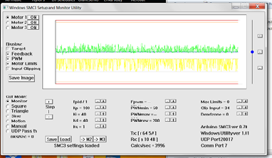

    Thanks again Radje! I got the genuine arduino and using IBT-2 on each motor. I assumed the arduino is working fine. Now, when I started running the SCM3 utility and turn on the motor one at time, the motor is shaking right away.

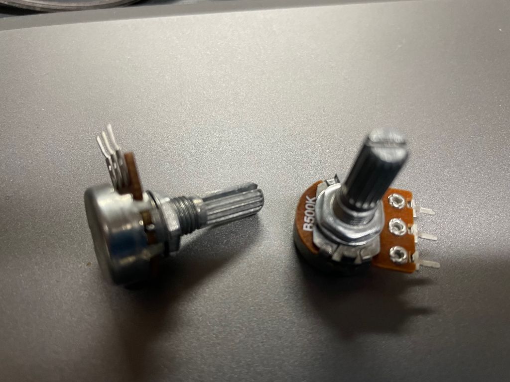

    Maybe this has something to do with what type or what size potentiometer I need? What do you think? I have a short video on the motor shaking but for some reasons I could not upload the video. I'm still learning how to maneuver this Forum.

    10k pots or 180 Hall sensors are the norm.
    The SMC3 image is too small for my old eyes to read, but it looks like pwmmax is not set and that is the first tuning value that should be.
    One the pots are sorted please follow the SMC3 setup steps and report what pwmmax value the motors start to move:
    8. Set Kp to about 400
    10. Do the above for each motor

    Thank you sir! Next time, I will make the SCM3 utility picture larger. Anyway, I just ordered the 10k pot. I heard that the typical 10k pot will wear out fast. So I decided to order the hall sensor as well. Unfortunately, the 180 hall sensor will not arrive until the mid April from China. I can wait to proceed this project so I decided to get the 360 hall sensor, instead. I wonder is the 360 hall sensor will work as well. Please advise.

    The 360 will have a lower resolution than the 180 Hall sensor. Technically a 90 degree Hall sensor would work with high resolution as long as total movement was under 45 degrees either way, but that is not a lot of head room, which is why 180 degrees is the norm.

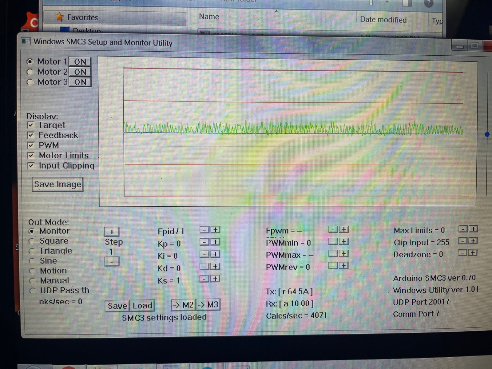

    I hope the picture is readable now. Anyway, I put all the values to zero and Clip input to 255, while the motor is off. Then I turn on the power on motor and motor still shaking. Also, may I ask why there is no value on Fpwm and PWmax before I turn the motor? Also, I'm still using the 500K pot anyway. I'm still waiting for the 10k pot and 360 hall sensor to arrive.

    In the the SMC3 instructions I posted earlier the start values are Clip to 255 (you need to do this first) and Limit to 255, set Kp to about 400, then slowly raise PWMmax and note at what value the motors start to move.
    But you need to have the appropriate hardware in place.
