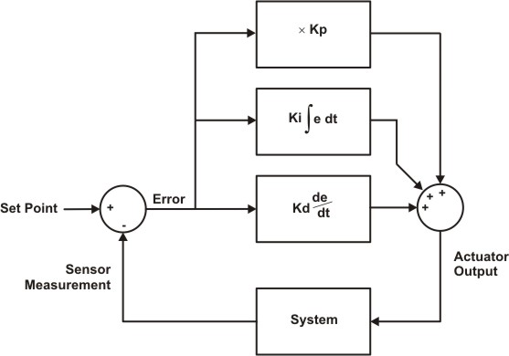

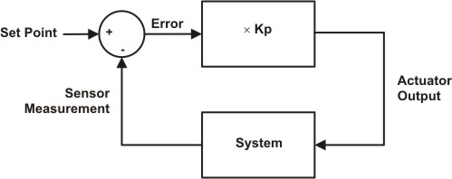

    More analysis on what each term does in graphics representations:
    The Proportional Control Loop

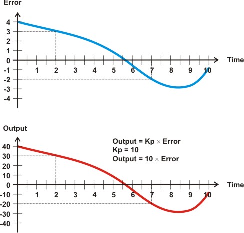

    Proportional control is sufficient for some systems. A block diagram for proportional control is shown in next Figure. The circle on the left is called a summing junction, and it shows how the measured sensor value is subtracted from the desired sensor value (the set point) to calculate the error. This is the error that needs to be corrected by the control system. Proportional control attempts to correct this error by multiplying it by some constant value (Kp). The resulting actuator output exerts a correcting influence on the system. By definition, this influence is proportional to the measured error. Since the actuator output has some effect on the system, the sensor value is checked again, and the whole process is repeated, over and over again to maintain the level(s) in the system.
    The next figure shows a graph of the change in some error measurements over time. Notice how the error is 3 in the sample at time = 2. Since Kp is 10, the output is 30. In the second sample at time = 7, the error is -2, so the output is -20.

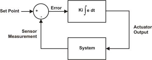

    Integral Control
    Proportional is just one way to react to an error in the system. The problem with proportional control is that it can't detect trends and adjust to them. This is the job of integral control.

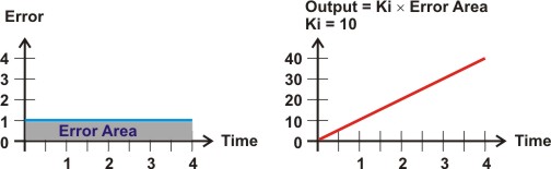

    There is another example graph of the error in a system over time on the left of the next figure. Again, it might be the distance of a robot from an object, or it could be fluid level in a tank, or the temperature in a factory oven. Perhaps the target the robot is following keeps on going away from the robot at a speed that the robot isn't catching up with. Maybe the oven door seal is worn; maybe the fluid draw from the tank is unusually large. Regardless of the cause, since proportional is not designed to react to trends it can't detect and correct the problem. That's where integral control comes into the picture.
    Integral measures the area between the error values and the time axis. If the error doesn't return to zero, the area of the error gets larger and larger. The right side of next figure shows how the integral output can react to this kind of trend. As the area between the error curve and the time axis increases, the output increases proportional to this area. As a result, the output drives the actuator harder and harder to correct the error.

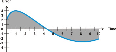

    So what happens when the error isn't a straight line, like the curve shown in the next figure? That's what the calculus operation of integration determines, the area between a curve and an axis. In the case of integral control, as more time passes with an error, the area under the curve grows, and so does the value that the integral calculation will use to drive against the system error. If the error curve drops below the time axis, the buildup of negative area subtracts from the buildup of positive area. When tuned correctly, integral control can help the system home in on an error of zero.

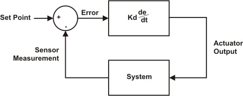

    Derivative Control
    Here's a situation that neither proportional nor integral control really deal with. It's rapid changes to the system that come from an external source. Keeping the system steady when outside influences are making it change abruptly is the job of derivative control. In calculus, derivative is an operation that measures the rate of change of a curve, such as the error curve shown in the next figure. By taking action based on the rate the error is changing, the output drive can respond rapidly to disturbances to the system.
