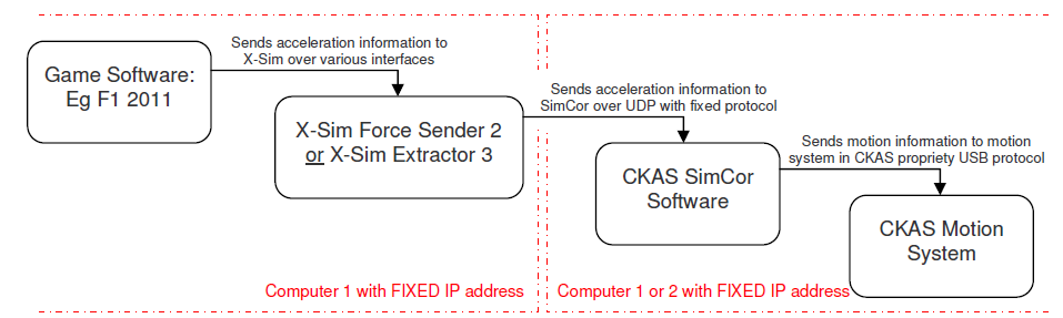

    I know that CKAS's software works with the X-Sim Extractor with no modification from X-sim needed; I just need to enter the IP address of where SimCor software runs (same computer in my case).
    I assume that the X-Sim output data stream is then read by SimCor.... so, again from a completely lay-person perspective, I was hopeful that this output is somewhat standardize telemetry that programs such as SimCor would implement into motion.

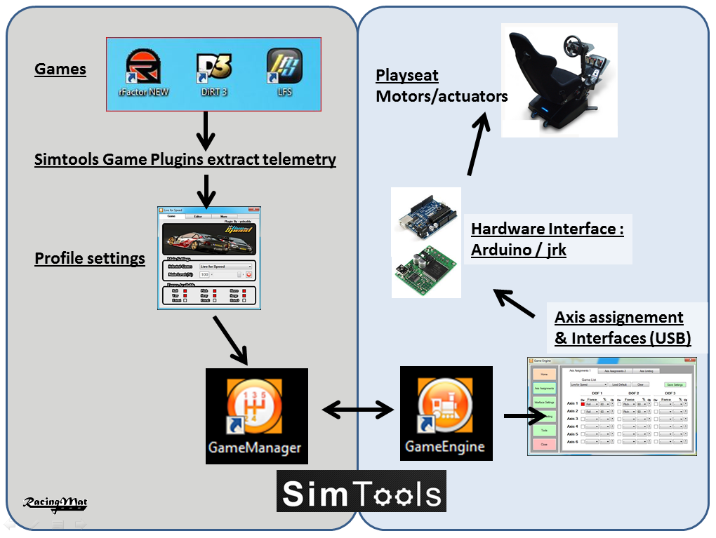

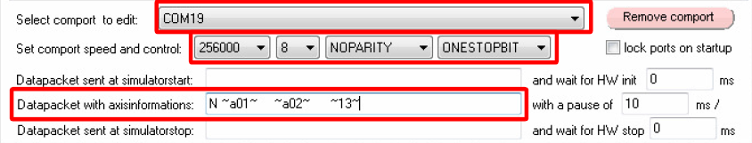

  4. RacingMat
    2,236
    20,963Coins
    +2,089 / 21 / -2
    yes, it's the same principle
    Normally any interface with X-sim can be translated easily in Simtools (USB or Ethernet), you just need to use the correct syntax.
    Post screenshots of your Xsim interface setup, we'll tell you what to use in Simtools.

    So with X-Sim, the only interface setup I need to do, generally, is enter the IP address of my system and it connects with my SimCor (CKAS's interface between X-sim and the motion hardware).
    Here is a link to the CKAS manual which discusses interfacing the SimCor with X-Sim:
    https://1drv.ms/b/s!As2pBWO_84FVgY8HDoWOGctN0lDQ7Q
    I spent the weekend trying to get SimTools to connect to the SimCor software but had no luck.
    Hopefully if you have the time to look at the linked PDF, you might see something that would help to get SimTools connected.

  6. RacingMat
    2,236
    20,963Coins
    +2,089 / 21 / -2
    To drive a 6DOF CKAS:
    but there is a lack in the documentation about UDP protocol awaited by SimCor.
    You should ask them about this. We'll figure out this. Maybe @yobuddy would help on the next step?​
    To drive a 2DOF CKAS, it looks rather simple:
    This method only works with a CKAS 2DOF (2 degree of freedom) Motion System (such as the T2s, T5 or T10) because X-Sim cannot handle specific complex inverse
    kinematics calculations to translate complex motion system geometry into individual actuator movements.
    try to convert these axis into Simtools syntax: ~a01~ into <Axis1a>
    values shown are appropriate for CKAS T2s, may need to be adjusted slightly for other motion systems through experimentation​
  7. yobuddy
    5,282
    49,202Coins
    +5,093 / 18 / -0
    SimTools equivalent is:
    N <Axis1a> <Axis2a> <13>
    (if the spacing is correct, looks like one space after the 'N' and 3 after the rest?)

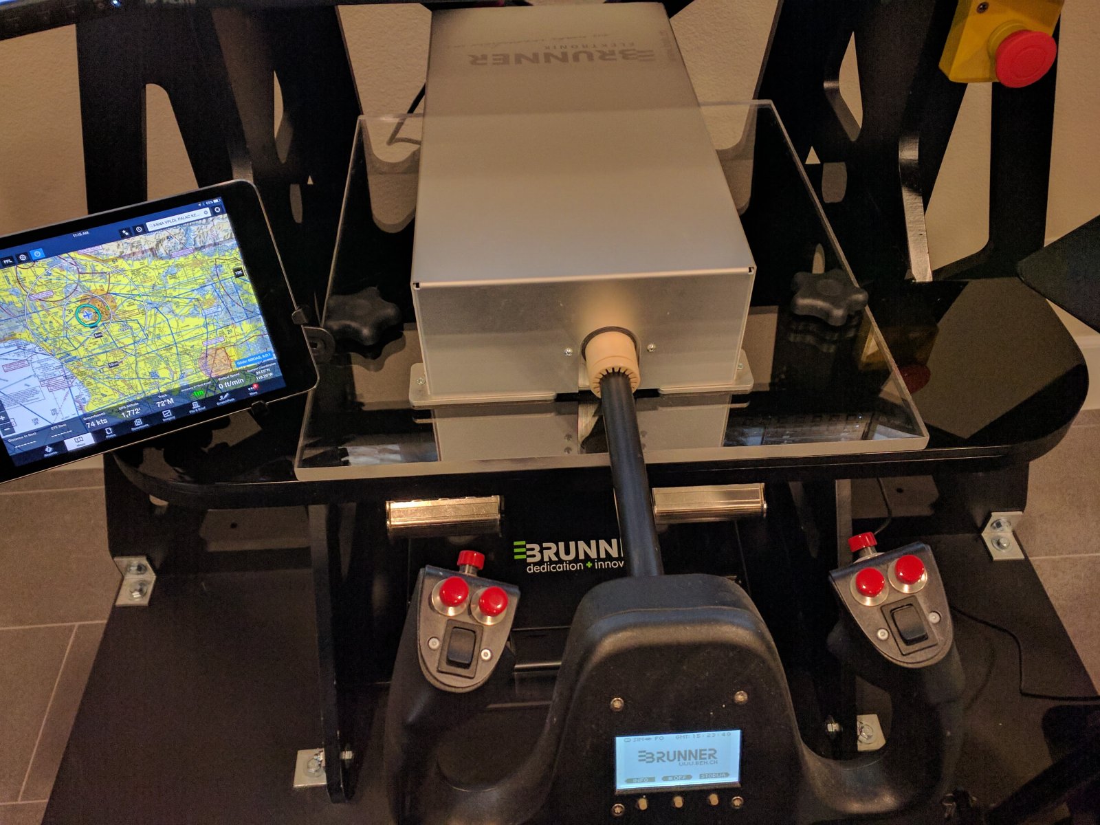

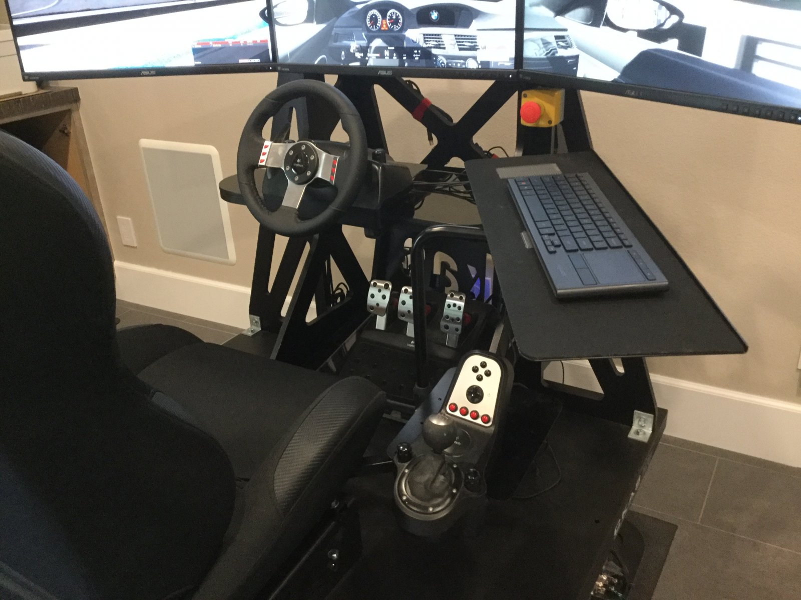

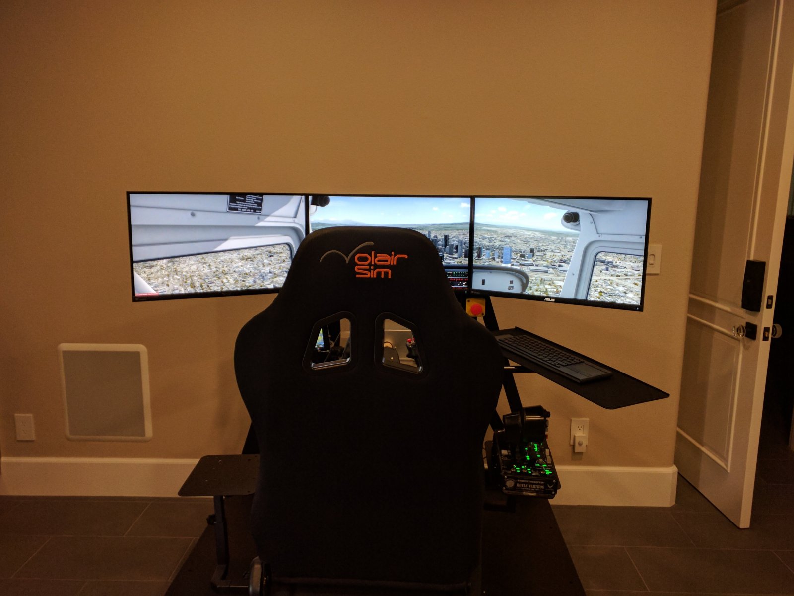

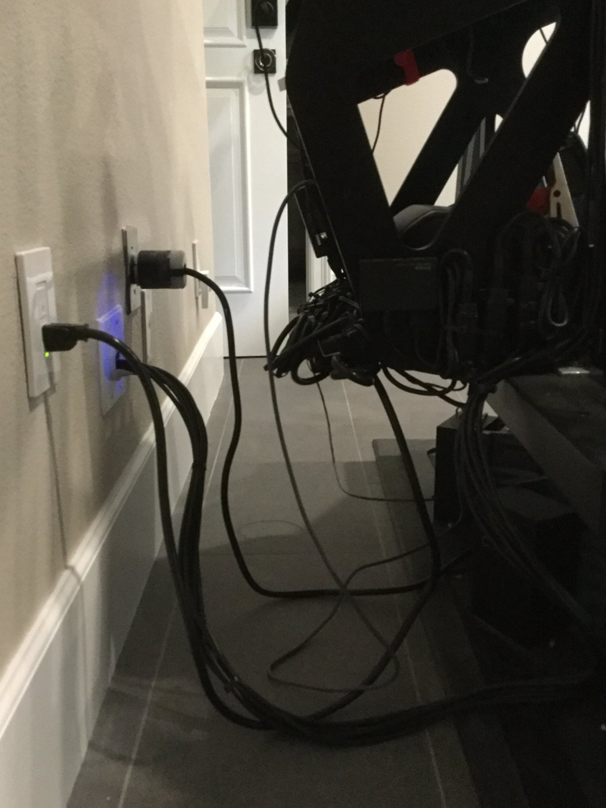

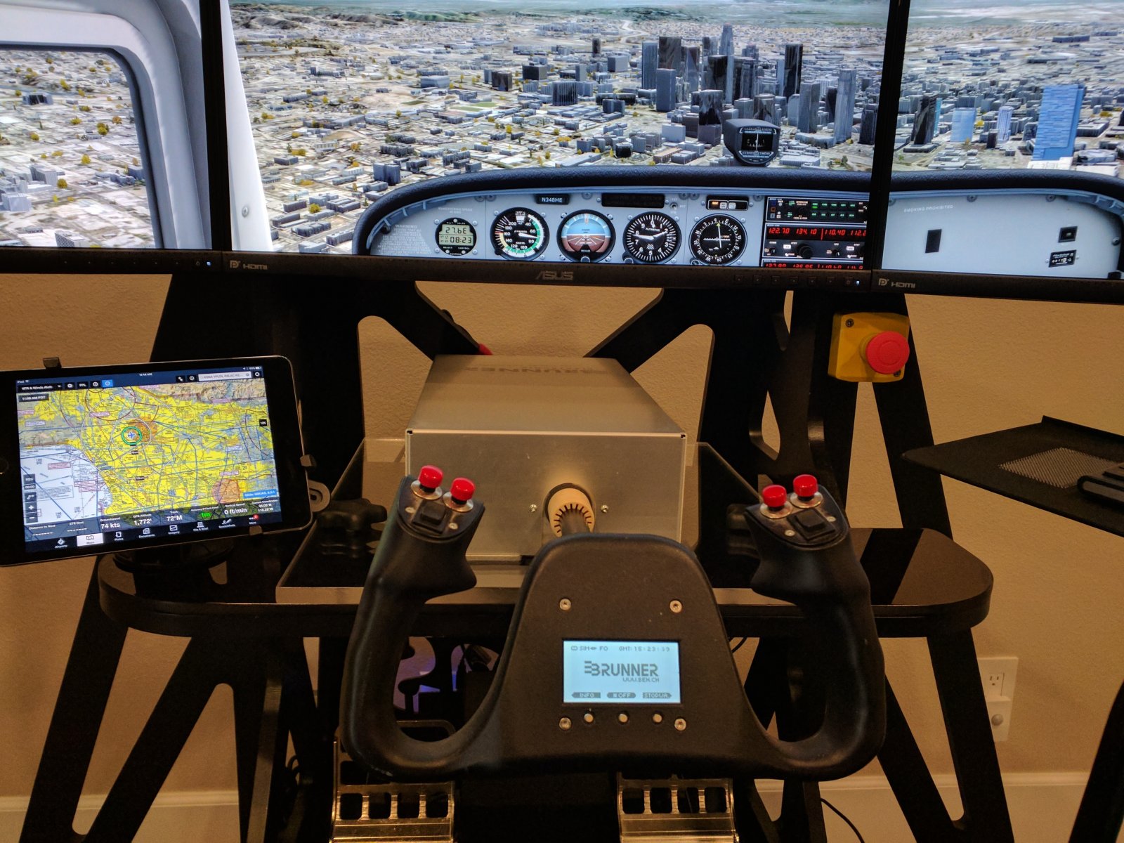

  10. wazooda
    wazooda New Member
    May 27, 2016
    11
    United States
    394Coins

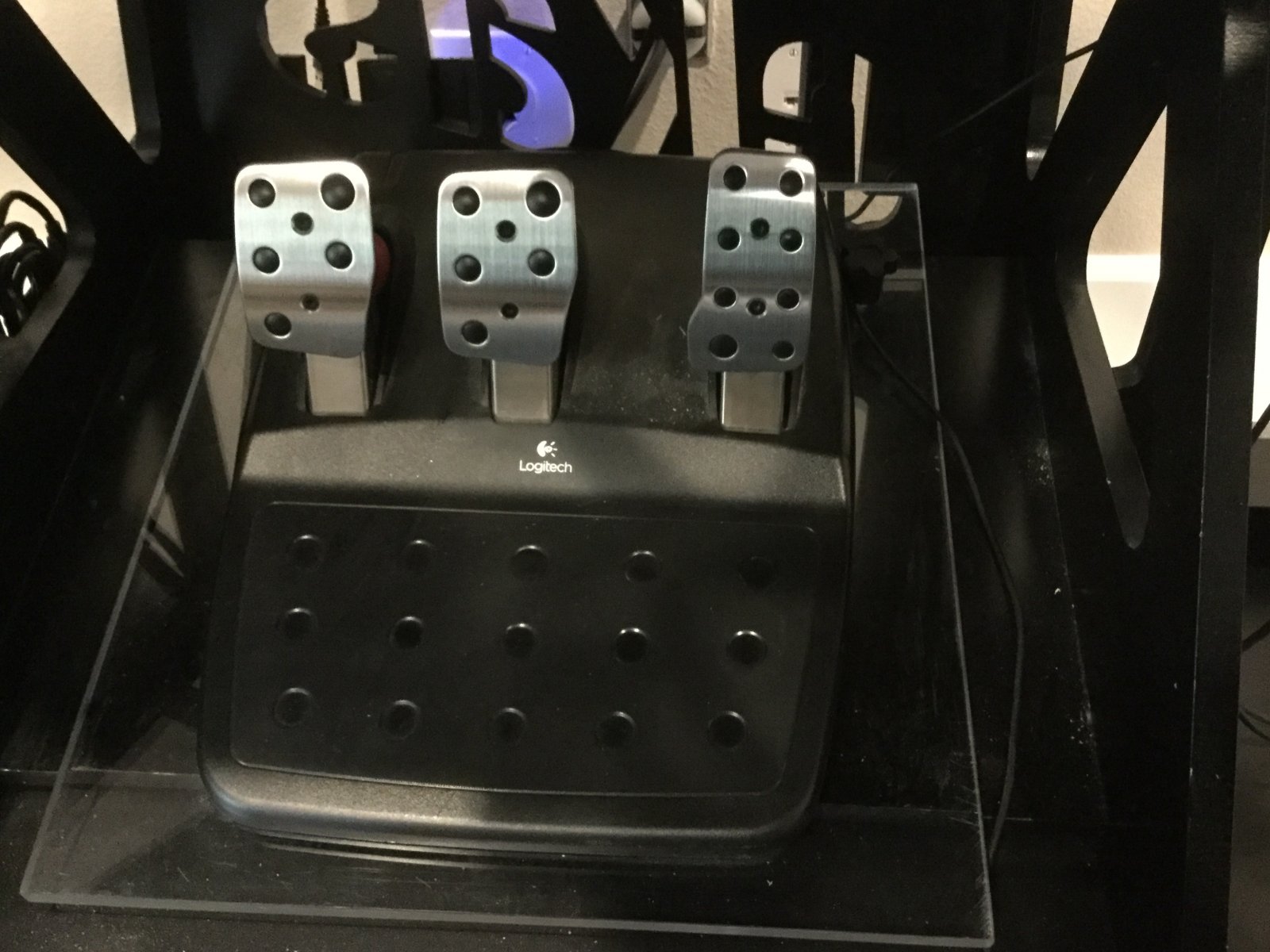

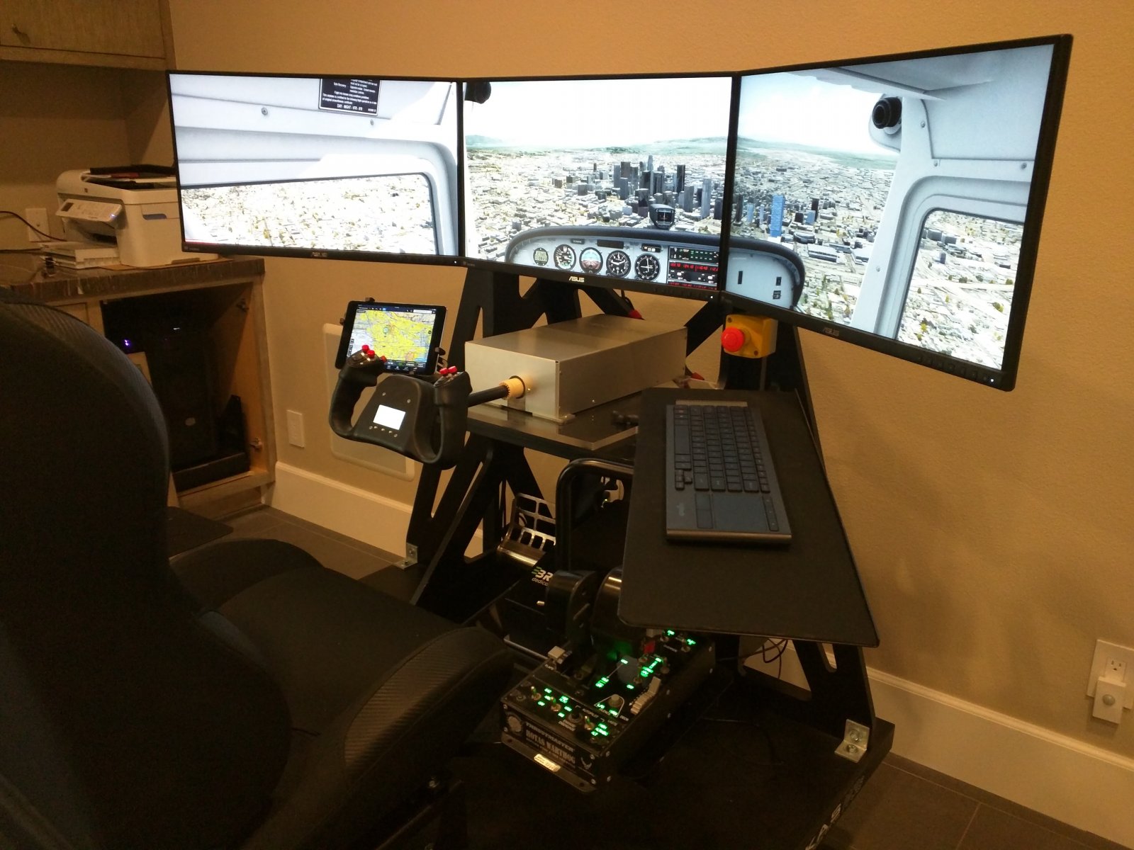

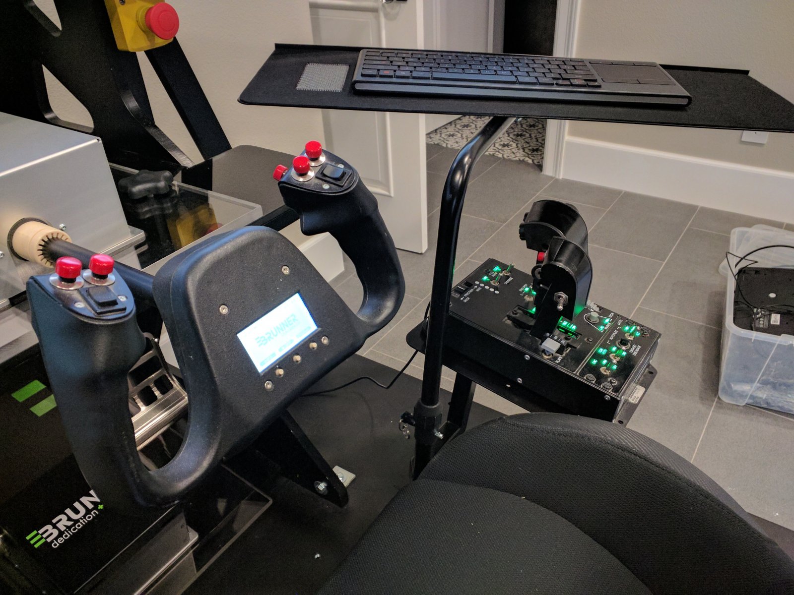

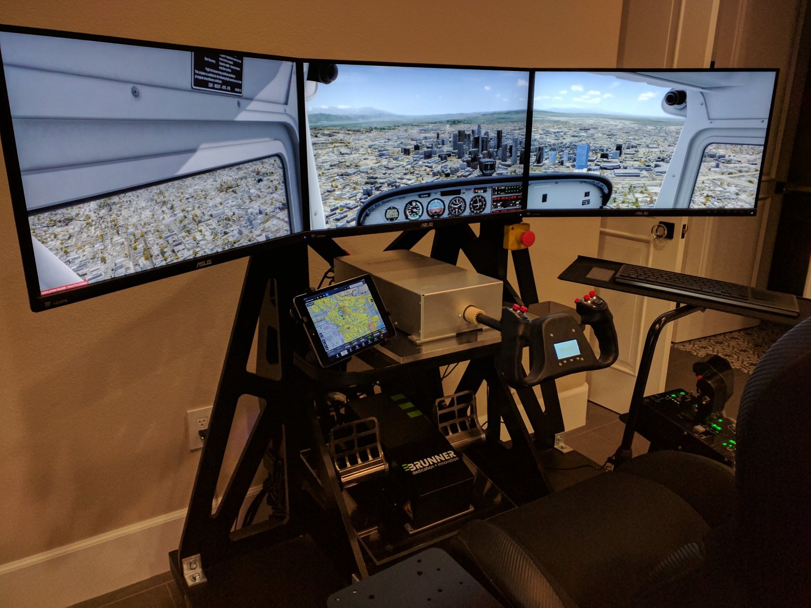

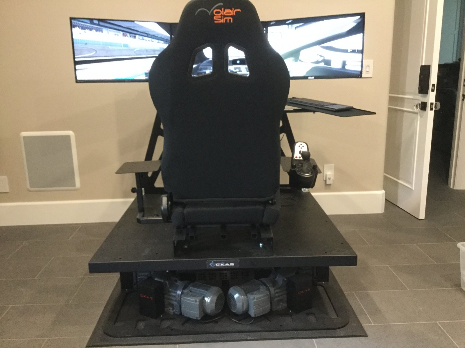

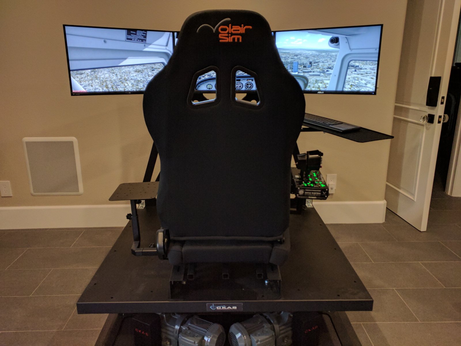

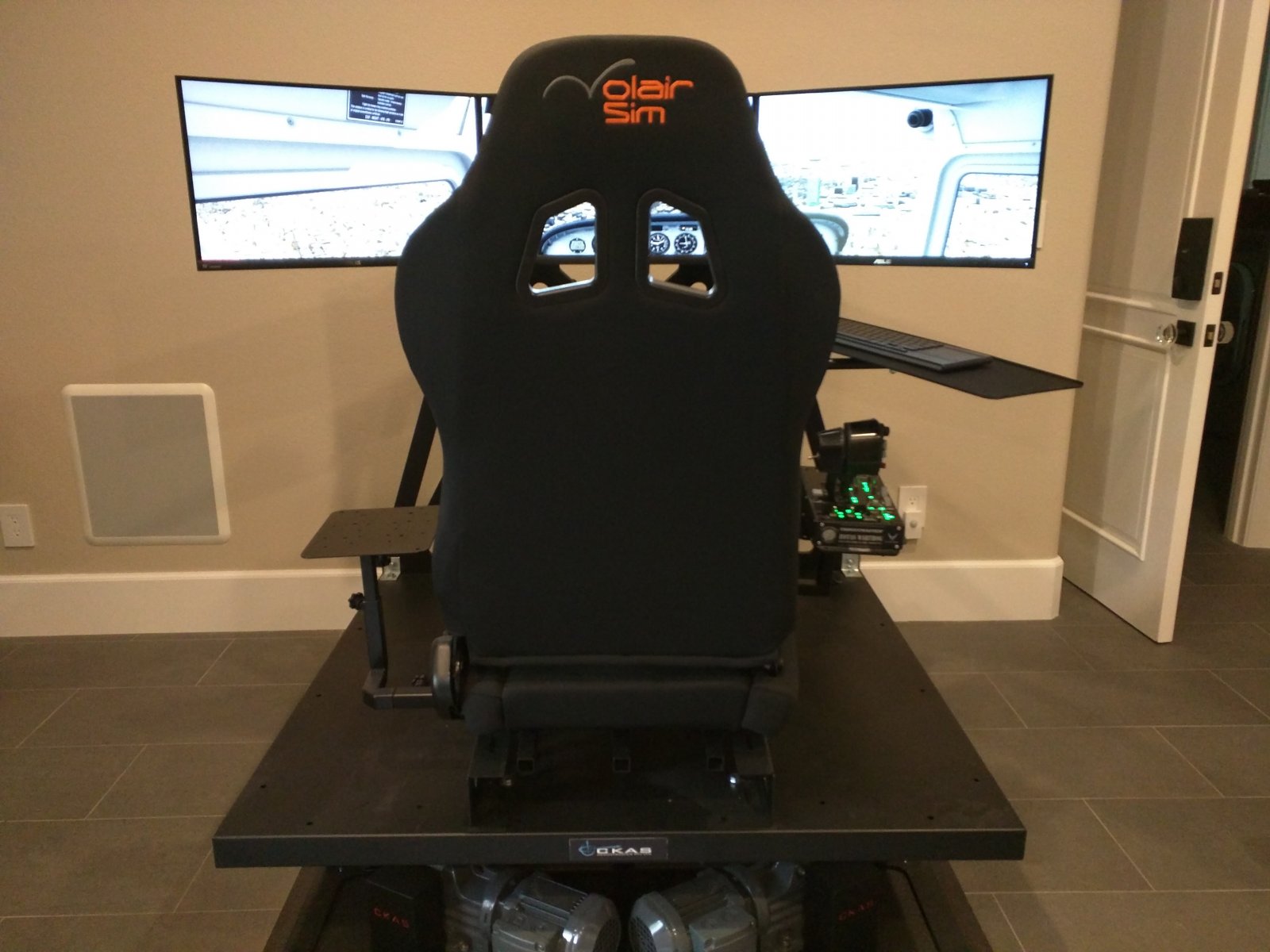

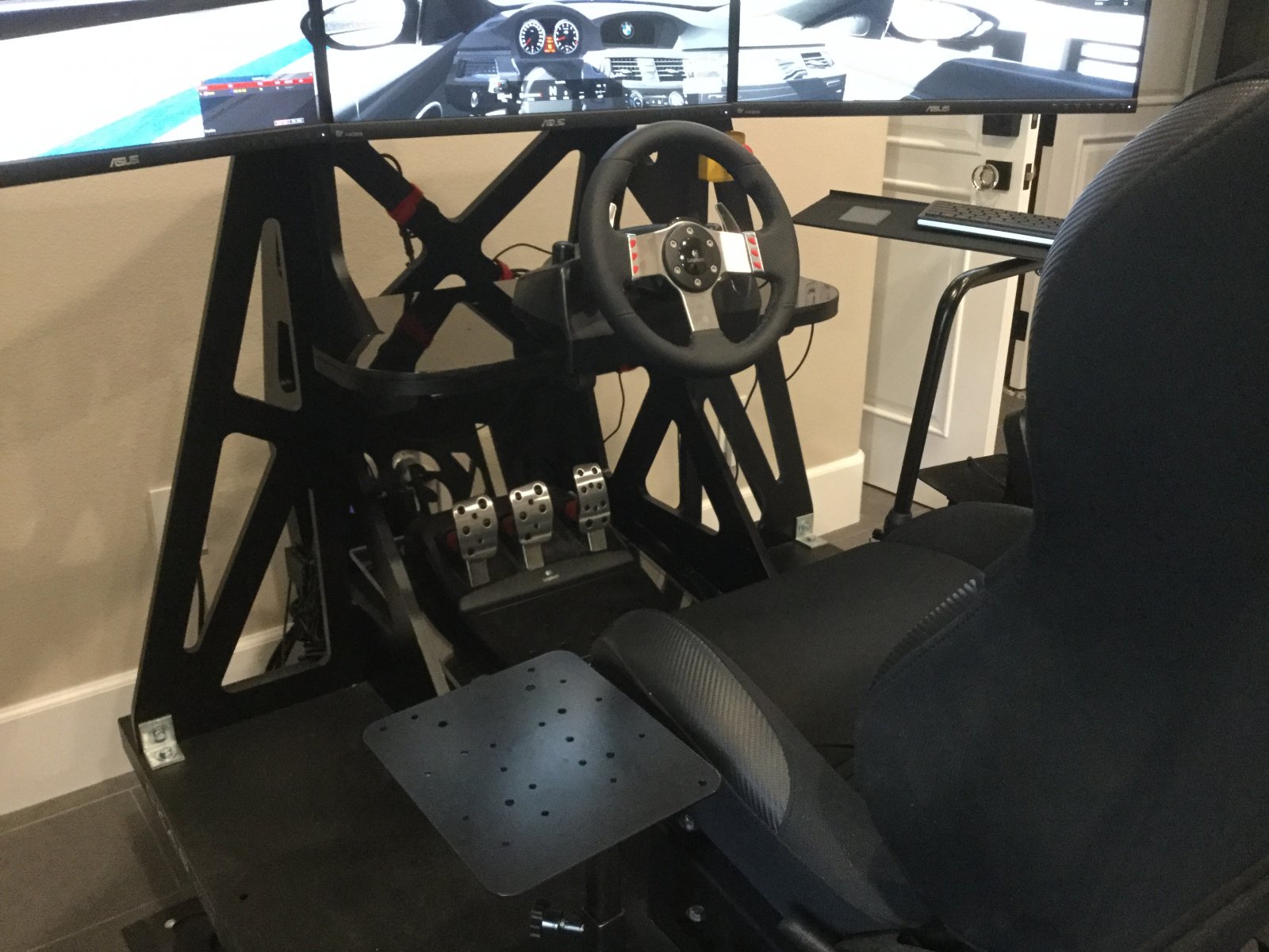

    Here are some pictures of the current setup. Still tweaking, and I'm sure not as good as some of the amazing home-brew stuff I've seen, but for a *completely* non-handy guy like myself, an off-the-shelf-solution has proven itself perfect for my application:
    IMG_0079.jpg IMG_20170526_111440.jpg IMG_20170526_111455.jpg IMG_20170526_111505.jpg IMG_20170526_111514.jpg
