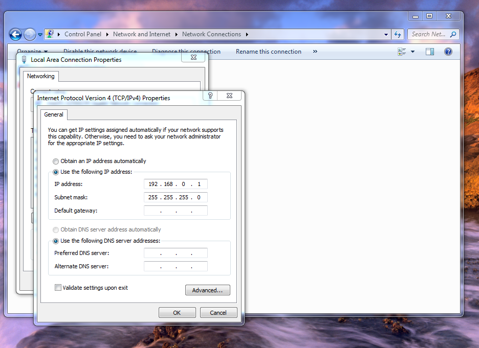

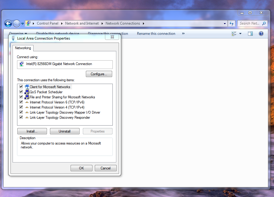

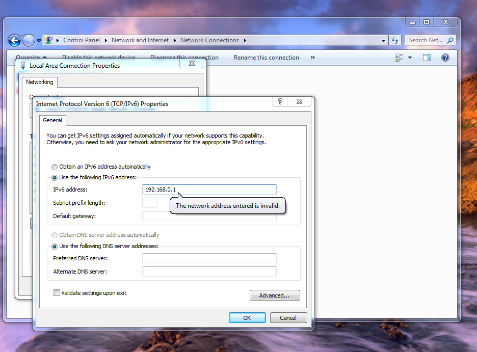

    A quick note to the above, I connected my computers to a "T" using Ceresoli's post #13 in TUTORIAL, "How to set-up a Dual-PC. please take a look. On the Game computer (windows-7) I posted the configuration set up for IP Address. It is somewhat different that that on Windows XP. I know that they (the two computers) talk to each other using the crossover cable. Like I said FSX works well

    Can I confirm that if you put them together the color patterns at each end of the Ethernet cable do not match up.

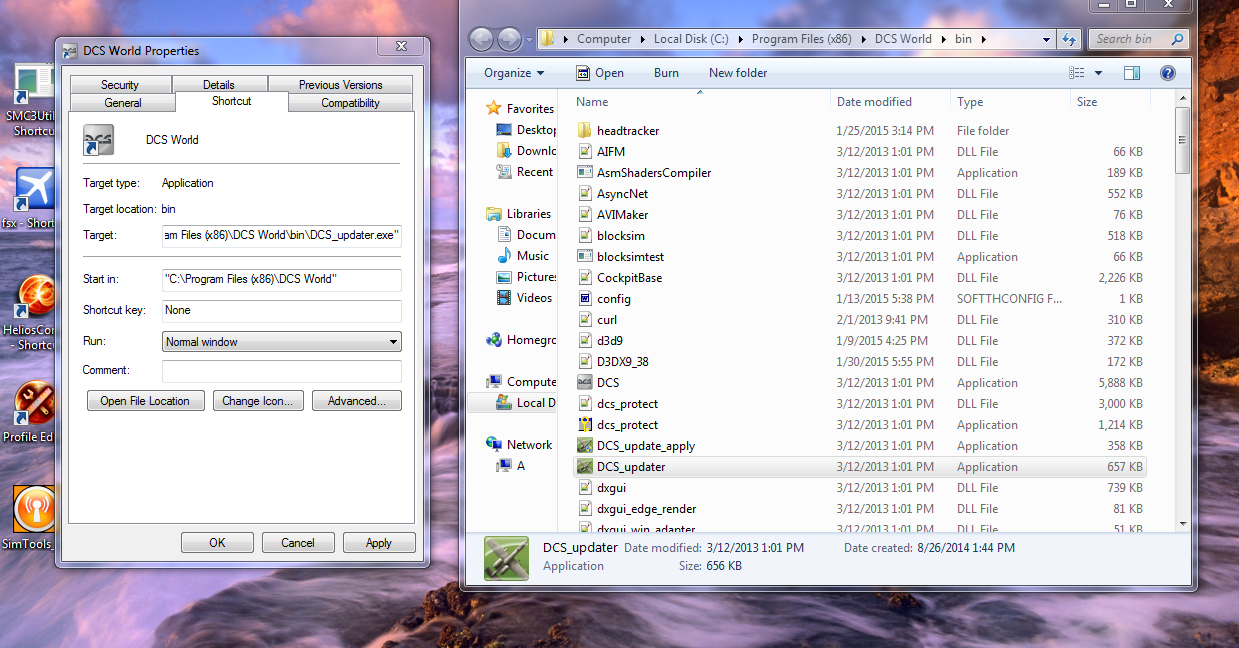

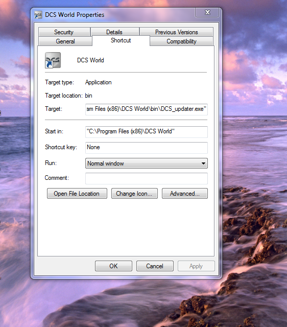

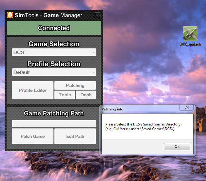

    Seems that I have been trying everything and nothing is working. Anyway I think the problem is in the PATCH. Why does Sims Tools want the user/saved games/DCS for the patch? My game is not patched that way and all applications for the game to run is in the Bin Folder which is not part of the User/Saved Games/DCS. I did copy/paste the bin folder into the saved games/DCS folder and that did not work either. take a look at my patching.

    Of course then necessary changes to program files should be carried out by Simtools when you patch a game to enable motion so a novice doesn't have to do it for themselves. But since DCS has a built in way to test if motion output is enabled, I was merely suggesting a way to look and see if the simtools DCS plugin was at least enabling motion output from DCS.
