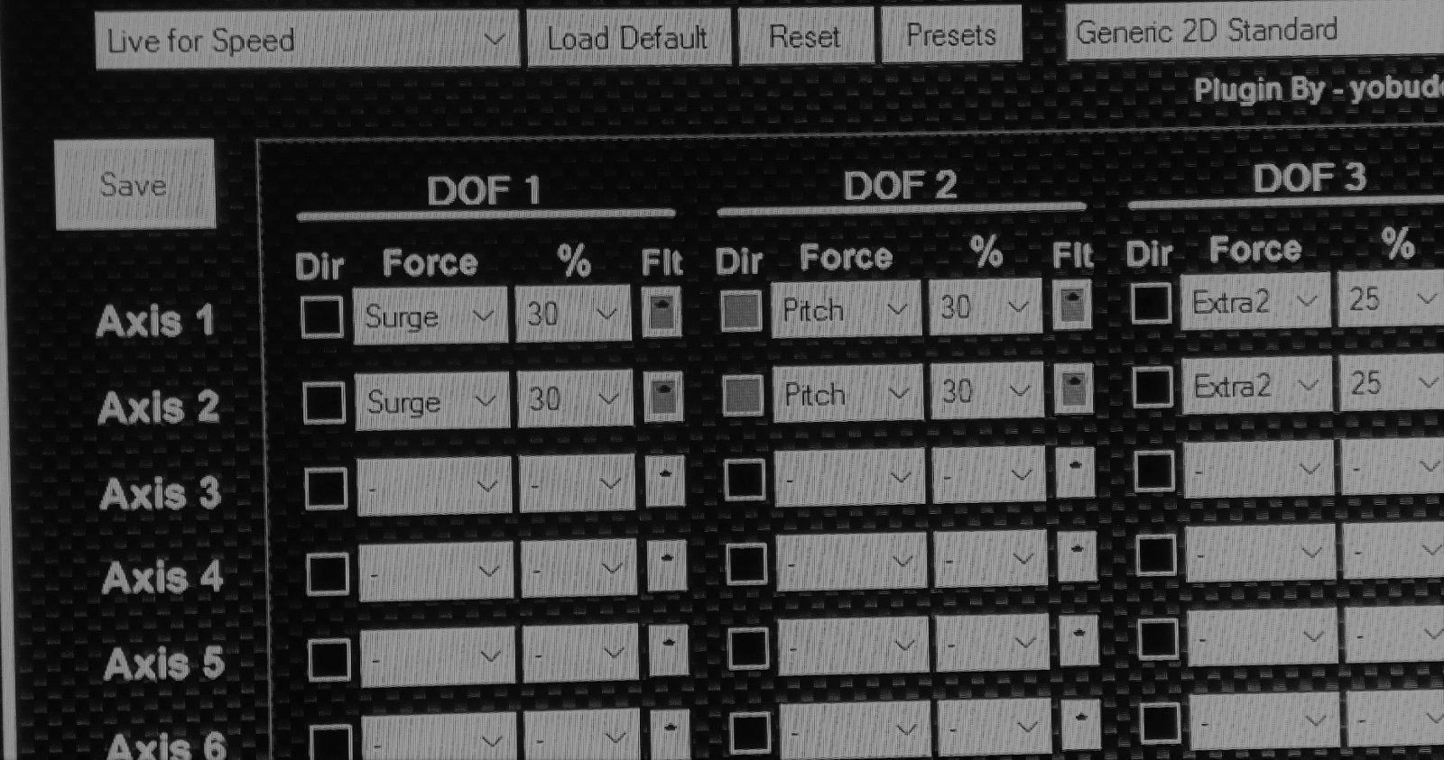

    At 2.1 I have entered the whole data and axes again, but I have with 2.1 at all no movement in the sim.
    Or do I have to set something else at 2.1?

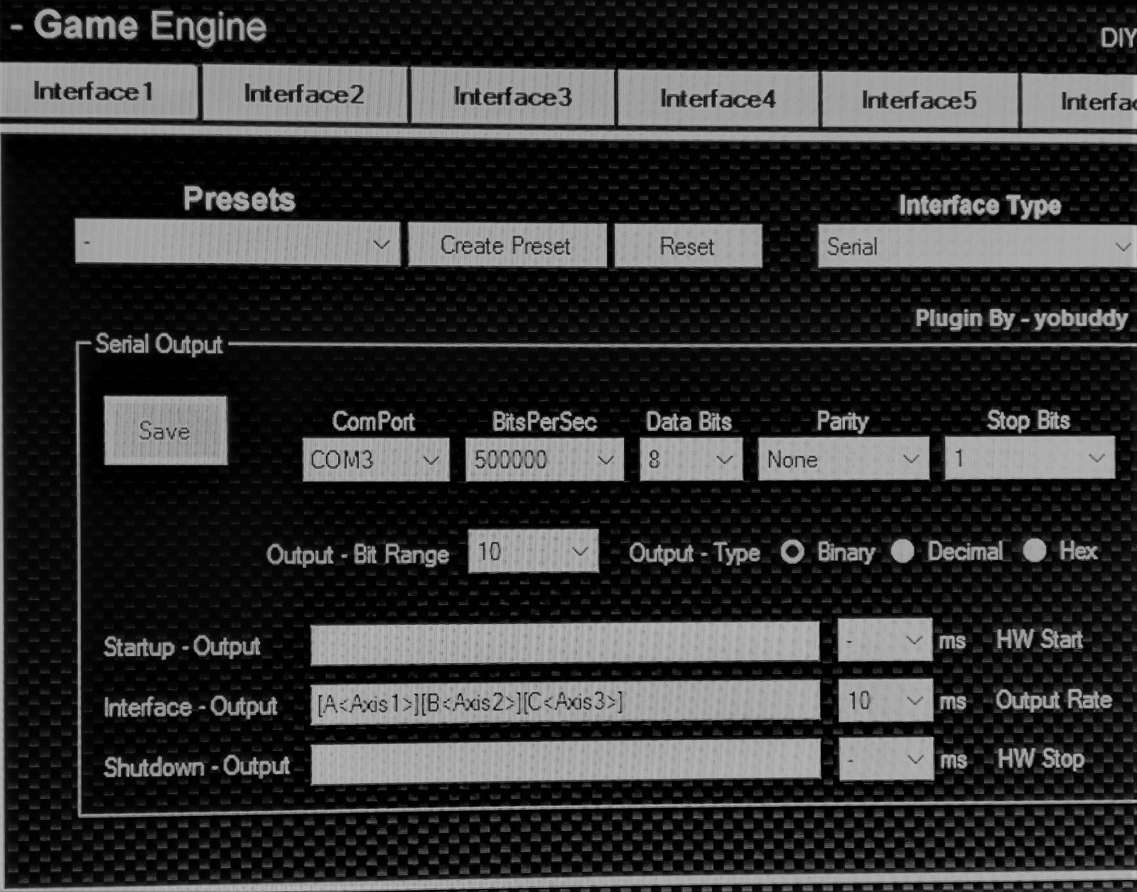

    [A<Axis1>][B<Axis2>][C<Axis3>]

    [A<Axis1a>][B<Axis2a>][C<Axis3a>]

    I have made all the settings as in 1.3
    I can also create the max min in the tunning center.
    Only it does not affect the engines.
    When I test the seat with smc3 it works.
    Now again everything deinstaliert and re-instaliert but no change!
    Times the setups tacked.

    @martin falz,
    There are 2 sets of axis assignments now, you need to tell SimTools which one to use.
    Here I'm telling it to use set 'a'.
