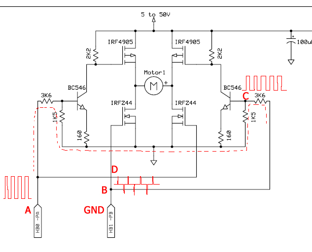

    So... I wasn't right, my IRLZ44Ns get hot anyway (just a bit later, if not in the adjusting phase) and I'll try to explain what I found.
    It might be something very obvious or I don't know what to think...
    I checked my board with an oscilloscope. I made the measeurement without load, no motor, only 12V for the H-Bridge. I just connected the AMC board together with the H-Bridge.
    On the picture can be seen what I'll try to explain (I use IRLZ44 instead of IRFZ44).
    Let's assume, that on the HB0 line there is a PWM signal. In this case the HB1 is ground as (PWM AND M1IN2) = GROUND. On the point A I can see the 5V PWM. But this PWM goes through the H-Brigde GND line (follow the red dotted line) and it appears on the point C, with a bit smaller amplitude (due to the resistors, I think). This signal goes through the 3k6 resistor and meets with HB1 (GND) at point B and it should be grounded also. The interesting thing is that if the driven low-side FET (the right side one on the picture) is taken out, point B is ground, as it should be. But if the driven low-side FET is its place, the measured signal at point B becomes what I painted there, a spiky signal, between -X V and +X V (X is somewhere between 1.6 and 1.9). In this case the HB1 line is not ground anymore and this spiky signal drives the left-side low-side FET and also the right-side upper FET, so all four FETs are open for milliseconds, and the short is ready, and it heats up both the IRLZ44Ns.
    As far as I know, the AMC board and the H-Bridge board grounds shouldn't be connected. I can't figure out what happens with the ground at point B.
    This spiky signal is there regardless of the 12V. Doesn't matter if it's connected or not.
    Is this spiky signal normal? Does anyone have something similar experience? Or did I miss something?

  8. Frakk
    Frakk Active Member
    Apr 15, 2009
    1,144
    328Coins
    All of the grounds should be connected.
    What do you think is going to happen if the ground is a couple Volts above the other board's ground?
    I don't know if this is going to fix it but thats what I would try first.
    That spiky signal is causing shoot through for that short period of time. If you get rid of it, I'm confident the heating issue will be solved.
  9. pjanos
    pjanos New Member
    Oct 4, 2010
    13
    0Coins
    Thanks Frakk,
    But I'm a bit confused now. In the DSMdb thread Thanos wrote multiple times:
    or
    or
    It suggests that the ground of AMC board and the ground of motor power supply circuit(s) on the DSMhb board shouldn't have been connected! And of course there' s no place on the DSMhb board where the ground coming from the AMC (powering the 74hc08 chip) should be connected to the grounds of the two motor supply circuits!
    I'm sure too, that if I can eliminate that spikes than everything will be ok. But now I don't know how it works this way to the others who have built it successfully.
    So you mean that I should connect the ground coming from the AMC board (to the 74HC08) to both grounds of the two motor supply circuits? If so, why Thanos saying not to do that?
    Or do I misunderstand something? :?
  10. Frakk
    Frakk Active Member
    Apr 15, 2009
    1,144
    328Coins
    I don't know why he is saying it, to be honest.
    Batteries are floating supplies. Pair them up with inductive DC motors and there will be huge fluctuations of voltage potentials.
    If the power side of the MOSFET's are referenced to a floating voltage, and driven by something with reference to ground.... well.... there will be some MOSFET's blown.
    I haven't built it, never tested it, so I can only guess what is happening.
    Best way to ground it is directly to the 5V regulator on the AMC with a separate wire, not too thin.
    ps. Using power supplies that are grounded are a lot better, but there is still a chance for unexpected things to happen.

  14. tronicgr
    tronicgr
    I'll try to hook the h-bridge in the oscilloscope I have to see if they are present for IRFZ44 also... but I doubt it. The PWM signal is coming very clear from the AMC, so it maybe either IRLZ44 issue or some versions of 74HC08 may introduce this spike as they can't follow correctly the pwm switching (internal delay)!
    Thanos

  16. Frakk
    Frakk Active Member
    Apr 15, 2009
    1,144
    328Coins
    The IRFZ44N's heat up for a different reason :)
    What happens if the negative battery connection suddenly raises to let's say 5V, with respect to the AMC/74HC08 Ground?
    Hint: now your output will be 5V lower... and your 0V will be -5V... with respect to the power side.
    And what harm is it going to do if we connect the Grounds? Please expand more on your reasoning Thanos. :)
    Maybe it is a unique problem? Maybe other's connect the grounds? Or use a grounded power supply to charge the batteries?
    Opto-Isolators are good practice indeed! However they are not necessary.
    Standard MOSFET's like the IRFZ44 (and also P-Ch ones) need proper MOSFET drivers, especially when getting into the 15kHz+ switching range.
    A transistor/resistor network is just not going to cut it, in my book at least.
    I have started a thread with such an H-Bridge that I got sidetracked from. If anyone interested in building and experimenting with it, please feel free.
    My first measurements and scope shots were looking good, but no further testing was done on that circuit.
    About the original problem:
    From what I can see on your sketches, you get a positive spike on the rising edge of the PWM pulse, you get a negative spike on the falling edge of the pulse, and the 2 waveforms line up perfectly on the scope?
    It could be some sort of weird capacitive crosstalk between the two wires, or maybe high-resistance connection (copper left between traces).
  17. pjanos
    pjanos New Member
    Oct 4, 2010
    13
    0Coins
    I took a deep breath and connected the grounds, as I saw no other solution. The spikes are still there, but they are reduced to 0.05-0.1 V range. No it doesn't effects the IRLZ44Ns and now it works without any heating, as it's suggested. I tried with the wiper motors too and it seems to be ok. (I made some rough initial test with nolimits and my children, the loved it, but it's far from a perfect setup.)
    Just for the record, I tried the IRFZ44 in the original setup. With a small motor it does not heat up at all, so the IRF seems to be immune to the spikes. Maybe that's why who uses the IRFs doesn't have this problem, I think.
    I would be interested in those, who uses IRLs without common ground and doesn't have any problems.
    So it is solved, and I take now the next step.
