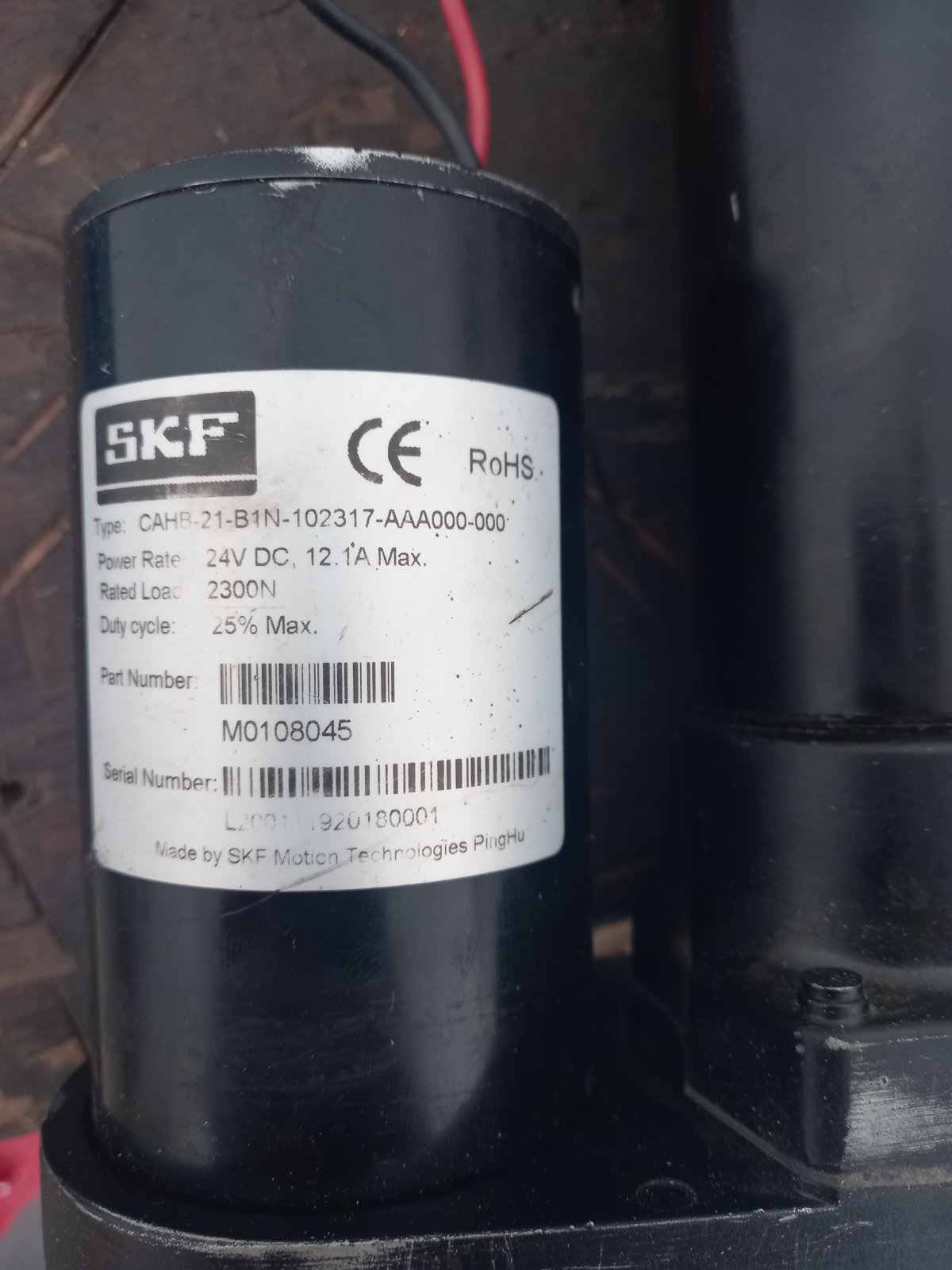

    They are 24v dc skf
    2300n load rating
    12.1 amp max
    115mm stroke
    25% duty cycle

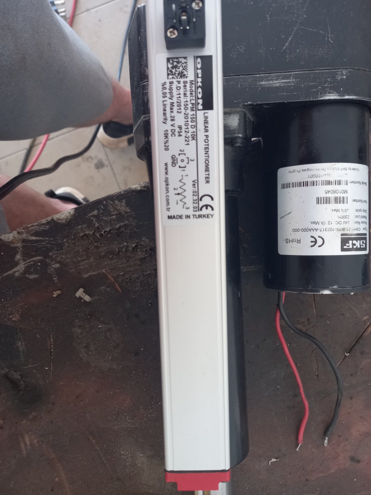

    In conjunction I'm using this 10k 150mm travel linear slide pot
    Please help me :sos

    Can you please provide a link to the manufacturer page and full specification of the actuator.

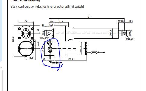

    You have this second cable from schemat?
    Linear resistor is orginally assembled or You add?

    Hi @seuszok that is for an optional limit switch...My actuators don't have those.
