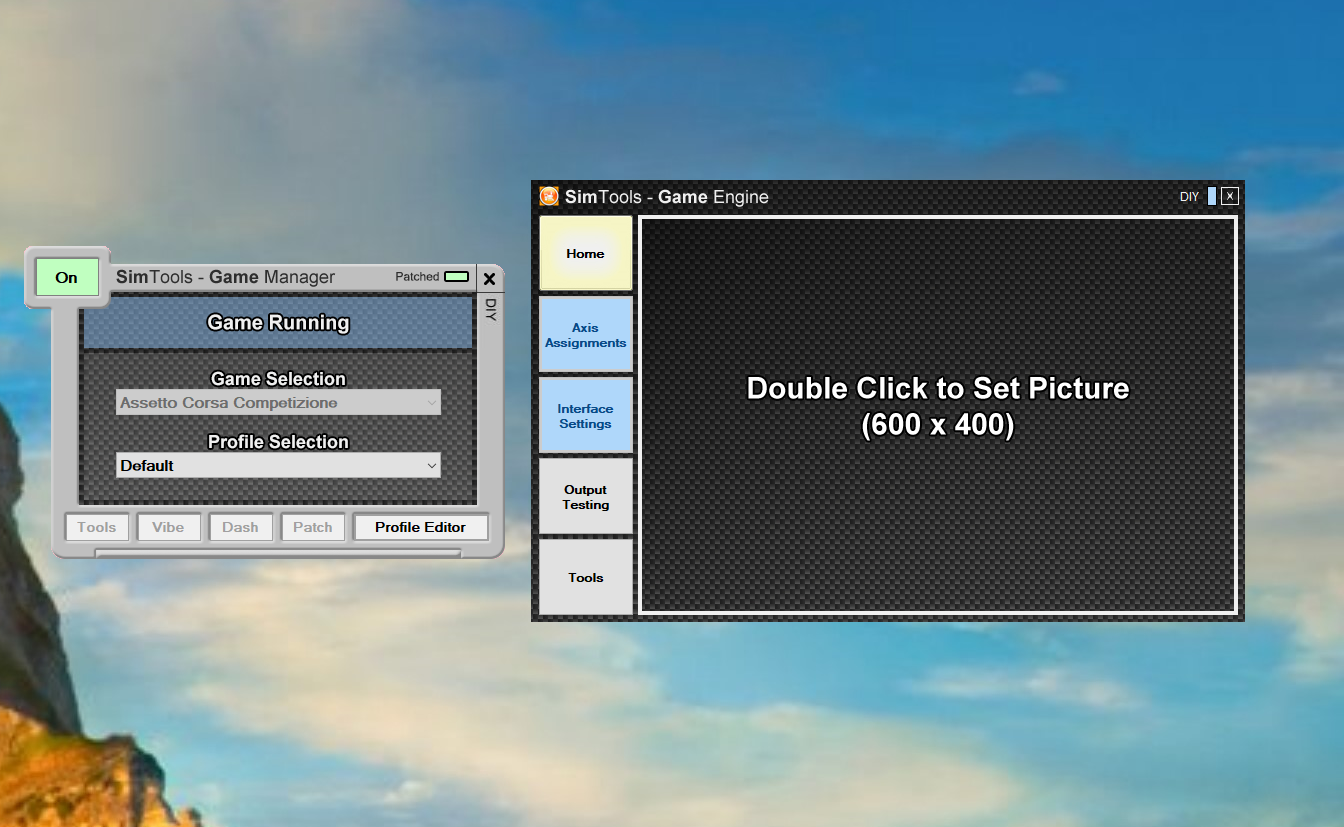

    Hy, im sorry but i need to ask another thing. ive reinstalled my pc cause of gpu issues. i reinstalled simtools and dame mangaer. placed setting in simtools. it works when i test output in the software.
    put the file in plugin manager installed it. patched it also. but it doesnt work ingame. im sure im just forgettibg something. but got no ide what. could you help me with that?
    Thank.
    btw. when the game is running looks like this

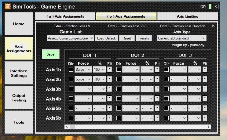

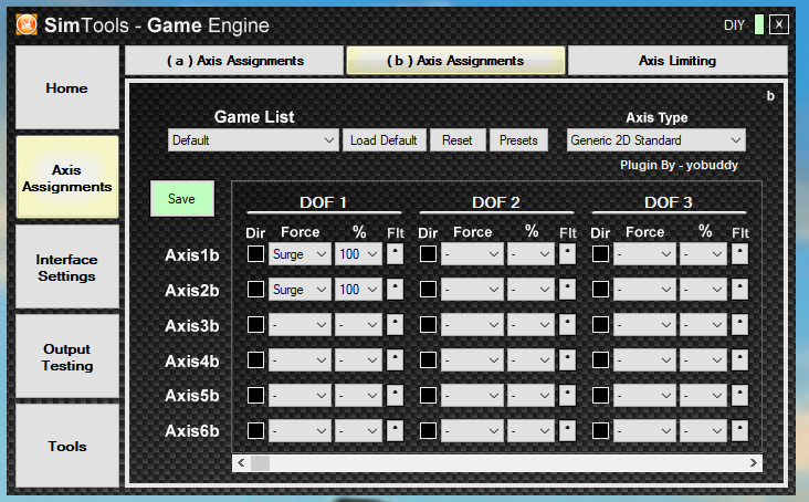

    Check that you have the axis settings saved under assetto corsa competizione and not just the default game profile.
  11. Armin Schmidt
    Armin Schmidt New Member
    Sep 4, 2019
    9
    80Coins
    2DOF, 3DOF
    How do i do that?

    Click on Axis assignments on the left and you should be able to select assetto corsa competizione under the Game list via the drop down. The Output testing only checks the default profile.

    i tried. did you copy the whole content from the file in simtools folder? the minmax and Banner?
    When i choose competizione on Game Manager profile editor it shows no graph. bur it did before
  16. Armin Schmidt
    Sep 4, 2019
    9
    80Coins
    2DOF, 3DOF
    Yep, thats it. I opened the folder with the plugin and put it in the plugin updater. And didnt put the whole folder in plugin updater. Had to read the manual to learn it. Sorry my bad.
