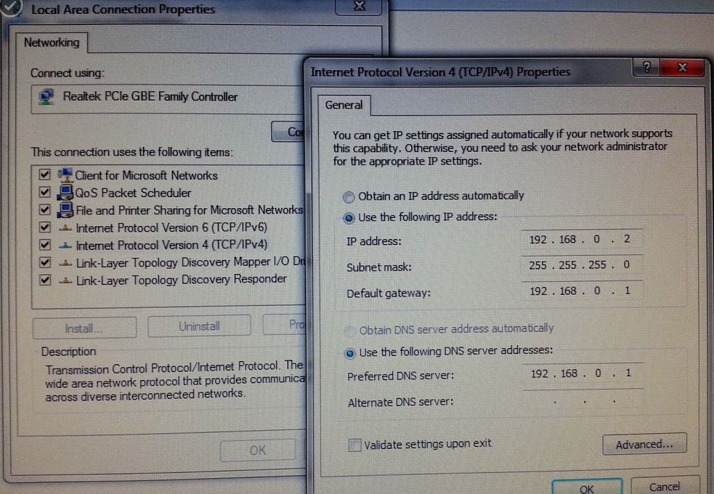

    Firstly apologies if this has been answered elsewhere already ... I searched the forums and couldn't find any topics along these lines. I've also spent 5 hours searching google but am running low on ideas.
    Secondly I know this is not a Windows 7 helpdesk but I cannot believe I'm the first person to have come across the following problem between Simtools and Windows 7 and I'm wondering if others have a simple solution.
    I'm running the 2 computer version of Simtools (GameManager on the game PC and GameEngine on the motor PCs). I've connected the computers via crossover ethernet cable direct to the ethernet cards. The network is running fine - I can see the two PCs and can transfer files between the two.
    I'm running Windows 7 Home Premium on both PCs. The problem lies with the different network settings.
    When I run the computers in the 'Home network' setting AND set up a 'Homegroup' between the two then GameManager will connect to GameEngine. Life is good.
    However, if the PCs are in 'Public Network' mode the PCs can't join a Homegroup and I can't get GameManager to recognise the GameEngine, without a Homegroup present, regardless of what I try - I've turned off Firewall, antivirus and allowed everything to share between the two computers. I can still use the network between the computers but GameManager remains 'Not Connected'. The only difference that I can see between the settings for my Public and Home networks is the Homegroup that is running in the Home mode.
    I know this sounds like a simple fix - just run the computers on a Home Network with a Homegroup - BUT Windows defaults back to Public Network every time I turn off the computers. Because the crossover cable doesn't have a DNS address it is therefore an 'unidentified network' and there is no setting in Windows Premium to automatically run an unidentified network as a Home Network (Professional and Ultimate have options but not Premium). Obviously this is a sensible in general - but not when I want to connect two PCs that will never go near the internet or any other PCs.
    What this means is that every time I start up the motion platform I will have to go into network settings in both computers and change from Public network to Home and then connect them to a Homegroup. What's more I'll need a monitor and keyboard attached to my motor PC (that I certainly wasn't planning) because I can't change the network settings over a Public network.
    Can anyone tell me whether they've had a similar problem with Windows 7 Premium and, more importantly, whether they found a fix?? Many thanks in advance!!

    I built and tested the software on a win7 PC without home group activated.
    So it should work.
    Could I see you network settings for the extra nix card in the PC?

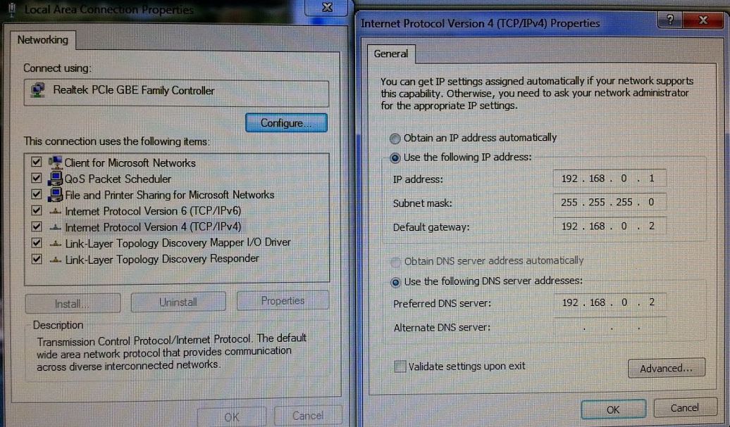

    Case closed with MUCH thanks to noorbeast and yobuddy!! :cheers 5 hours of midnight frustration finally over!!
    I'm afraid the problem simply comes down to my lack of confidence with networking (I've never been good at it) and therefore blindly following tutorials on the net for Windows 7 networking rather than knowing what I'm doing.
    The link noorbeast supplied was for Windows XP and Vista (not Windows 7) but it was spot on the money. Every Windows 7 networking tutorial that I found recommended leaving DNS server as detect automatically - even for direct PC to PC network via crossover cable. The spiel is that the new Homegroup feature will take care of everything. To be fair the Homegroup feature does work - it allows simple connection to share files between two computers without needing to go in and change IP and DNS information - but the leaving the DNS server address as automatic results in Windows detecting the crossover cable as a Public network which seems to restrict Simtools somehow - even when everything was changed to make the Public network share everything identically to a Home network. The other problem, as detailed previously, is that you can't save the settings to keep the cable as a Home network - you need to switch it from Home to Public each time the computer reboots.
    Anyway, changing the DNS server did the trick. The network was recognised immediately, Simtools connected instantly and Windows even followed up with the creation of a Homegroup that allows manipulation of all features of the network. Everything works and, more importantly, everything is saved as is when the computer reboots.
    I have a sneaking suspicion that the above is blatantly obvious to everyone other than myself and that this post does nothing but highlight my stupidity, BUT, just in case anyone else is as stupid as myself and stumbles across this post, the following are the settings that are working for me. I think it's important that both computers have the same Workgroup name for this to work (but I could be wrong about that as well). If anyone has more specific questions, and doesn't want to out themselves as a moron like myself, then send me a mail.
    Thanks again guys. Very much appreciated.

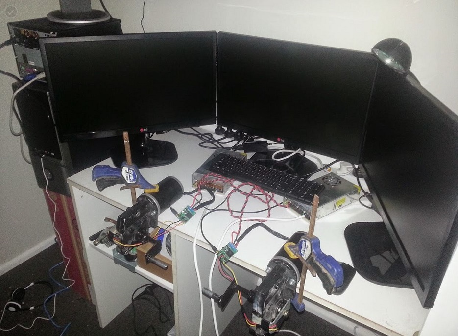

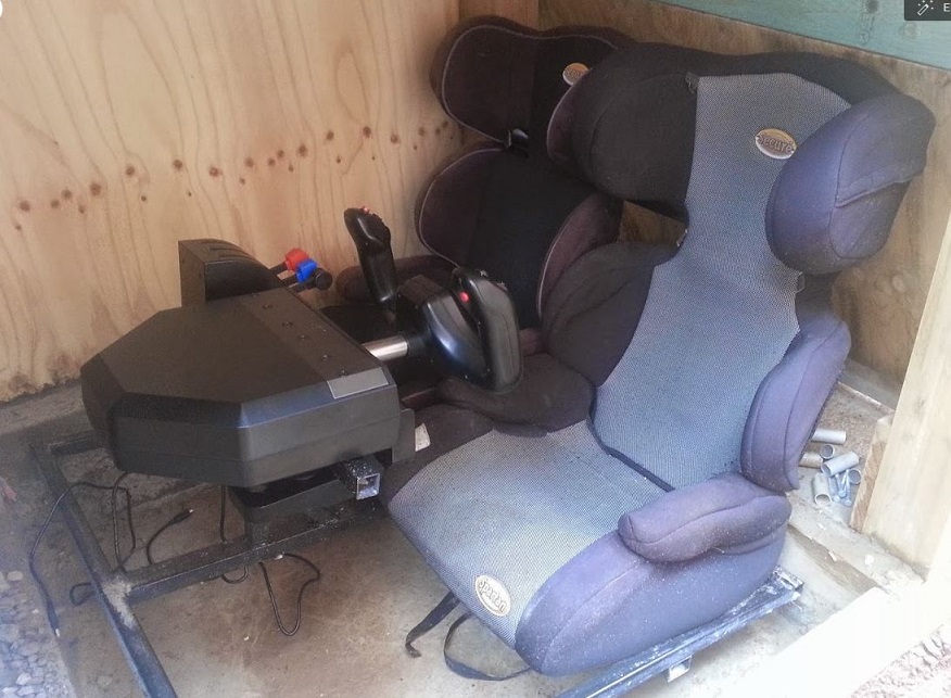

    To date, I've welded the frame together and into position on the cv joint, installed the seats and controls, connected the motors to the frame, connected the pots to the motors, hooked up a power supply and soldered them all onto the jrk. I've patched together a motor and gaming PC from old parts and connected up the jrks. All software has been installed and is working. Every single one of the above steps worked first go just by following instructions. And, now that this networking problem is solved, I'm at the point of working my way through the steps listed in the Simtools documentation before I see if everything will light up when I flick the switch. Hopefully it's only a couple more hours of work ... although working with your fingers crossed always takes longer than you expect.
    The Platform
    The PCs and Motors
