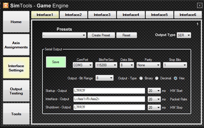

    Thanks for the suggestion by @eaorobbie , I have build the model now ,and successful for the axis test . but now I have a problem when I run the game (LFS), the axis are shaking always and they are not simulated driving state in the course of the game, just shaking.I have read the tutorials of the engine and the manager ,but I still don't find a way to solve the problem.
    I have tried for changing the Axis assigments to different sim force ,they are testing good, I think maybe the catching data of the LFS from the tuning center is wrong,you can see it in the video.
    Here is the video of the situation which let me headache. is there anyone can help with this? thank you very much!
    this is the test of the axis
    and the pictures of the setting

    Thanks for your replay ,I tried the to use the Sway and Surge, but there is nothing change better, I think maybe catching data of the tuning center is the problem,and the max/min value was adjusted by myself,because the data of the output testing is between 32767/-32767 when I slide the bar in the output testing window.And now I have reset the value and caught a new data from the game for save . the servo is not shaking like before ,but it looks too calm and basically don't move when I drive the car ,just occasionally shake a bit.
    Here is the pictures of the setting.
    Here is the wiring of the hardware

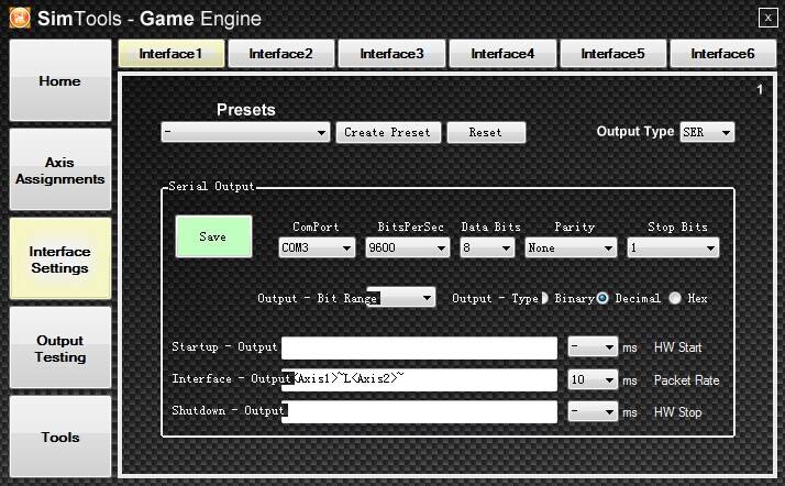

    Just tryieng to help but ... Am I missing something ? or these settings are weird :think
    Arduino should be like this ...

    I used the interface setting config supply by @eaorobbie, the test of the axis is fine, I think the problem is the catching data from the tuning center.

    Here is my settings ... Enable the HD

    No @speedy his using my Ard RC Model code and has the setting correct in the interface, settings you have shown I believe is for Mats code for DC motors.
    Feel the issue is understanding how to setup simtools once in game , Tuning the MinMax to suit the Models actions, the first step a lot of people seem to falling over at. I have a partial tutorial that will explain all this as this is not fully explained in our documentation, this wont be another quick start but a more in depth explanation on how to setup and why we setup in this way so to help newbies get a sim rock n rolling faster. SimTools is quite simple compared to most systems I have used over the years.
