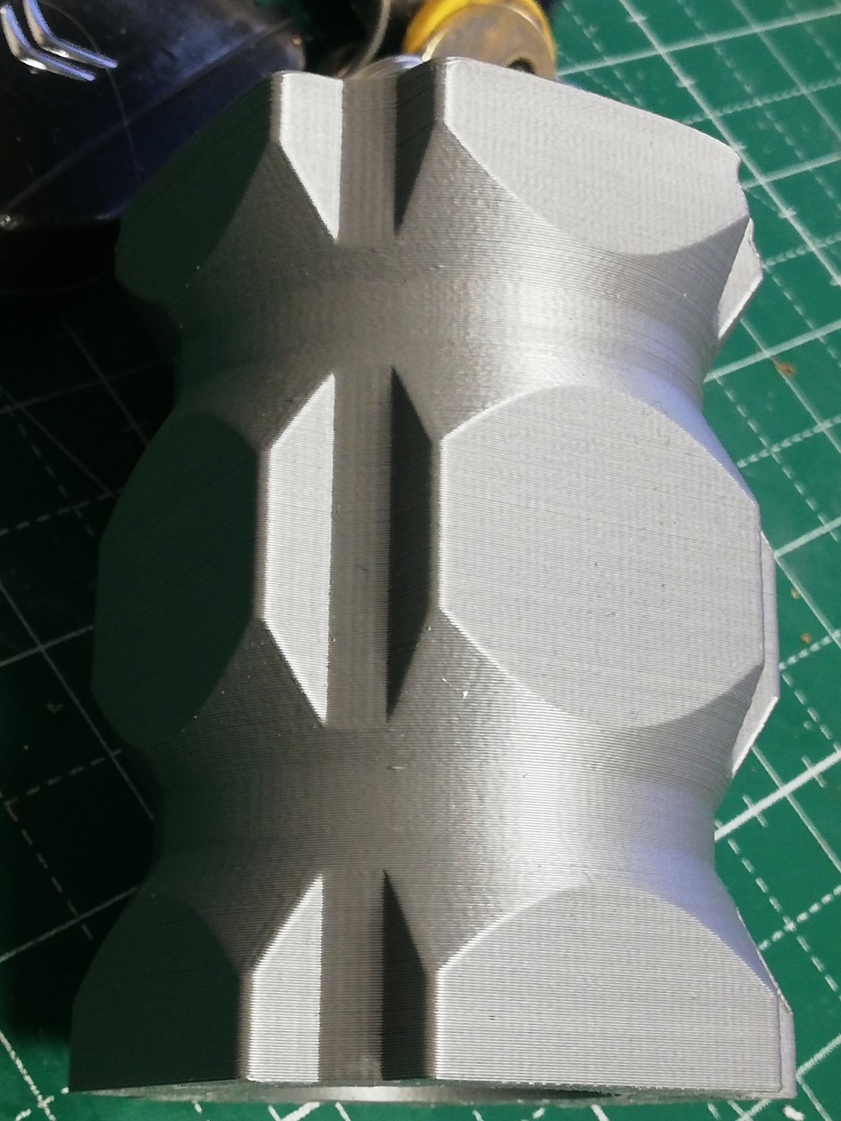

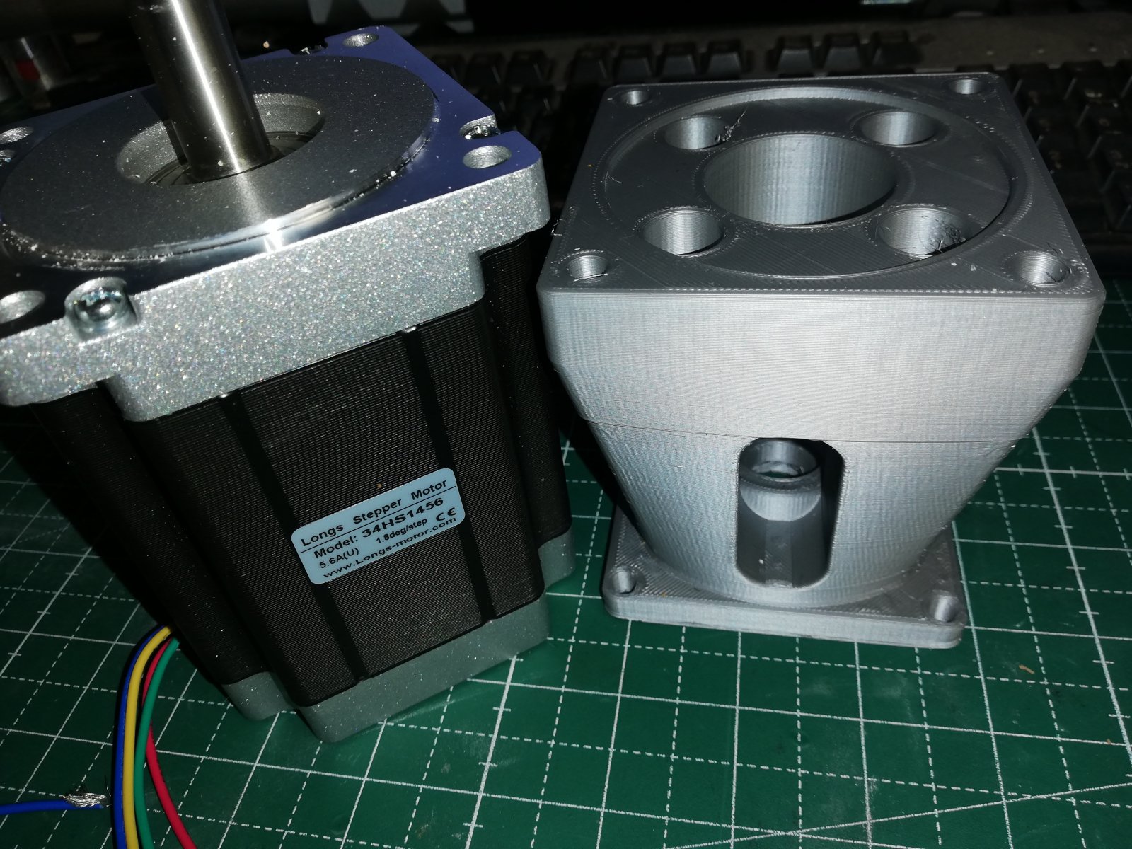

    and nice to share for to setting this up . when wired up i give it a test and writhe the result in here . i did printed the actuator parts in 10% alu filament , verry rare and absoluut strong filament . printing with 170 C , the setup is with 1605 trapezium tread and pom-c ballnuts . got the tool for making these ballnuts . did orderd the alu profiles 300mm lengte , amazone, its all a cheap setup for parts , but i wanted to give it a try because the leftover nema,s .. did read alot onto this forum , but not much for steppenmotors . my first sim motion rig is working for now with 2 dof , this steppenmotor setup wil go into the ferrari p4/5 project .:)

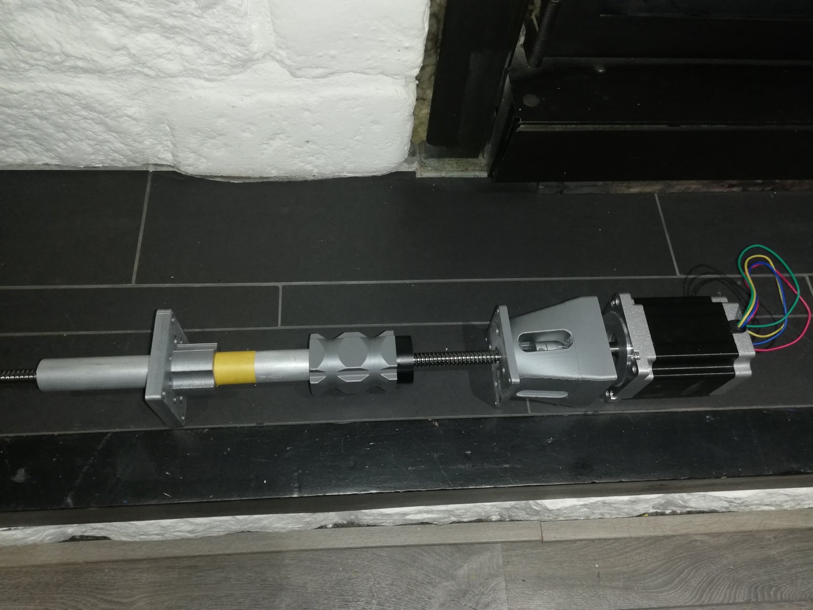

    It looks like you 3D printed the slider used for the OpenSFX100 but these use a 100x100 aluminium profile. And as I can see, you ordered 80x80 profiles, so it will not work. Am I wrong ?

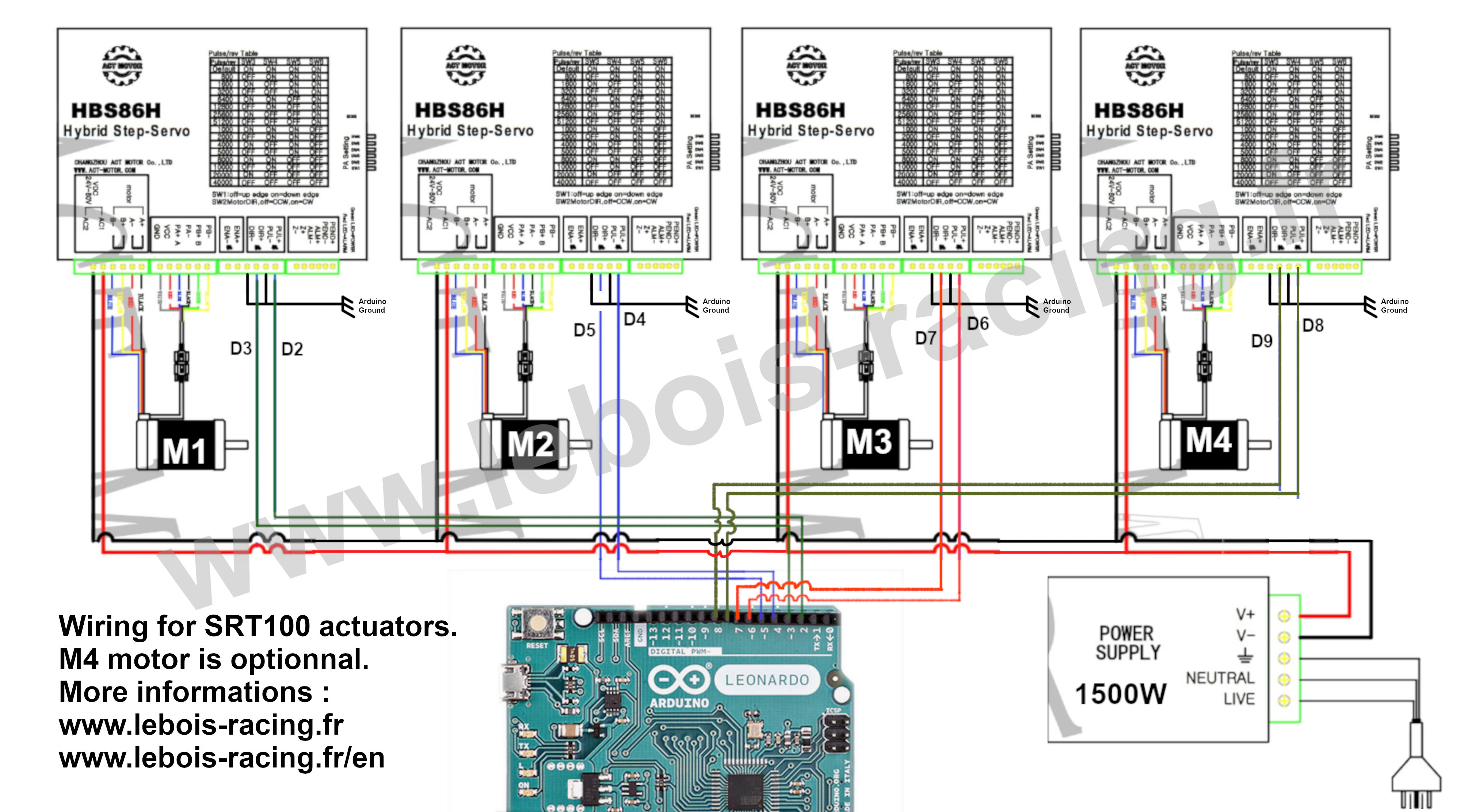

    And here is the wiring I use, if it can help you...

    you are wright , sfx-100 slider . the slider was my first print from a stl site sfx-100 . based onto the nema 80x80 dimension i design the actuator 80x80x300., did have an arduino mega and already downloaded the sketch onto it . after a error type error my motion seat 1 is broke , gone fix this tomorrow , and get back to wiring up the nema setup .. we wil see if it wil work with this sketch , i wil posting here when i got them wired up and testrun

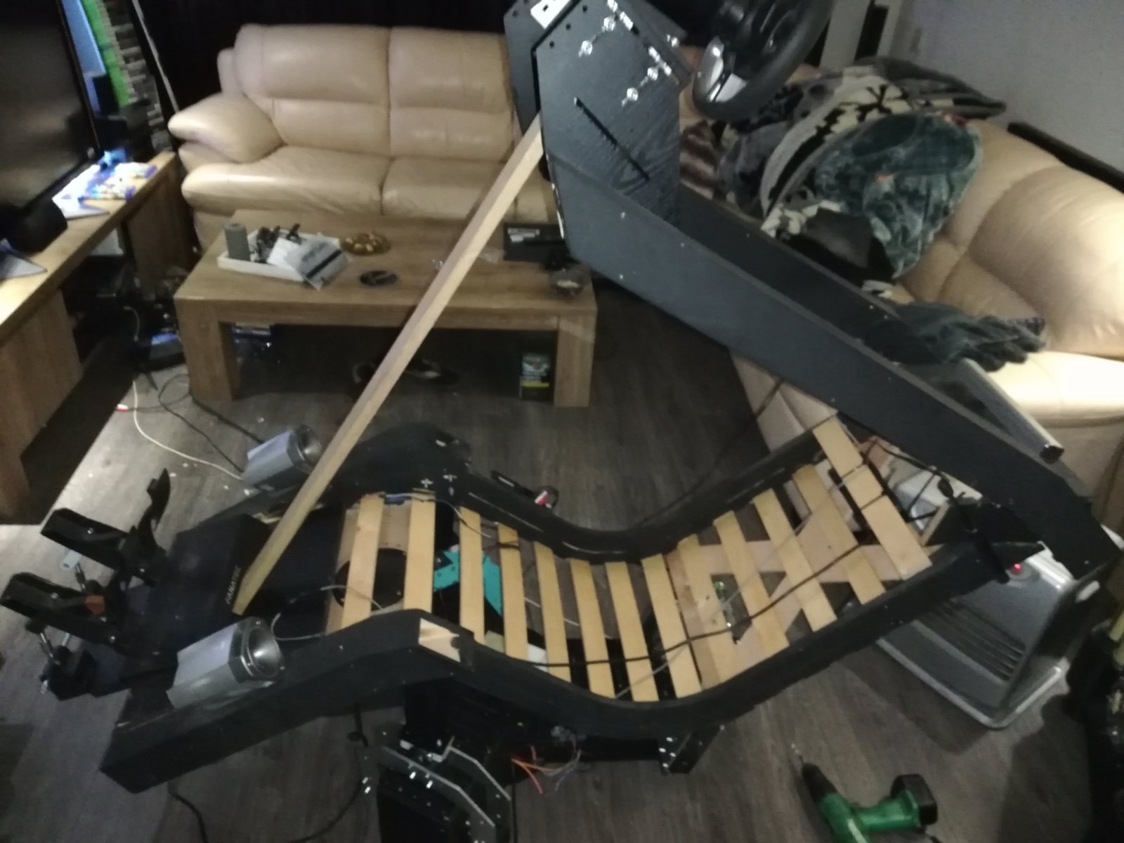

    just did cnc make some parts for the broken rig , got the actuator parts almost ready now and will assemble it and test run when wiring up the whole thing ...stil bizzy with assembeling the new/broken motion box .

    the rig nr 1 , home made prototype . al plans in autocad , free to share . al made on my home cnc . verry nice fitting/assembeling , cheap wooden parts . the body position is perfect .... al evening dirtrally , no problem with not good sitting , pain ore something .. it is a prototype and already making it in alu and carbon parts . al wil be finish in alcantare like the seat . complete rig in alcantara ...the side arms that go up for getting into the seat is electrik . also foot pedals are electric forward ore backwards . IMG_20240113_170005.jpg
    good idee for me is to wait with the software , i,m seeing you are better with arduino writing then me.. this setup is for rig nr 2 ferrari , i,m not in a hurry with it . got it al layout now , nema motor , driver , power , wiring to arduino mega2560 . but no software onto the mega yet ...
    motion box almost ready again , for a new testdrive again ....and now with 3 dof and yaw motion . IMG_20240113_143030.jpg
