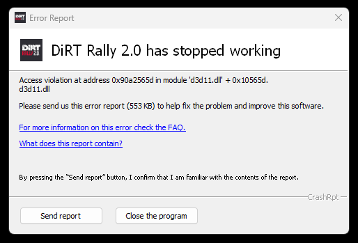

    I've recently been getting the below error message when starting Dirt Rally 2.0. It has earlier worked fine.
    I run on a Prosimu rig.
    ERROR MESSAGE
    Access violation at address 0xeff3dbb7 in module 'dirtrally2.exe' + 0x8ddbb7.
    dirtrally2.exe
    I can sometimes get the game to start, but the rig won't move. it starts up in a 'starting position' but won't move during racing.
    Not sure what's wrong. I have a 4060 Ti graphics card on an i5 computer.

    Can you please add a bit more specific context, such as what version of SimTools are you using?
    Can you also please post a picture of the full error message.
    Does the game still crash without motion?

    I´ve tried to do some more testing, and have found a way to get past my issue. After getting the error message, i can remove the patch for Dirt Rally and then patch it again. Then the game works and the simulator moves.
    I run on Sim Tools 2.6.
    If i do not start the simulator, the game works fine. Also with the steering wheel, pedals and handbrake (Moza).
    I´m uploading a print screen of the error message as well.

    Pic uploaded

    That is a weird one for @yobuddy to consider. My guess is that is likely a DR2 game issue.

    Just a quick feedback on this topic (more of an FYI). I updated my Nvidia drivers, and after that the error message has disappeared. At least for now, but hopefully forever :)
    Still running on v2.6.
