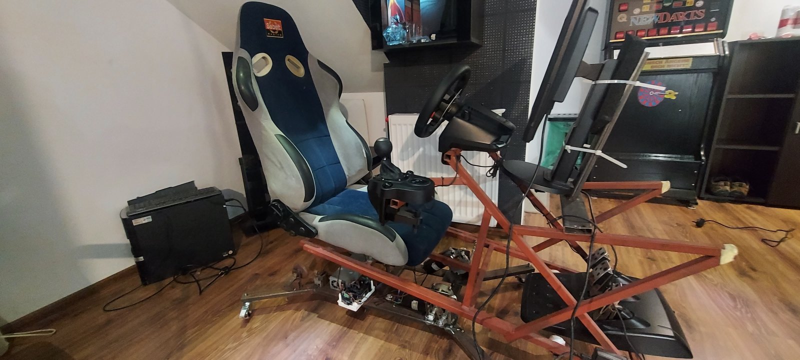

    Good day. Please help someone to find a problem in my 2dof sym.
    The problem is that there are large jerks when braking (just before the vehicle stops).
    Drives cannot stabilize. Sometimes when the car is stopped, they make strange unforeseen movements.
    I also noticed when testing the outputs, there are large jerks when moving the sliders slowly.
    When I make a big quick jump, the movement is smooth
    Ideas please
    specification:
    - 2x wiper motor
    - server power supply
    Arduino Uno
    2x cermet Vishay P11VYN010K
    MODE2
    In the links below, videos and pictures of the configuration

    It looks like your SMC3 settings could use a bit of refinement to tighten up the tracking response.
    In SimTools there is no reason to use Axis Limiting, set it to 100%.
    Grab a copy of the SimTools manual and keep it handing for reference: https://www.xsimulator.net/community/faq/rtfm-start-with-the-official-simtools-documentation.117/
    Then see the motion profile tuning tips in the FAQs: https://www.xsimulator.net/community/faq/steps-to-create-a-motion-profile.228/
    In particular start with less Axis Allocations, then capture the Max/Min values in the Tuning Center. After that temporarily disable all other axis by setting their Axis Allocation to zero and just work on one axis at a time, refining its allocation and TC settings. Then when you are happy with it disable that one and do another.
