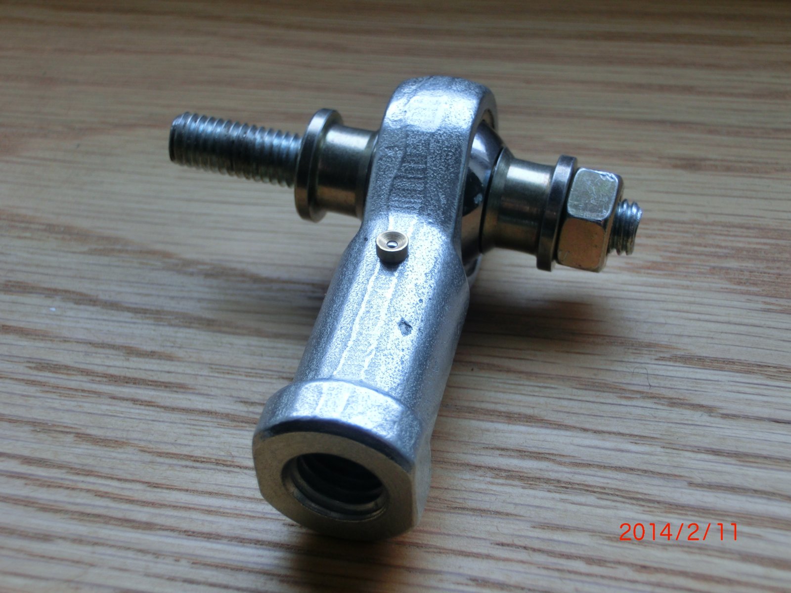

    What do most people use for connectors between pushrods and the motors lever? It looks like ball joints of some kind but I haven't seen much conversation on here about them.

    Hi
    In the UK we call them Rose Joints, in the RC model world their called Ball Links
    the one pictured is M12 size with high angle displacement spacers which then use M8 bolts.
    I get mine from China via ebay.

    Perfect, that's exactly what I was picturing but my google-fu was failing me! I guess they are called rod ends on this side of the pond.
    Thanks!

    JBoogie, the ball joints are actually called Heim Joints. If you are going to use pipe for the push rods you can get bungs for the Heim joints. The bungs can be welded inside the pipe which then allows the Heim joints to screw into the bung for adjustment.
    These are the ones that I have been purchasing via Ebay they are inexpensive at 15.00 a set:

    Awesome thanks! Any particular pipe used? Copper plumbing pipe will work?

    I used steel water pipe off the shelf at HomeDepot. 3/4" pipe, the inside diameter is 1/2" which matches the bungs.
    You might have a hard time getting copper pipe to solder well to the steel bungs. Steel pipe and a welder (or even screw them together through the sides) would be your best bet.
