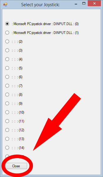

    The plugin gets very confused between my other controllers. If I just use the Warthog it will only allocate sway, surge and extra buttons, even if I unplug everything else. For some reason the plugin wants to allocate roll and pitch to my Saitek rudder pedals.

    Maybe a very dumb question but nevertheless: did you press the "close"-button after selecting your device?

    Pretty sure I did @value1, and I had it working fine with the Xbox controller, but I will double check next time I fire it up and let you know.
