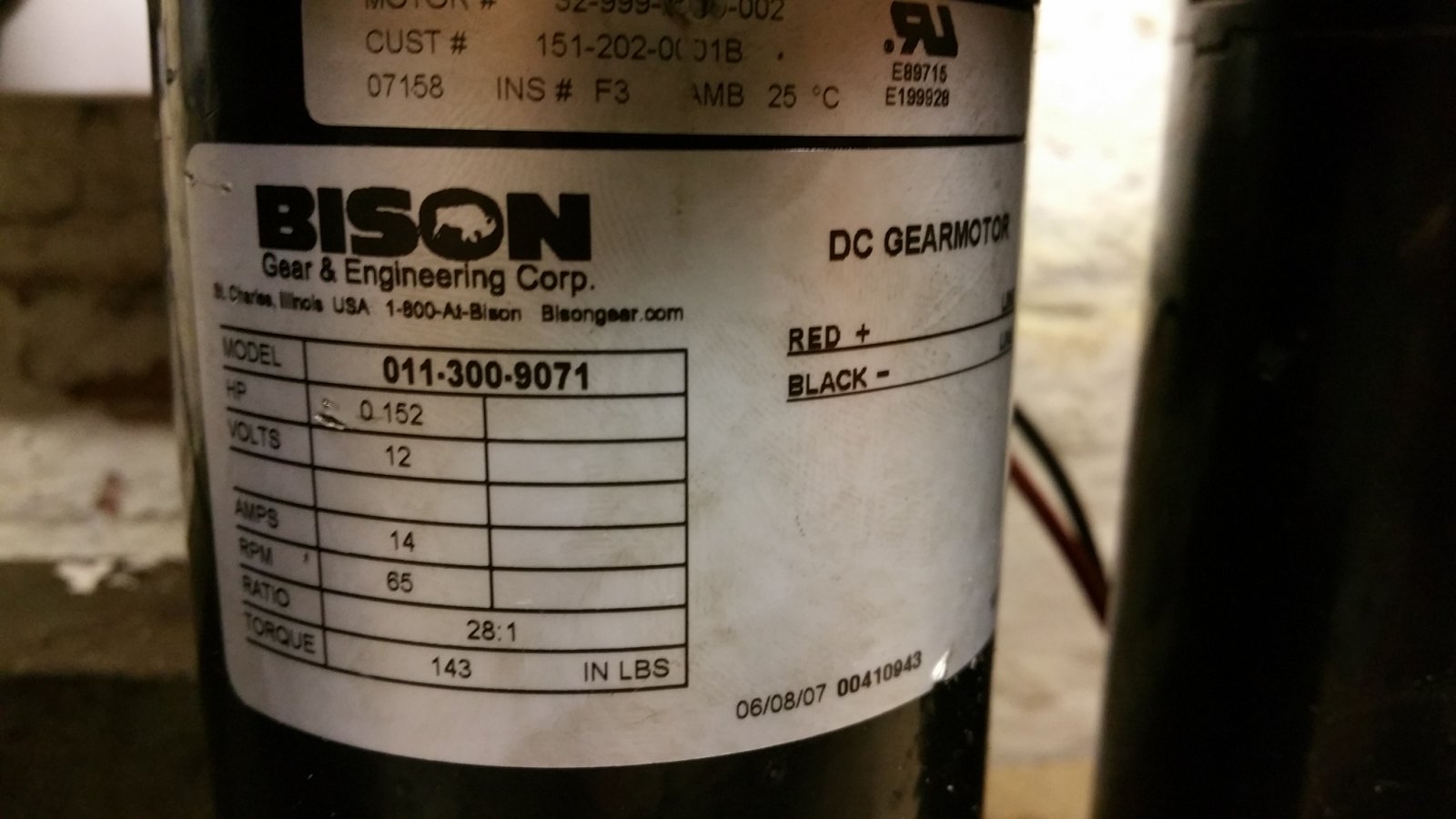

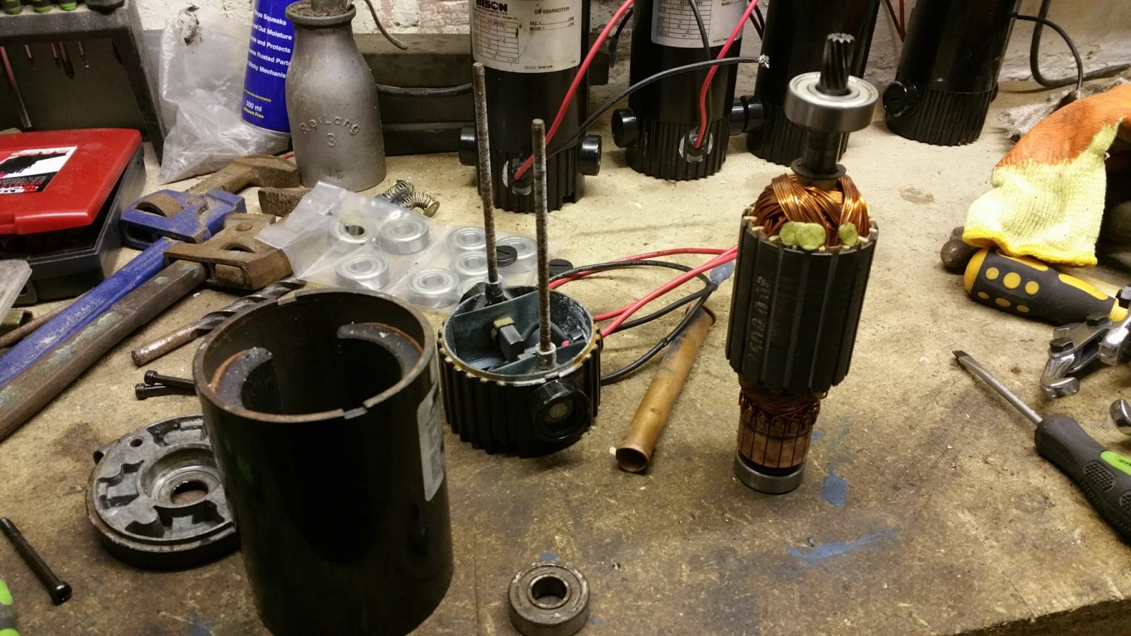

    Have no idea what I will do with them but sure I can think of something.
    A lot of the top bearings were seized and rusty but the gearboxes seem perfectly good. Commutator were covered with crap but clean up nicely. 20150814_143624.jpg 20150814_143618.jpg 20150814_143639.jpg
    Should all work like a charm once I fix them up a little.

    Hard to beat a freebee! :p To bad they don't have more power though.

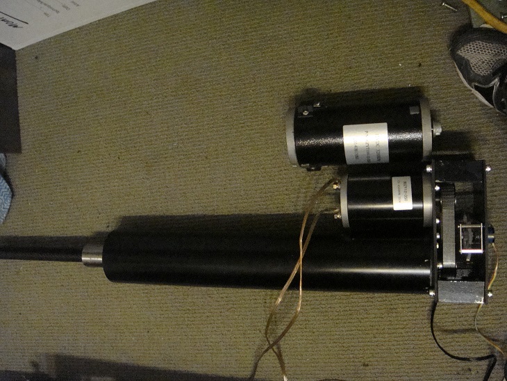

    Eg/ Standard rated motor against a commercial rated motor - the smaller motor is rated at 12v 350W and the bigger one is 12v 320w (continuous). Many 'standard' motors are only good for 15minutes at their full rated load - cycle them at more than that and you will want some cooling, which some members have implemented.
