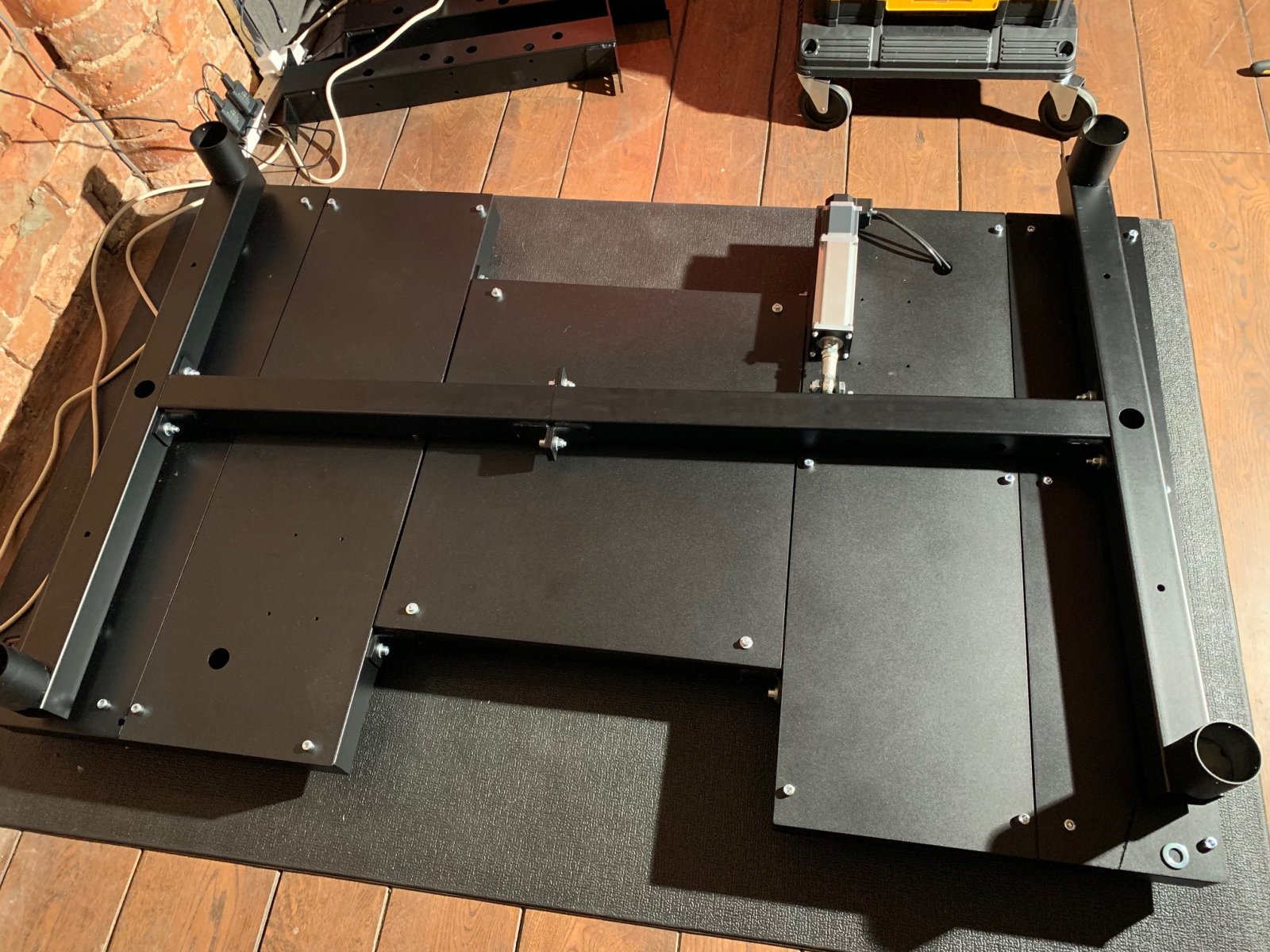

    Hi everyone! Encouraged by this forum, and after some very helpful discussions with Patrick, I've just taken delivery of a Prosimu T1000 5DOF (with the new 200mm actuators - which are massive!). I'm a few hours into building it, and so far, so good. (You can see from the first pic how extremely happy I was to see the truck arrive). We have a converted stable block next to our house, which is going to be the new 'clubhouse'...
    I fly as well as race, and I was wondering whether anyone has come up with a clever way to swap quickly between car pedals (Clubsport v3 inverted) and rudder pedals (I have some Slaw Viper RX on order). Nuts, bolts and spanners are the normal way, of course, but any experience with quick-release bolts or anything like that? Appreciate any ideas.
    Thanks very much. I'll do some more pics and a review of the 5DOF once I'm all set up :)
