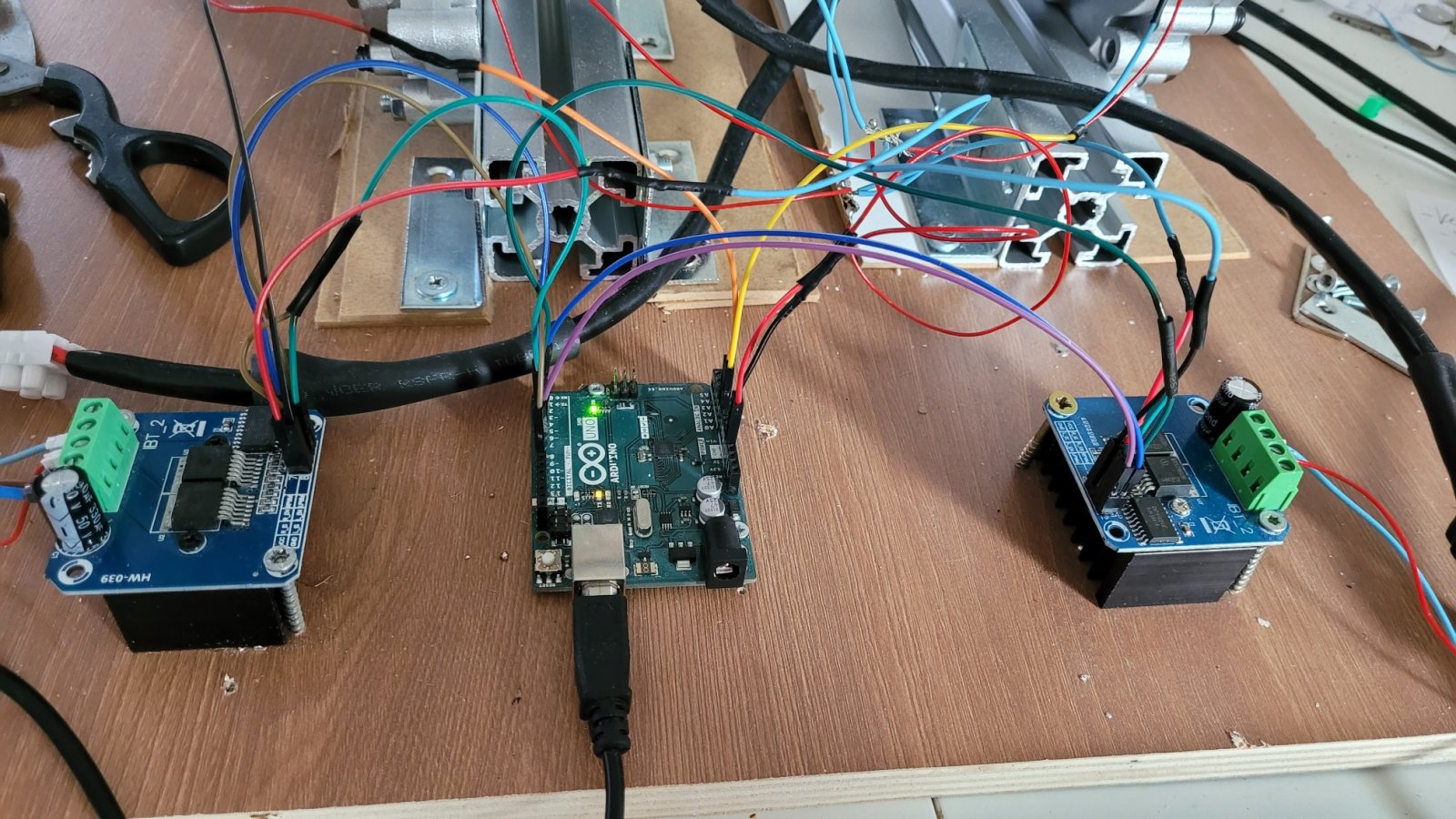

    just finished my solderings of my 2DOF Flight Rig.
    When activating the motor, it begins to spin but i am not able to stop and control the motor.
    Only reacts to "Fpwm" but nothing else.
    Can you please give me a hint to solve the problem?
    Thx

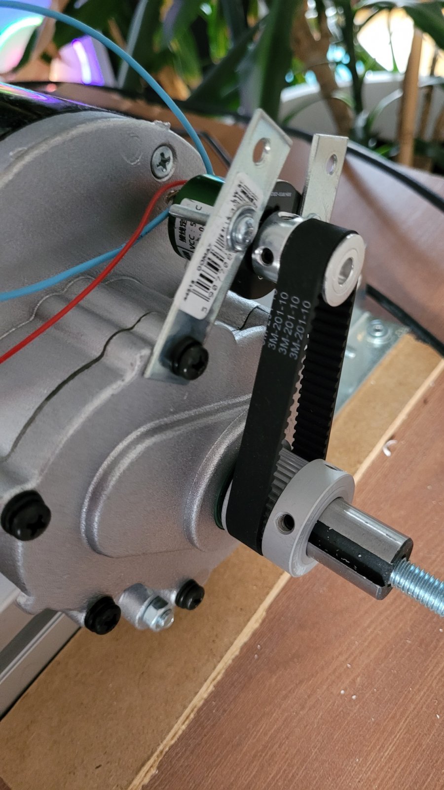

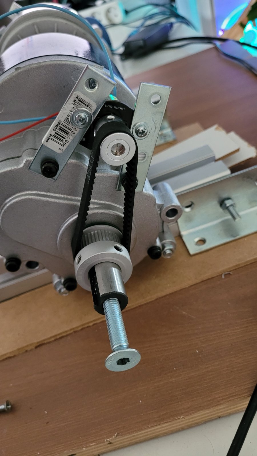

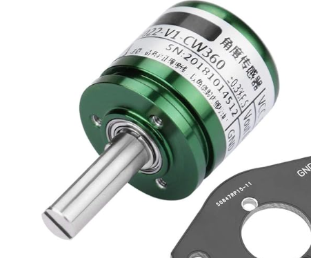

    did u try to swap motor cables (+ & -) it cold be also bad ratio motor to sensor are they 360deg sensors??

    However, the motor still turns as soon as I set it to 30 or 25 kHz. Even if I set the other values as you advised, it has no effect on the motor. Could it be the pots?
    As far as I know, these are 360° sensors. And no, I haven't mixed up +/- yet.
    What do you mean by the motor to sensor ratio?

    If the rig is at its centered position the pot line should be over the middle blue line, are you sure the pots are centered properly.

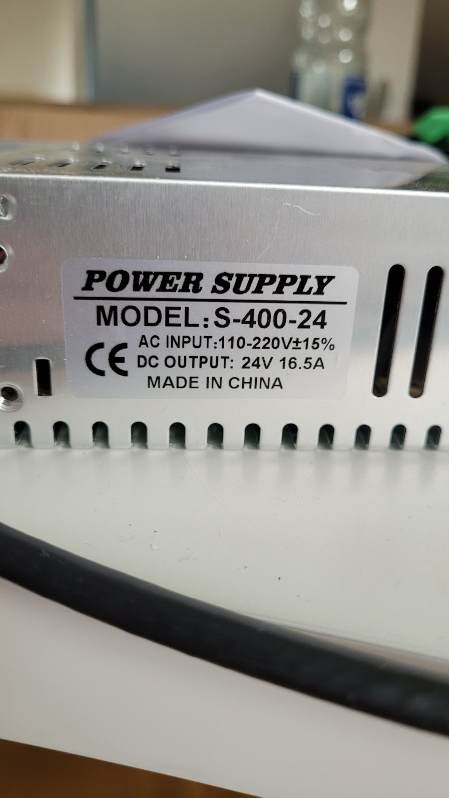

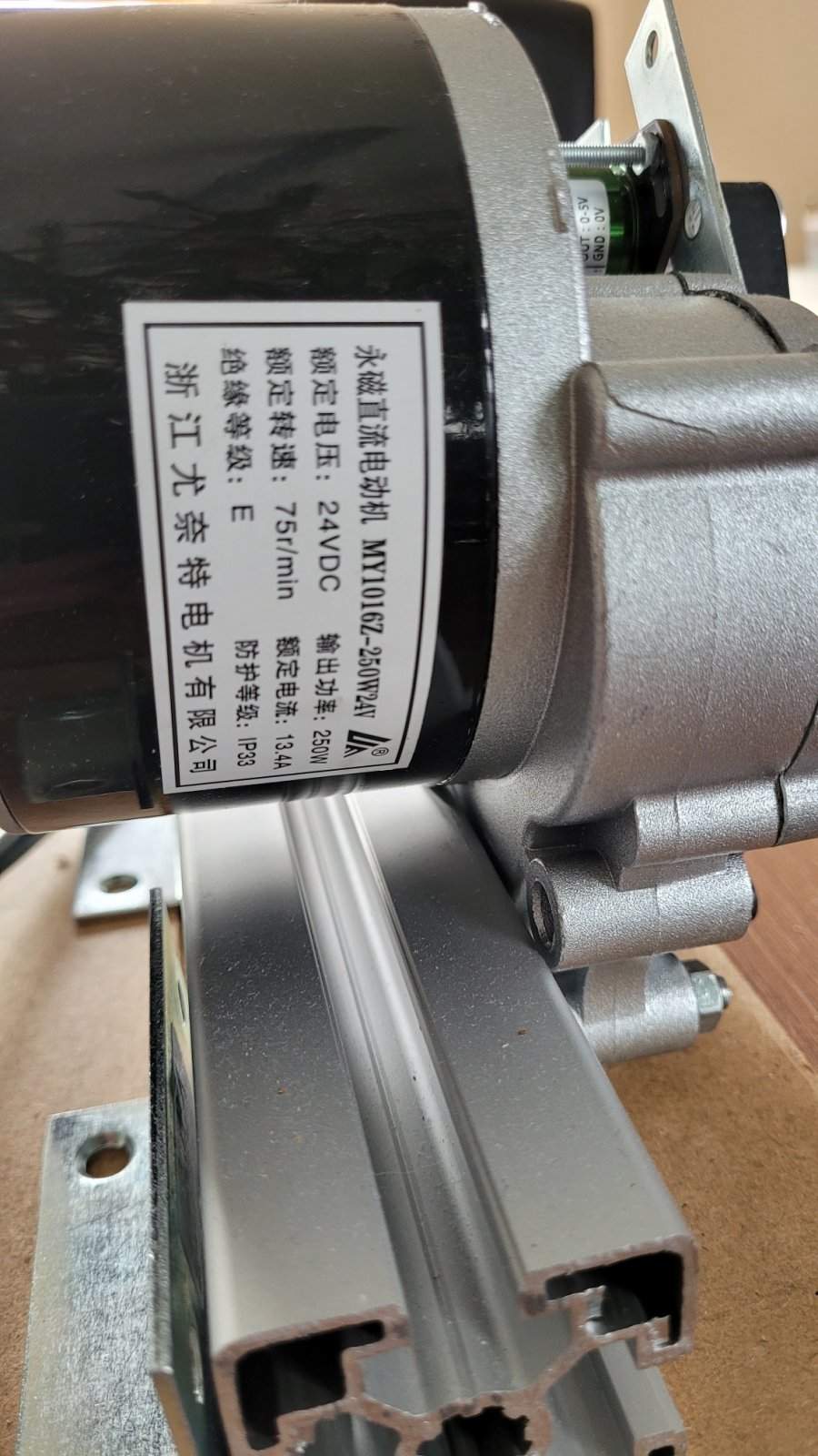

    The other possibility is faulty IBT2s. What voltage PSUs and motors are you using?
  13. floridianer
    floridianer New Member
    Jul 16, 2023
    13
    47Coins
    i think that the pots are centered porperly. i just ordered two new IBT's. They will arrive tomorrow.
    20,975
    147,560Coins
    +10,867 / 54 / -2
    Other members have reported issues running IBT2s at 24v, dropping a couple of volts seems to be more reliable.
