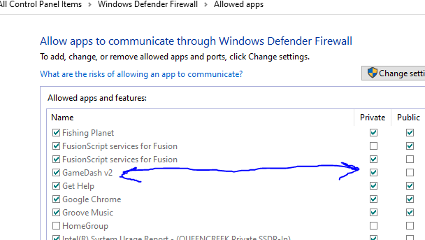

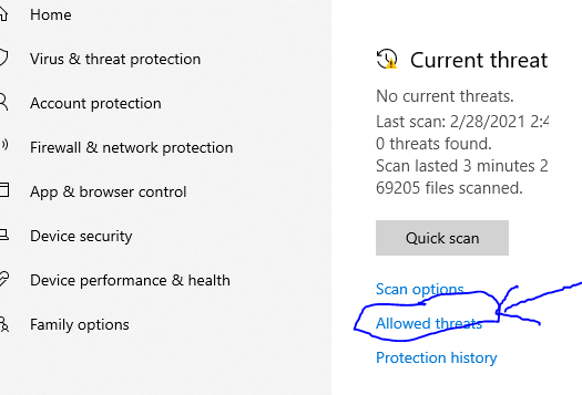

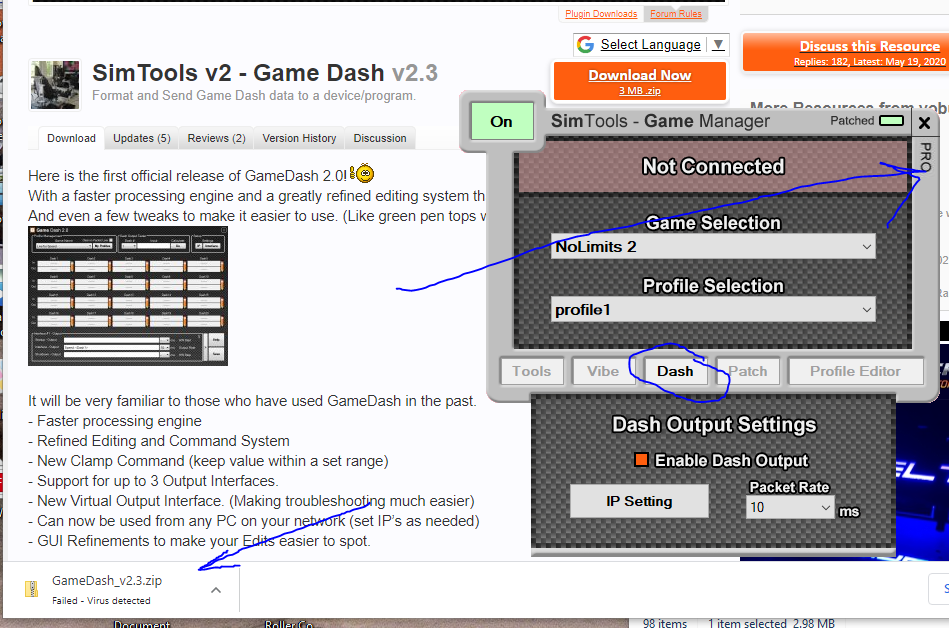

    bought and registered simtools pro
    Im trying to download gamedash so I can use ard MM seaflow fans in game
    Has anyone had this happen
    Im sure its a windows defender thing but not sure how to handle it from here

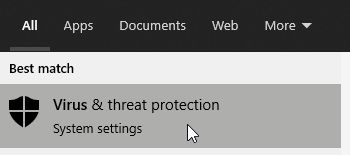

    1. Enter 'virus' into the entry field in the lower left corner of the screen.
    2. You should now see 'Virus & threat protection' listed. Click on this one to open it.

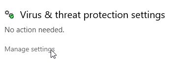

    3. Click on 'Manage settings'.

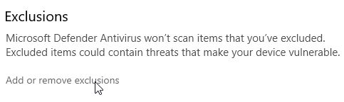

    4. Scroll down a bit and click on 'Add or remove exclusions'.

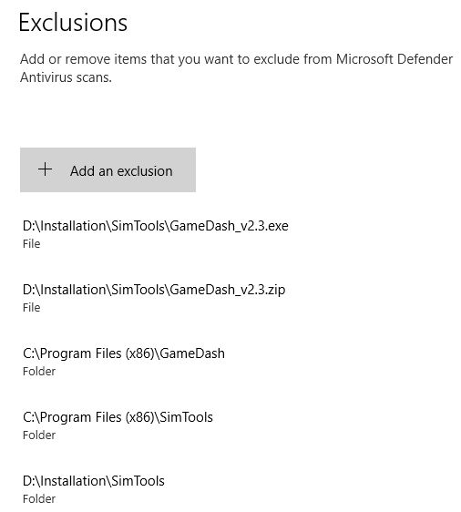

    5. In the screenshot below you see the exclusions I had to add. It took me some time to determine them.
    Note that the folder 'D:\Installation\SimTools' is the foler into which I downloaded the GameDash zip file.
    You see that it was not enough to add this folder to the white list, but also the zip file, the exe file, and the destination folder into which Gane Dash is being installed.
    If this still does not work for you, you may need to add further folders.
    Good luck. And be assured that Game Dash is worth the effort. :)
