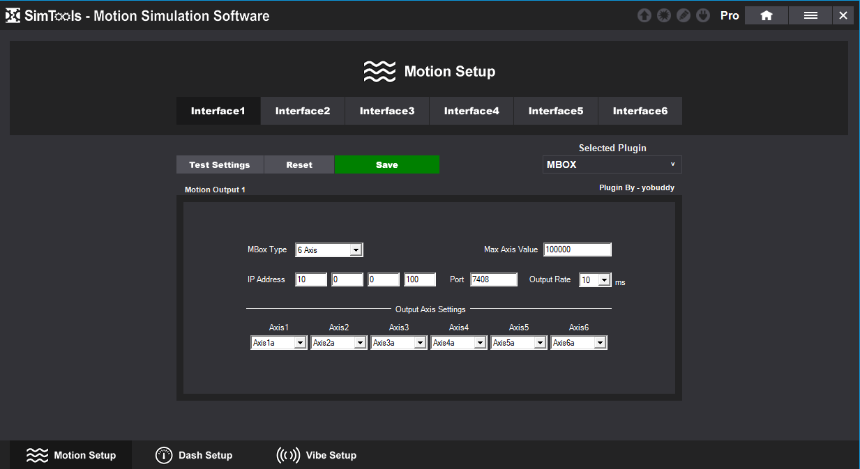

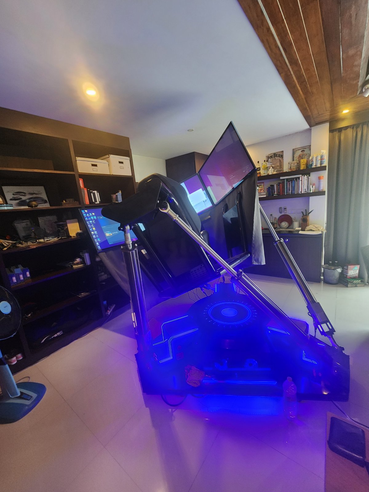

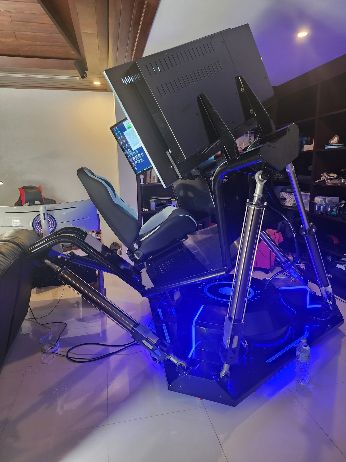

    I am too old to build a simulator so I bought a big 6dof one from a Chinese Alibaba firm called LeaderDream that is actually made for amusement halls.
    It came with its own proprietary menu system and a set of racing games with a very good overall quality and performance. I was very impressed with the whole purchase and delivery process of this 450kg package too.

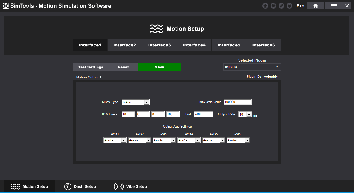

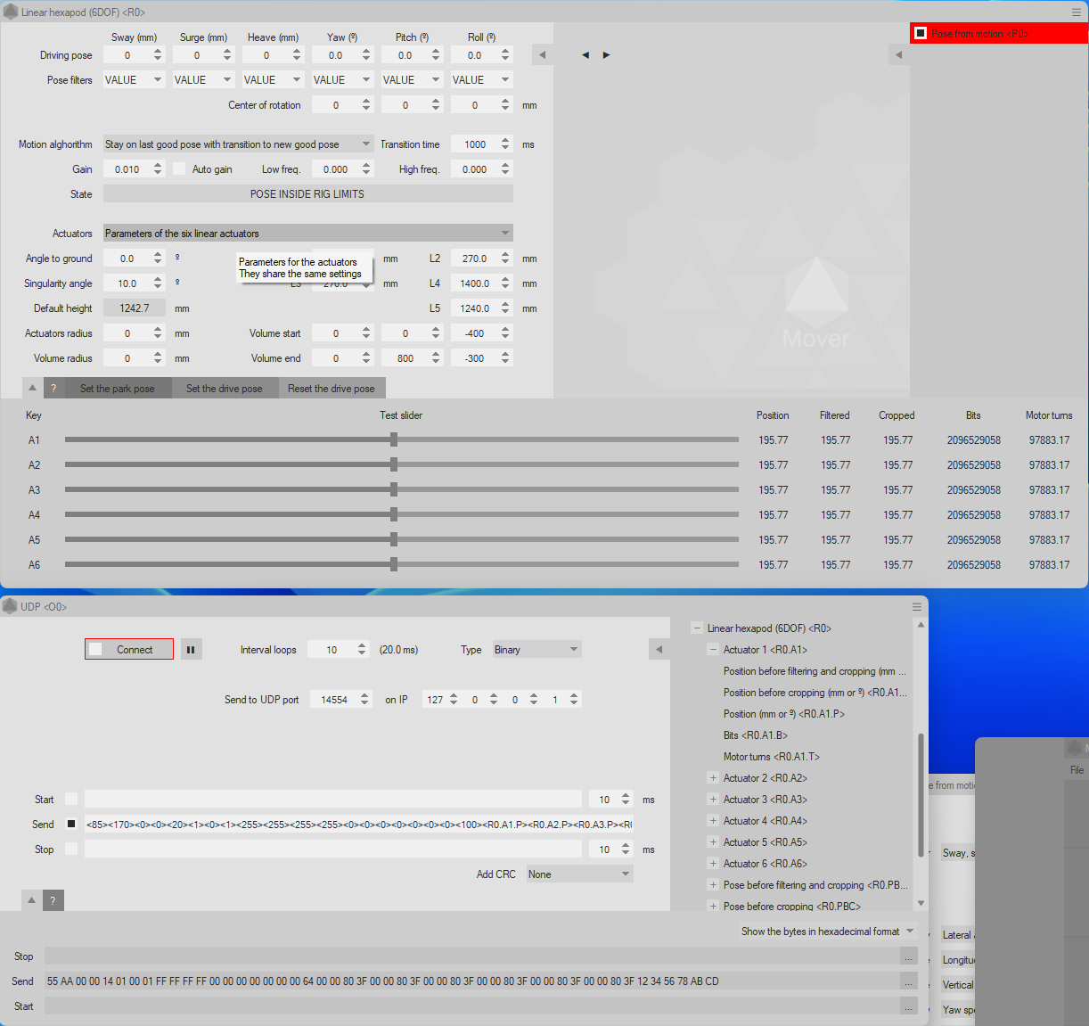

    I did not know much (and still don't) about simulators but after digging around in the internet I found out that this machine actually works pretty well with Simtools V3 so I bought a pro license.
    My first problem with SimTools V3 was that it does not save parameters for the MBOX interface if you select [6 Axis]. So now I have to fill these parameters in every time after a PC reboot.
    Did anybody of you know about this?

    Can you please share sequence pictures of your setting process that fails.
    Hopefully @yobuddy can chime in when he has a spare moment and consider what is going on with v3 in your specific circumstances.

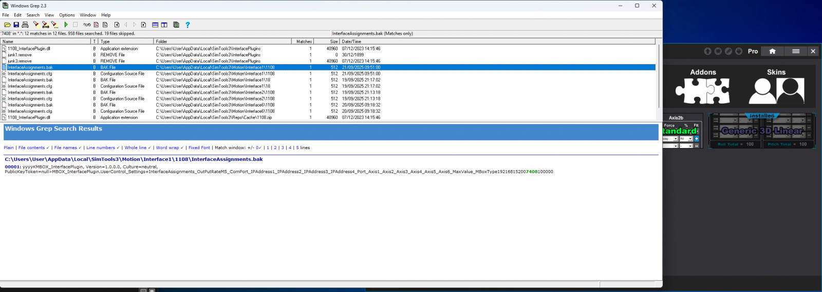

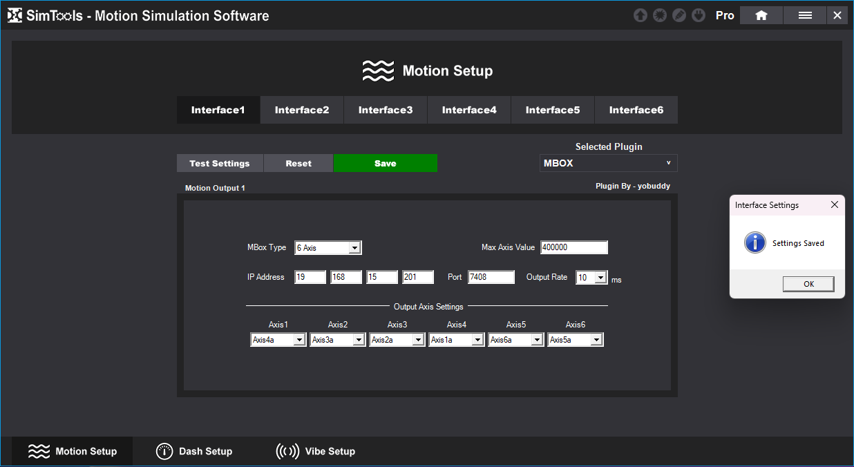

    I noticed that the parameters are actually saved as you can see in the last picture where I scanned for the port number as text in files from the AppData\Local\SimTools3 files.
    It does save the parameters if you leave the [MBox Type] to [3 Axis] but NOT when you use [6 Axis] instead.
